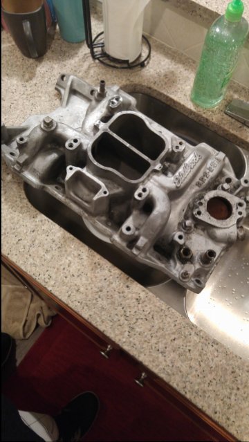

Well I've cleaned up the intake manifold. Its a Edelbrock sp2p318. From what I have found they are an older design directed more towards mpg's and low end torque. Talks to a machine shop. They want 350 to completely re do the heads. Might have them do a 3 angle for an extra 30 bucks. I am going to use the demon 625. Lets say I do have the cam you listed. Would it be a good match with this intake manifold And heads?
Doesn't sound outrageous for the head work. For $30, I'd do the 3 angle job, cheap improvement. I was told to always do that when getting heads done.
Those are some sharp corners in those runners! It is an older intake and would be the most restrictive part of your equation. You could always swaps to a newer edelbrock intake later on if this one doesn't work. I never played with small blocks, the one I had was a hell of a strong running Gopher Motor (local company) rebuild that actually got built right. So I'm no help in saying if the cam is too much or not. I'd try it since you have it and the engine it came out of was basically stock. Worse thing that can happen is you have to tear into it again, and learn something in the process.
Me personally , I don't like Crane cams in a Mopar . But think about it . You have it , It's definitely better then the stock one you have now ( By the way , check that when you pull it ) . Plus you have the matching lifters you need to go with it and your on a tight budget . As far as the intake ? Like what Mob just said . Try it and if you come across a good deal on a better one later on that you want to try , then go for it and if you like that one better then sell this one . Win , Win .

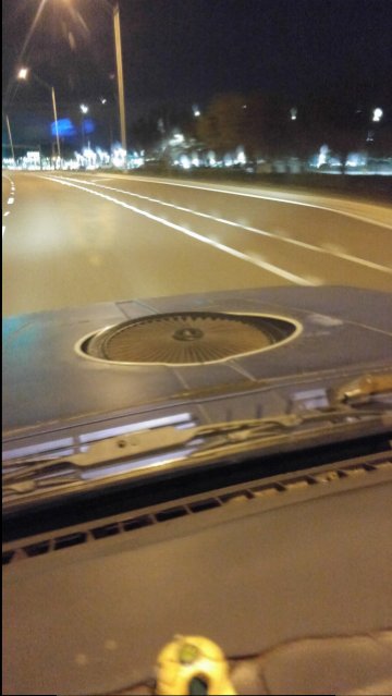

Agreed guys. But before I do anything else I have to raise some extra funds for a cowl hood. Found a guy that is going to sell me his 3" cowl xj hood for 200 bucks plus I provide a stock hood for him. Its a hell of a deal. They don't make jeep xj cowl hoods anymore. And when they did they were over 500 bucks. I need it badddd lol

Hahahahaha exactly. But I really do. When it rains I don't really drive it because the air cleaner is exposed. And I did my first burnout in the jeep yesterday. Man! What a difference in power! Straight roasted 1 of the tires hahahaha (yes only 1) with very little effort. Can't wait to make some real power. Welding the rear soon. I've got a burnout contest coming up
