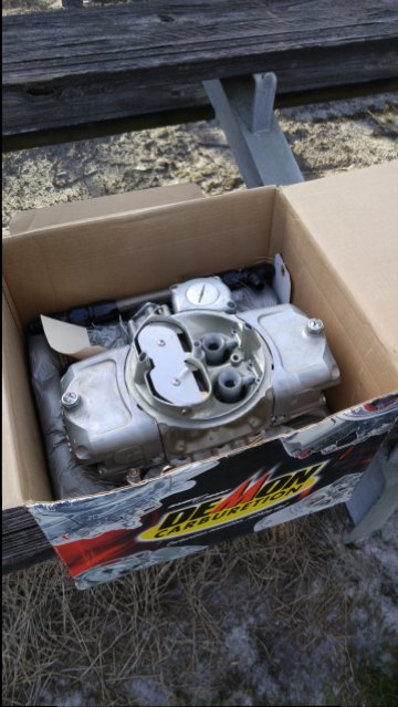

Well I went to a fun Ford weekend on Saturday. Bought a demon 625cfm elec choke road demon Brand new with matching dual feed line. What do you guys think of this carb? No, I didn't pay retail lol
Now you just need an intake and you'll be cruising in no time . :cool: Before you start tearing into anything though , you might want to see if you need any sort of throttle cable & kick down adapter .

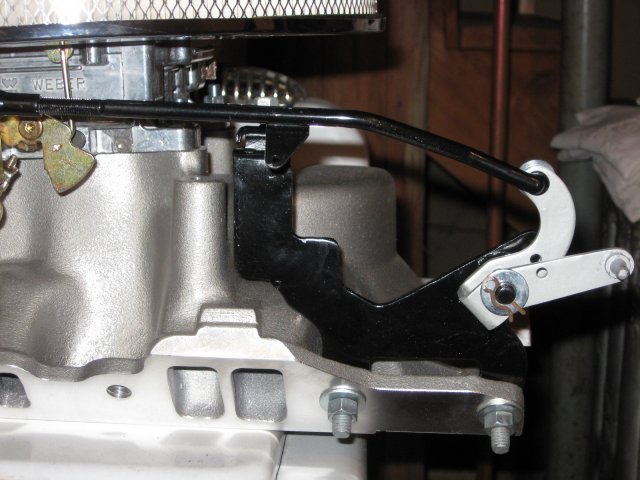

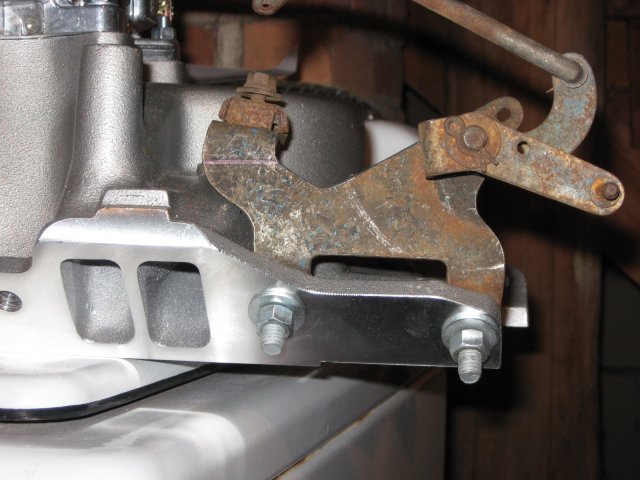

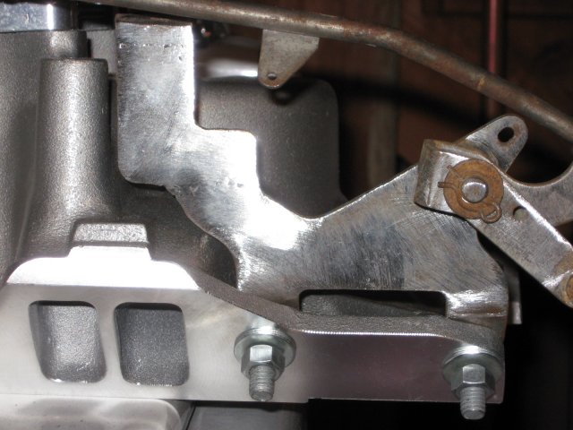

To get back to your throttle cable question . A lot of how you do it , how easy it's going to be and how well it works afterword's is going to depend on what style kick down rod you have . This is the last set up I modified when I swapped from a 2 bbl. to a 4bbl. . Hope the before and after pictures help .
To get back to your throttle cable question . A lot of how you do it , how easy it's going to be and how well it works afterword's is going to depend on what style kick down rod you have . This is the last set up I modified when I swapped from a 2 bbl. to a 4bbl. . Hope the before and after pictures help .View attachment 6412 View attachment 6413 View attachment 6414
What the hell is with that paint? Just kidding, I just never touch it after I modify it!
What intake is that bear?
It was a dual plain I got for the other Warlock I had ( Big Red ) . I can't remember what brand it was but it worked real good on that truck .
