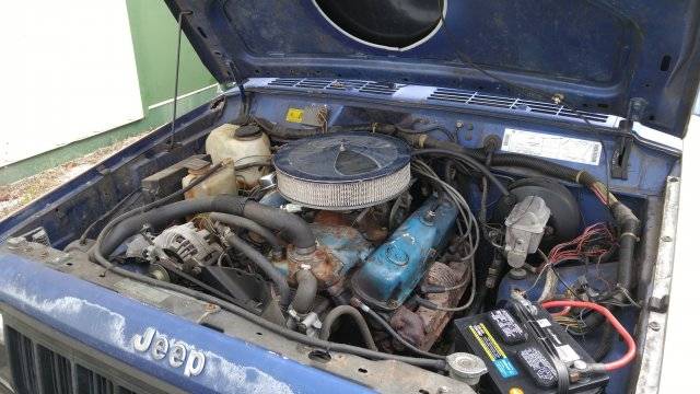

Hi guys, new to the forum. So I have recently purchased a new project. Previous owner swapped in a 5.9 2bbl with a 727 trans. Seems to run ok. Needs an intake manifold gasket but runs as is. Any useful info on these Motors would be great. I'm a jeeper so to find a xj with a v8 Was awesome. The swap Was done right. Custom driveshaft, trans, motor mounts. Just needs some tlc. Been sitting for a year. Any tips and tricks? If I'm going to replace the intake manifold gaskets I would like to swap the manifold for aftermarket 4bbl setup. And how do I find out what size ports I have lol? Thanks guys

Thanks. Yeah she moves pretty good. Still working the old gas out. And I need to check timing. No oil is leaking that I can see. Its sucking in air near the front passenger side of the manifold. When I called the parts store they asked if I have the large bore or small bore intake, no idea what I have. And the motor and trans are out of a 77 d100
Ok , Where it's a 77 motor then it's a hydraulic flat tappet cam motor . My first guess would be it's a small port head ( 7/8" x 2" ) where it's a 2 bbl. motor . The large port is 1"x 2 3/16" . What I'd do if I wasn't a 100 % sure and the gasket kit's should only be about $15/$20 is order both and return the set I don't need . Don't forget , you might have to take one of the valve covers off as well , to get the intake off . So you might need a set of gaskets for them too .

Yeah , nine times out of ten . It look's like you can just pull the intake alone . But then it ends up hitting the edge of the valve cover . As far as the 360 go's ? It's a darn good motor . You should be able to find parts for it both new and used and you can go a couple of deferent way's . As to how far you want to go depends more on your budget and what parts you use then anything else . The weakest link I can see with your combo of the top of my head ( And if you know jeeps then you probably already have this figured out ) is the rear end . Your going to need to get that extra power to the ground and I doubt the stock one will hold up . I'm not even sure how's it's going to hold up to what you have in it now .
