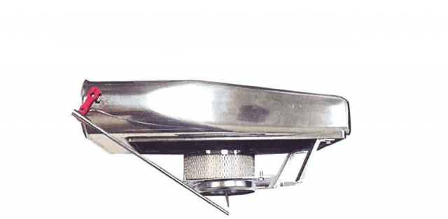

been trying to figure out how to put a big enough cleaner in this for the 68 Charger RT. Need 700 cfm but will not get it out of that little thing. Talked to someone who sucked a bird down his supercharge with no cleaners. He found a filter plug for the end. I have had no such luck with this one.

View attachment 6623been trying to figure out how to put a big enough cleaner in this for the 68 Charger RT. Need 700 cfm but will not get it out of that little thing. Talked to someone who sucked a bird down his supercharge with no cleaners. He found a filter plug for the end. I have had no such luck with this one.
I messed around with a bunch of different thing's with the Gasser I ran . Is the bottom of that open on either side of the air filter base ?
Have no base at this time. Have been thinking of mounting it some how to a factory air cleaner. Something like the shaker scoop.
What , there was no base plate that fit's the bottom of that to the top of the carb ?
There is one available. But I did not get one with the scoop. Am planing on using it on top of a TQ. The scoop base opening is 15.75" x 5.25" which made the original base plate worthless when sitting on top the TQ.
Maybe yours is different then the one had bought for my Charger . Because I did buy one like yours as well , before the gasser scoop . I didn't use it because I didn't like the way it looked on the tunnel ram . But the base I got with it was more then tall enough to clear pretty much any 4 bbl. carbs and gave a mounting point from carbs to the housing . When it came to the air filter's them selves . Well that was always another story whether it was the scoop your using or the gasser style that I ended up sticking with . The round paper ones like in your picture , I hated . Especially in my case because the air had to go thru the front filter to get to the second filter . I had tried a "few" different things . Shorter filters ( Nope , not enough air flow for my HP ) , Made up a flat foam filter sandwiched between screens (Not to bad , but hope your carb never spits a flame) and a few other things that I can't think of right now . ........ To DeepJeep , Sorry if it looks like where highjacking your thread with this . It's not meant too .
