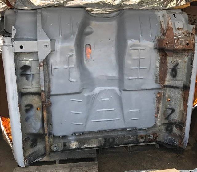

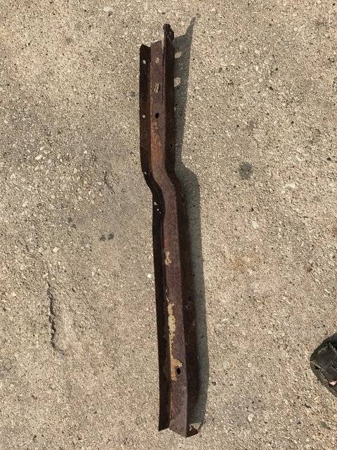

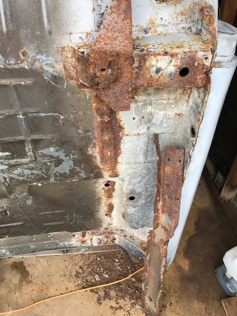

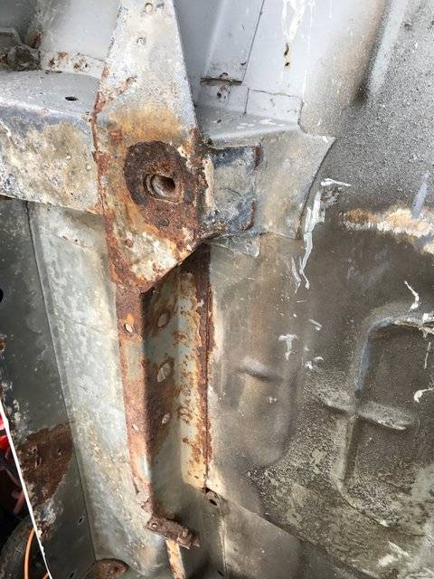

It's nice to start working on this again. This summer is about fixing the cab bottom and getting it on the frame. So far I've got that cab support channel removed from the drivers side. I considered replacing the front cab support but I'd like to try to avoid that. I'm also hoping that after sandblasting the bottom I can also skip replacing the passenger side channel.

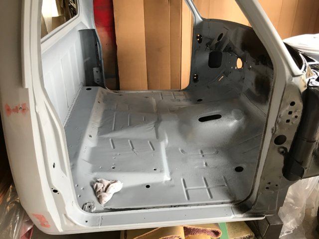

Picked up one of those cheap Harbor Freight gravity feed sandblasters and finally got started on my cab. Got one corner done along with the middle of the cab which was nice and clean. I plan on doing this in small sections. I was planning on taking more time to do the center sections, but after I got all the gunk off it was nice and clean with no rust.

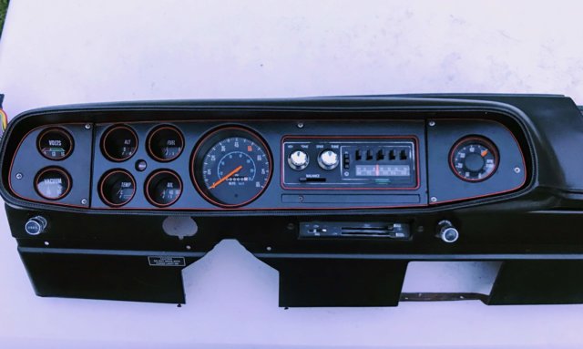

Got my dashboard all done. As I mentioned, we're going with a non-traditional paint scheme, mostly because of all the non-original sheet metal (specifically the '86 cab). We're going with satin black and red accents (decals, etc).
So I'm trying to re-do the dash to match the original as best I could, with not much luck on that chrome, and one of my sons suggested I go black with red around the bezels.
I seriously had NO IDEA it would look as good as it does. I used (satin or gloss, not sure) black with matte clear. Cleaned up the guages the best I could, touched up the needles and put in my brand new speedo.

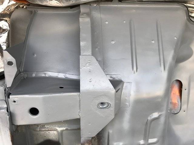

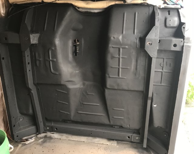

Major milestone completed...the bottom of the cab is done and undercoated!
I had taken in the crusty cab rail to a metal shop to do some metalwork on it...but they misplaced it after it was repaired. Luckily, they made a blueprint of it and just made me a new one and it fit pretty good. I only had a few small spots to patch on the floor where the rail used to be. First time welder here...need more practice...but it worked out nevertheless.
Next step is to get the cab on the frame, get everything hooked up and start the engine up again.

that dash is sweet!!! wish Dodge had stayed with that design a few more years.

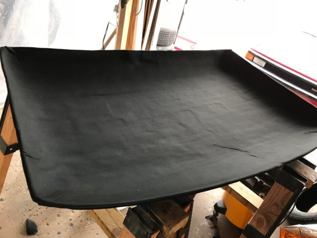

  • Cleaned up and refoamed the headliner

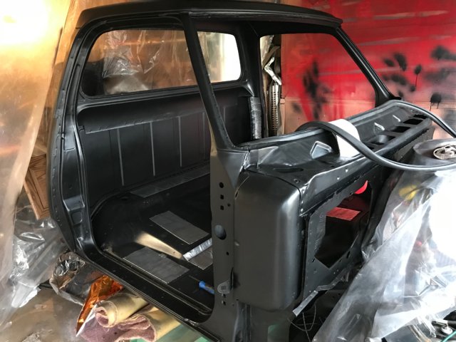

As you may recall, I'm going a bit off the restoration path (mostly because of the newer cab) and going for a different look; satin black with red decals. And since I'm going down that route, I figured I'd go ahead and put in the trim as well.
This headliner was a mess and the old stuff was all crumbled and nasty and essentially was down to the fiberglass. I sprayed some adhesive and put down a layer of laminate flooring underlayment before attaching the headliner (I got from Jo-Anns Fabric). My first try and once it's on, it's on so there are imperfections...also the headliner pad itself was a little busted up in some areas.

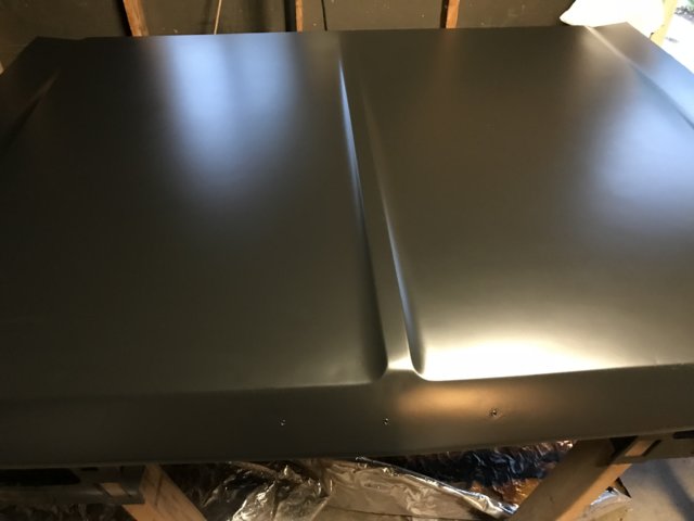

Rustoleum Satin Black enamel, sprayed on with thinner (about 60/40) with some wet sanding initially to get rid of some drips because I've never sprayed before. I do plan to put a coat of Matte Clear on but that won't be until a final coat when I have the doors and fenders on so my final coat is consistent.

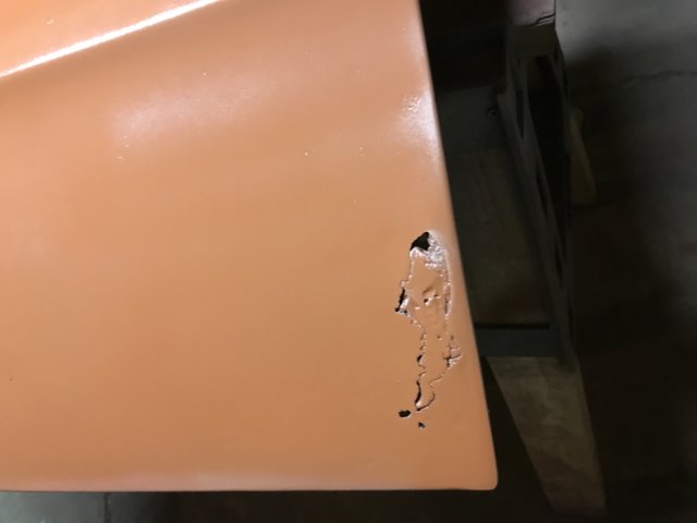

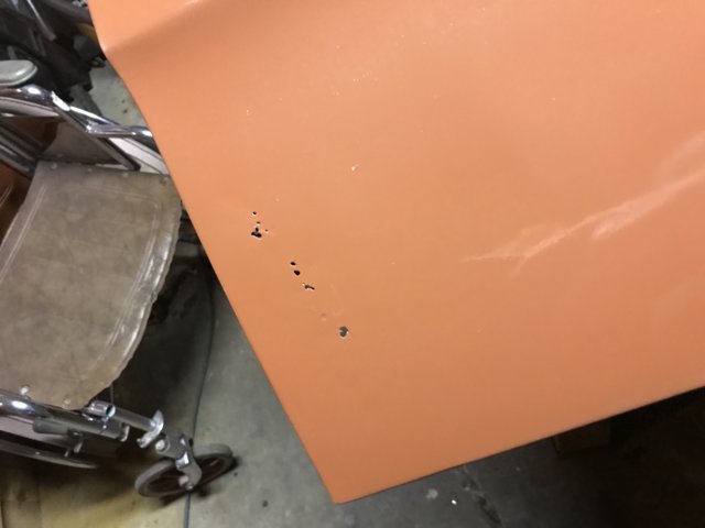

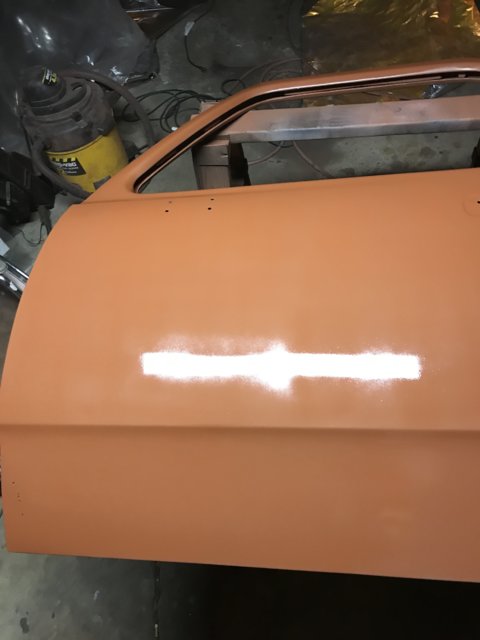

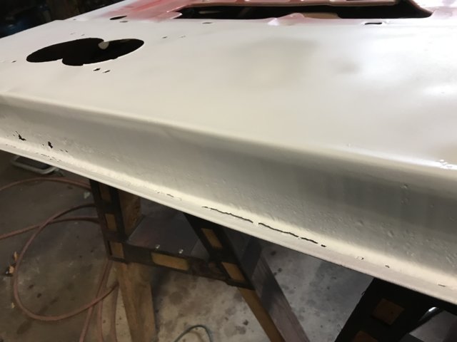

Decided to hammer out more painting instead of doing more interior. I’ll finish the bed next year but I’m hoping I can at least drive this to a storage unit this fall.
There’s some filling I need to do on one of the doors, but I’m not going to sweat it too much. Some of the bodywork was started by someone else so I’ll finish that before i shoot paint on.
