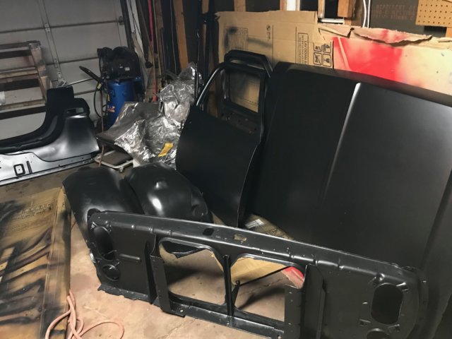

    Yep, it was pretty pitted in some spots. I started at 120 grit then went to 220 and 400. I was surprised how well it came out.
    It’s also one of the original pieces of the original truck along with the doors and tailgate.

      I was surprised also. The pictures looked like it had gone threw a hail storm. Then the painted picture.

      Honestly, I thought I'd have to put a ton of filler on to get rid of the pitting, but I didn't actually have to put any on. Maybe if I was doing a gloss coat I'd have had to, but this Satin Black is pretty forgiving.

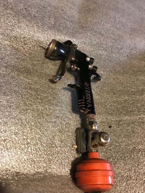

        What type spray gun?

        I'm borrowing a Tekna gun. This thing is sweet but apparently about $700. I've never sprayed before so I can't compare other guns, but I think this one has spoiled me.

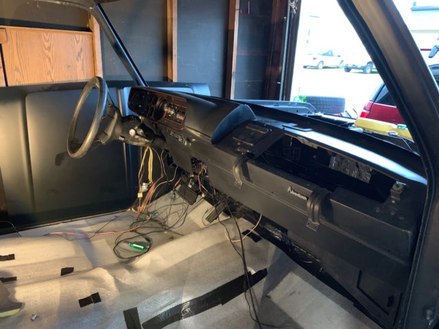

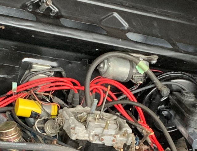

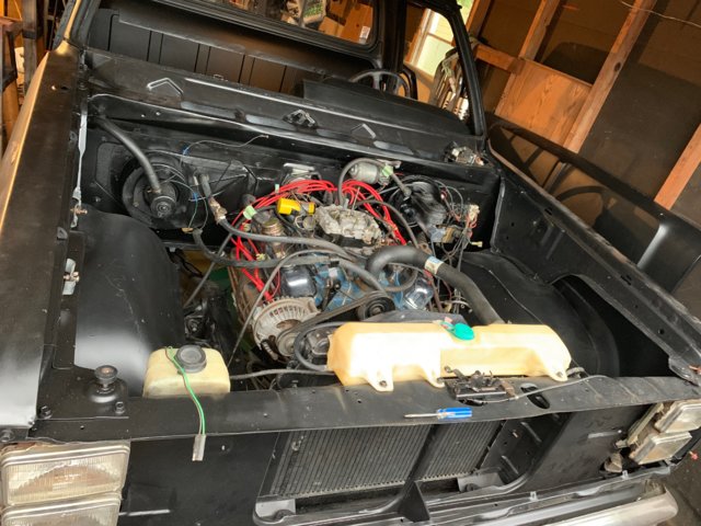

                  Progress update
                  1. Cab mounts
                  2. Rear sliding window
                  3. Broke front windshield putting it in
                  4. Picked up front windshield at junkyard
                  5. Wait to have glass company put windshield in
                  6. Dash/cab electrical wired up
                  7. Core support mounted
                  8. Fenders; inner and outer mounted
                  9. Core support loosened because I needed some play in it to mount the fenders
                  10. Engine components and engine compartment wiring completed
                  11. Hole cut into firewall for harness connector. Remember, this is an '86 cab with '79 components
                  12. Steering wheel mounted
                  13. Accelerator/brakes/parking brakes/hood release mounted. Some modifications in firewall will be needed for throttle cable and hood release
                  14. Wiper arms and motor installed
                  15. Wiper motor installed with one from older cab out of junkyard...different bolt pattern for 'slimmer' design
                  16. Headlamps/turn signals
                  17. Heater box and connections...hmmm, no hole for the blower intake that used to connect to the cowl.

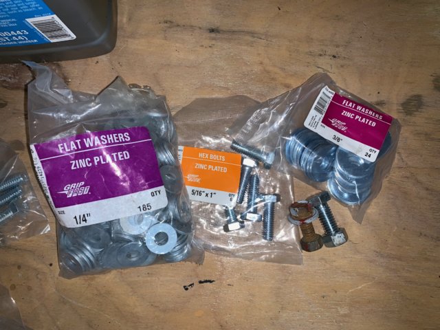

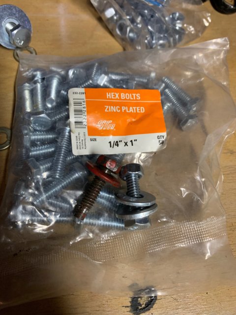

                  I also picked up some new bolts for the majority of the body connections since alot of mine were getting rusty. I've attached the pics of the bolts I got with what they replaced.
