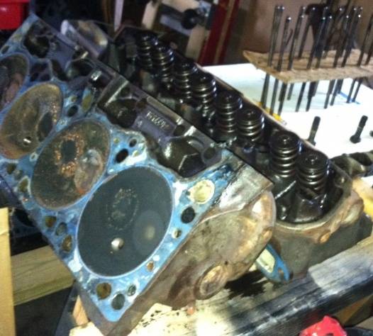

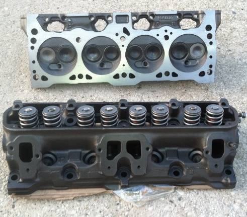

Just got my heads done. I was going to clean these up and do a valve job myself, but when I took them in to have them resurfaced, they quoted me only $230 to also have them cleaned, magnufluxed as well as a valve job I decided I couldn't pass that up (they also removed a broken stud).
Not a bad score and at least you know there shouldn't be any issues with the heads now . :thumb:

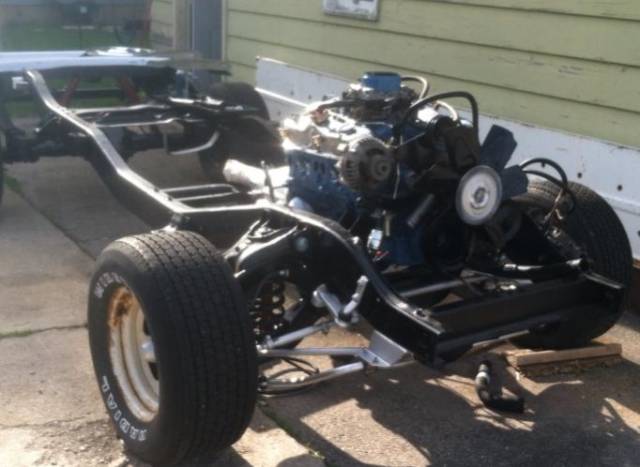

Should have my engine all together this Easter weekend. Hopefully I'll get my engine back on the frame next weekend and my new exhaust will be in so I can get it fired up. I also just ordered a truckload of stuff from DodgeConnection to finish this off once the paint is done. Still shooting for mid-August completion.
Before
After

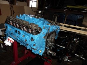

Got some more of the engine put together. That phosphoric acid (CLR) works wonders getting the rust off those brackets and pullys. Just let the stuff soak for an hour and no sanding needed.
I hope to have the engine running in the next couple weeks.

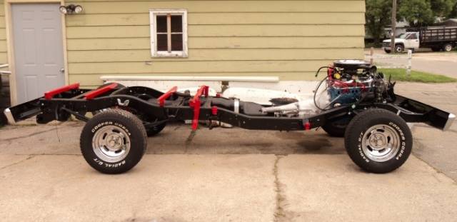

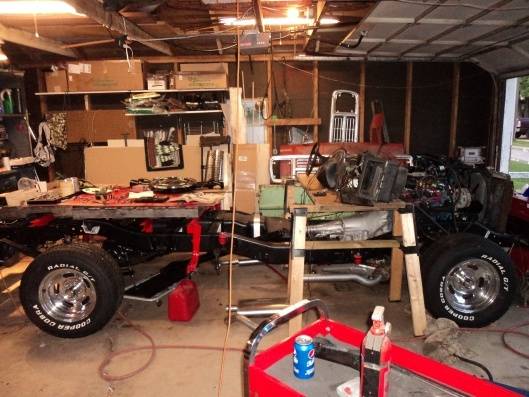

Most of the lines and hoses are attached. Currently sorting out the wiring. Got the new fuel sending unit on the tank (had an issue after I had to drill out the original screws). Also got my new Cooper Cobra's on the original, cleaned-up rims. The bumpers aren't original, but part of the $1500 purchase price.
Look'in gooood "Jumbreit" ! It was hard for me to see but those bumpers look like the correct one's for your truck ? .... Do you have the fresh air tubes to go with the factory air cleaner ?
Bumpers were pretty much a match for the ones I scrapped, hard to tell since those were pretty bent up. And yep, I've got the hoses, plus one or two extras. I have to say even though this truck was pretty rough, I really did get alot for my $$. Did I mention he included two grills?
And the funny thing about the gas tank was he had the original replaced because it leaked. The one that was on was really badly cracked and the one I fixed, was the original that only had a leak in the filler gasket. Thank God he kept that too.

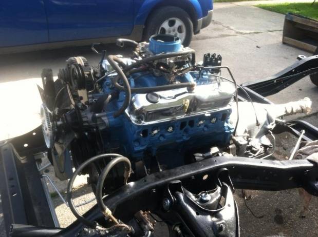

Got the new exhaust on, the engine running and wired up all the electrical to work out any bugs while I'm waiting for the painter to finish. 035.jpg

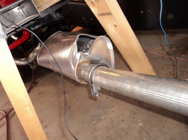

Also blew up a muffler...
[video=youtube_share;M-A6IbLC2Wc]http://youtu.be/M-A6IbLC2Wc?list=UU0hMlwLbauSBhbNJppitENw[/video]
Sounds good ! :thumb: There's nothing like hearing that pride and joy start for the first time after all the work you've done , isn't there ? And how did we blow up a brand new muffler ? Maybe a little to much raw fuel ? Hmmm ? lol
Yep, it was a very good day, wondering if it'd run or not after the rebuild was pretty scary. Took the radiator in after that to get it patched and now I'm sorting out the wiring, making sure everything works now so I don't have to dig around and under everything later.

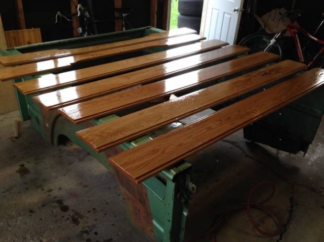

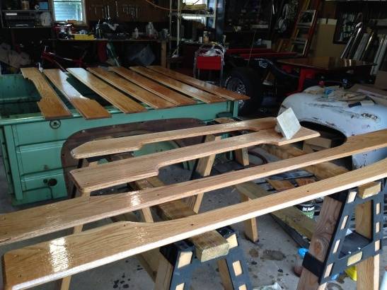

In the middle of varnishing my bed wood. Using Old Masters Marine Spar. I plan on doing 7 or 8 coats, sanding between each coat with 220 grit.
WOW ! That wood is coming out great ! Is that the original wood off the truck ? Are you going to swap to a finer grit for the last couple of coats ?
Nope, not original wood, it's Red Oak from DodgeConnection (http://www.dodgeconnection.com/page/page/2822475.htm). I have some of the original side wood, but not all of it, and the original bed wood was all rotted out. Yeah, I plan on going back over it with a finer grit once they sit for a bit. But I've never done this before so I'm a bit worried about messing it up.
