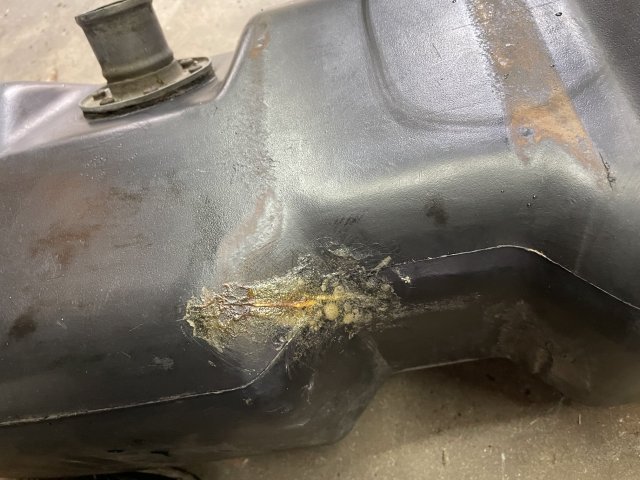

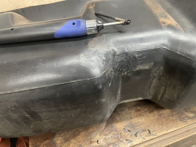

That's how they're made, melting plastic as it rotates. I used to make Hummer fuel tanks and we would fix them the same way when they had pinholes, just melt some into the hole until it's good.Only why I have gotten polypropylene to weld and hold was adding more of the same material. Simply melt it in.
Don’t use a torch, be fixing a bigger holeThat's how they're made, melting plastic as it rotates. I used to make Hummer fuel tanks and we would fix them the same way when they had pinholes, just melt some into the hole until it's good.
Bigger hole would be the least of worries.Don’t use a torch, be fixing a bigger hole
That’s what I was implying lolBigger hole would be the least of worries.
This is a fuel tank? Boom!
