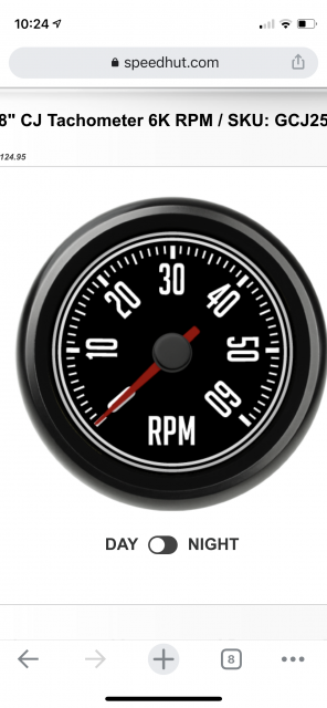

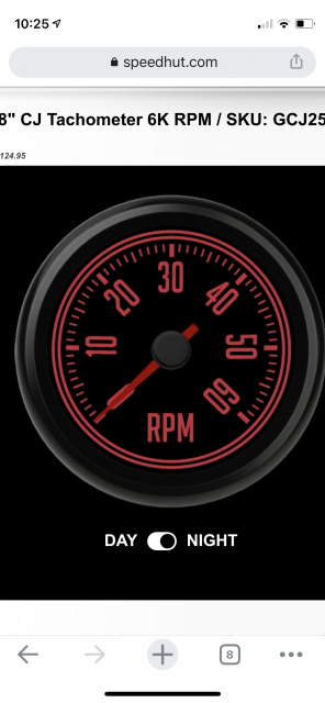

A few of the goodies I can’t wait to get on this summer. The actual color is more of a bright red than in the proof. I also got my power steering brace.

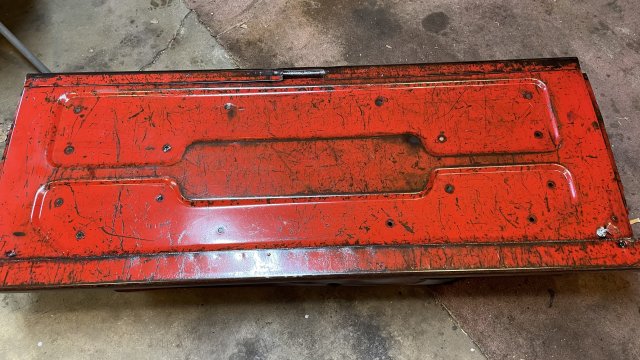

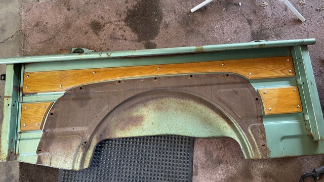

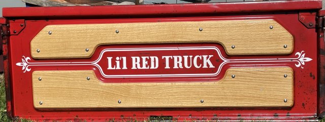

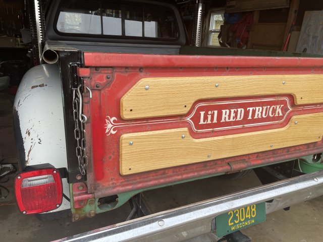

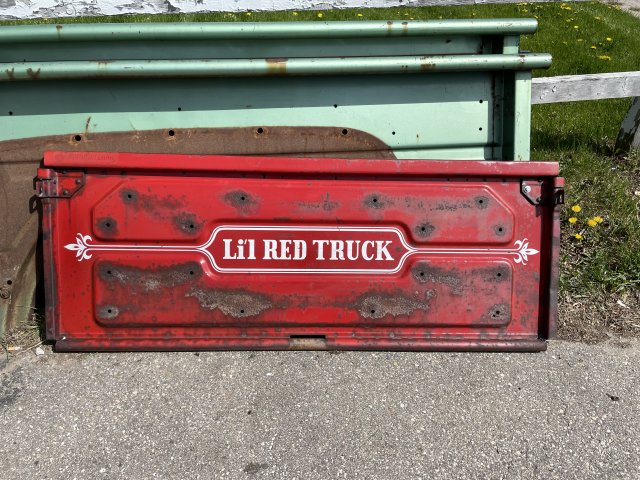

Started on the bed this weekend. I’m keeping the tailgate as is but cleaner. Was actually able to get the red spray paint stripped off (turpentine then brake clean). The brake clean also removed the remaining gold off the decal. I did some very minor metal work and so far have a coat of semi-gloss clear on the back.
Also pulled the chains off my extra bed and cleaned those up really (and clear coated)

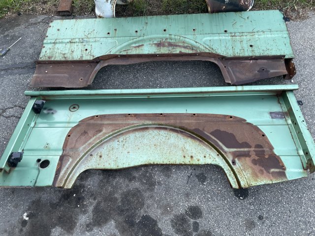

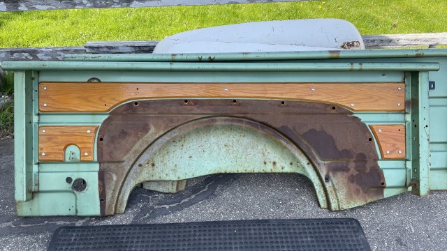

The rust on the lower part behind the wood is pretty bad but didn’t rust through
The white decals (gold has all worn off) really pop.

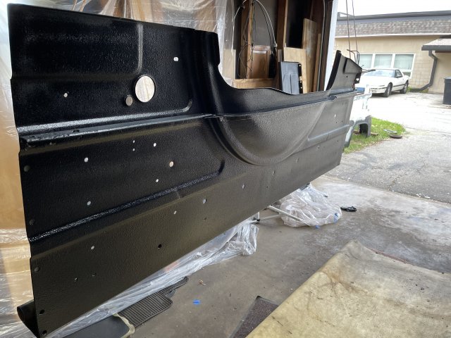

I’m going to do Bedliner on the inside panels of the bed but first had to drill in the remaining holes for the stack brackets and the side wood panels.
Probably could have gone 1/4” to 1/2” higher on the top panel but most of the pics I saw online it’s pretty close to the fender.

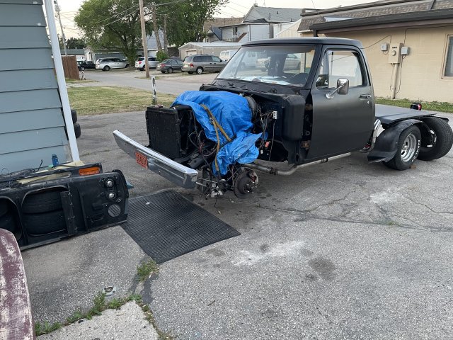

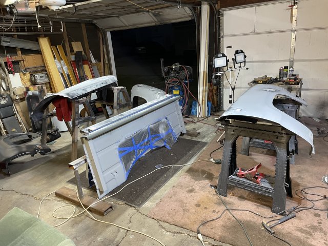

Pulled the front end apart so I could do a few final things before I start prepping it to paint. Goal is a big car show in town on July 25th so I want to have it done by then...before it’s 10 year anniversary

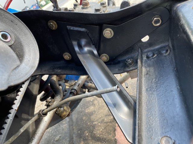

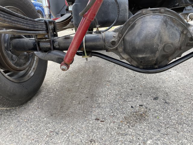

So glad I finally decided to put a power steering brace on! It was really easy to do
I also went ahead and installed my rear sway bar I bought 9 years ago.

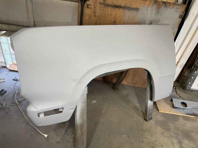

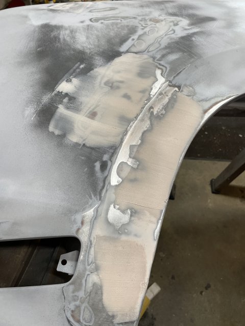

It’s been a really long time since I’ve done bodywork...I think it was on my ‘72 Duster in high school. But I got myself a set of hammers & dollys to work a few of the dents out
The front driver side fender is probably the worst with a few poorly hammered dents. I did about 3 coats of filler primer (from a gun) and just focused on the obvious stuff
Again, I’m no pro and this isnt a show truck, but it is fun and I’ll find out if it’s satisfying after I see the results.

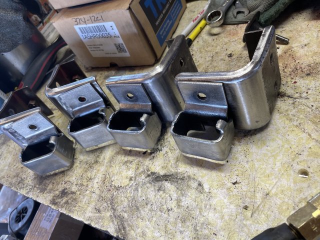

I was sanding these stack mounts down and decided I like the bare metal look so I did a bunch of coats of s

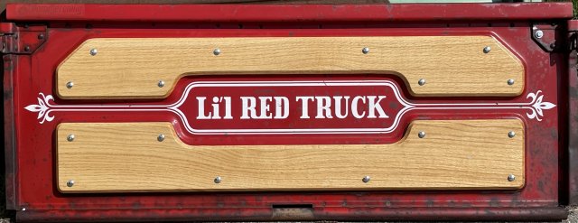

Here’s the final results on the tailgate. Also has a few coats of semi gloss clear. Should look cool on the black truck.

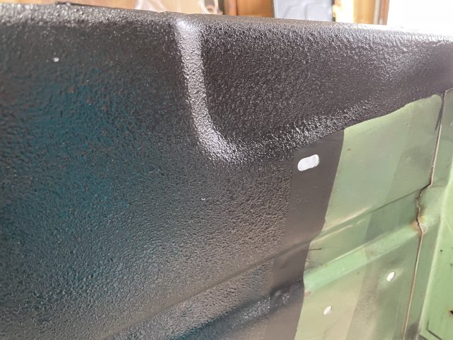

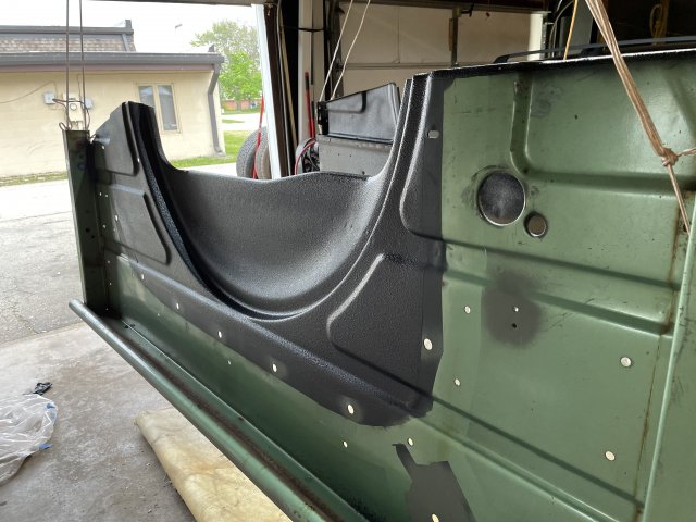

The Raptor Liner bed liner kit was great! I also got the gun they sell and it went on really nice. Hides a multitude of imperfections as well. The inside of the bed was pretty beat up.
Looks like you're doing a great job! anxious to see the results! The PO of mine put bedliner inside my utilinr, and it does hide some of the imperfections. Doesn't last long on the floor when you haul some gravel.
