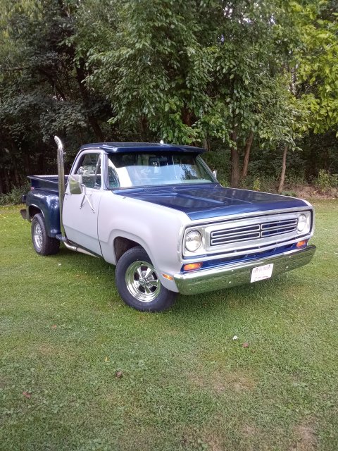

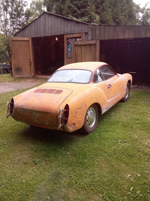

good to hear your getting things sorted out. I've got all the sheet metal rounded up to swap mine over to an early '70s, and got a set of stacks yesterday. As soon as I get my wife's Karma Ghia painted I'm tearing into the truck. Even picked up a rear bumper from a Warlock, and fabbed the brackets. Looks way better than the big ol step bumper.

well this was a 20th wedding anniversary for her...had crappy paint on it then, and we're closing n on our 31st...my '69 road runner took priority. I let it go a few weeks ago, and I really want to tear into the truck.,..but figured I better get her some nice paint first.

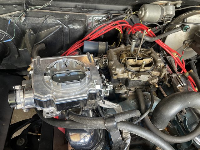

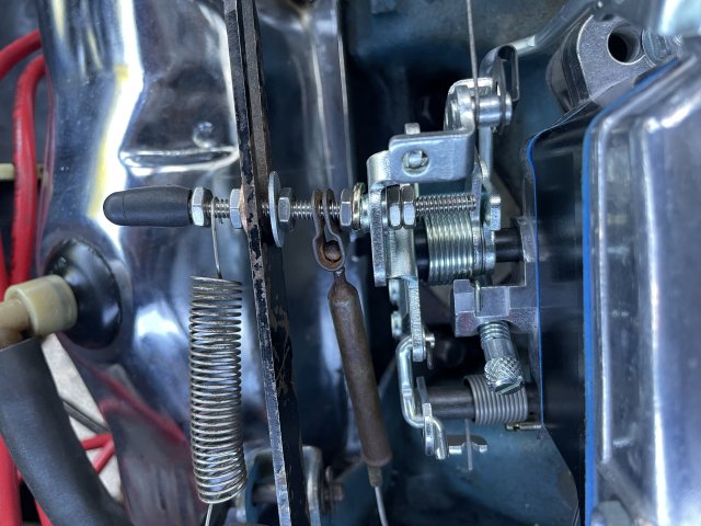

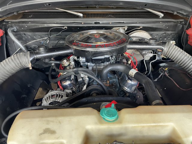

I finally caved and replaced the Thermoquad with a Holley Street Demon 625. Muuuuch better idle and throttle response. It really was bolt on and go. I did reset the idle mixture but that was it.
I had to get creative with the throttle linkage because even with the Holley stud I couldn’t get the throttle cable connected without binding on the carb linkages. My threaded rod seems to be a good solution.
I had a Holley Avenger on a car I got, it was setup with a bolt like yours, never had any issues with it. Whatever works.

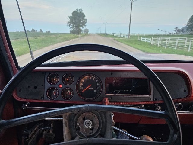

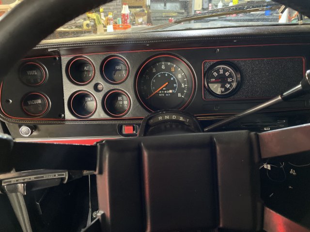

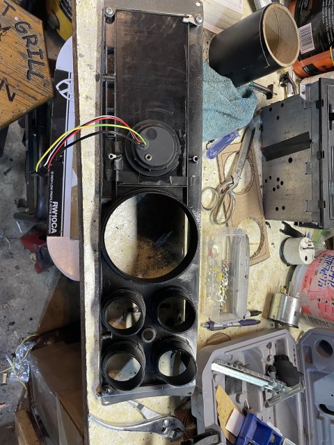

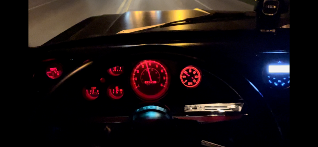

Jumbreit, I know you've completed this, but could you give some more detail on that dash? I'm wanting to do mine in the same style. Did you paint this black yourself? Also wondering how you did the red accents. Thanks for any reply!Y
Yep, painted it myself. Can't recall exactly which paint, was likely just a can of matte black I got from the hardware store. For the red accents I just grabbed a bottle of my sons model paint. I'll bet one of those paint markers would work pretty well too. I recall having to be verrrry steady with my hand on those gauge bezels.

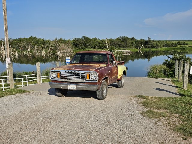

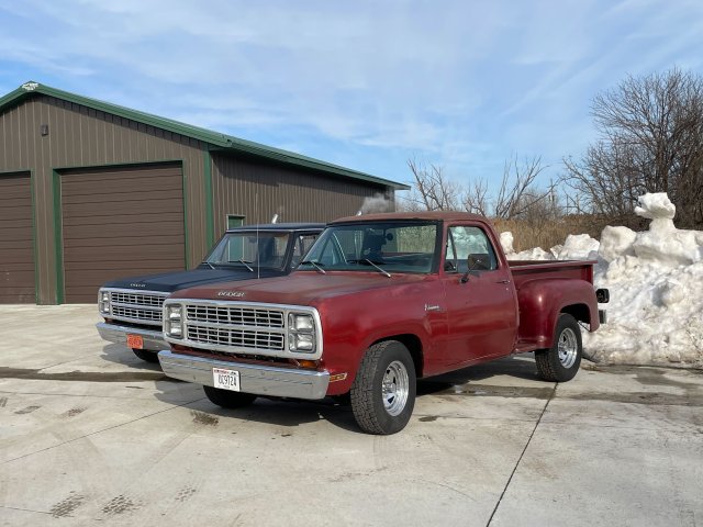

I picked up a 1979 D100 Stepside from the state of Washington this February and drove it 2400 miles home to Wisconsin. I got it for $3500 and it is essentially rust-free. I bought it at first as driver that could, if needed, donate body parts to my Red Nite Express if it were to get into an accident. Then I realized, this is ALL 1979 whereas my black truck is 7 trucks put together from 196x to 1989 so why not just do a body swap. Put this clean body on my Lil Red frame and do a proper restoration and paint it red. The black truck will live on the D100 frame.

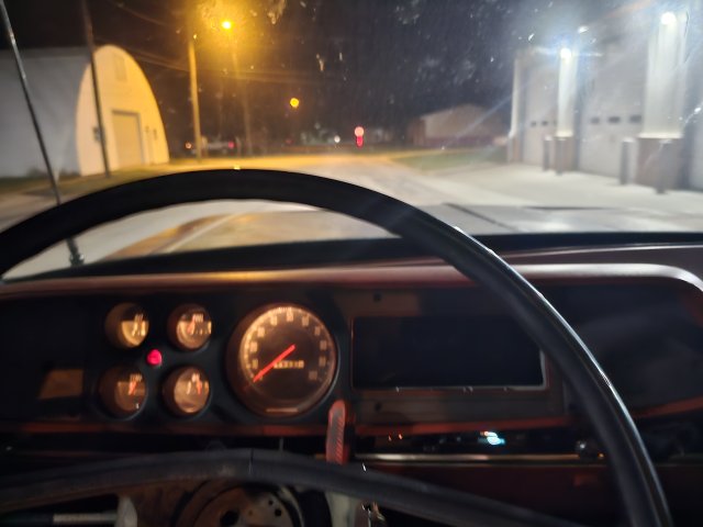

Here is how my interior is doing. Took some ideas from yours. Working on new seats now. I'll have better pictures soon. I'll go follow the YouTube channel you have.
Finally! Last pic is what I started with. Hope to get the '72 Dash ready over the winter to put in next spring.
