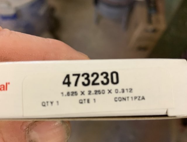

I tried Rock Auto to with no luck. I ended up going to what is commonly called a mom and pop store that uses computers and the old parts books. We looked it up using a caliper to get the dimensions and I had them in a few days. They are for a different vehicle but are the same.
I'm adding a pic of the part # maybe it will help someone in the future.
Thanks again, Don Taylor

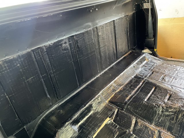

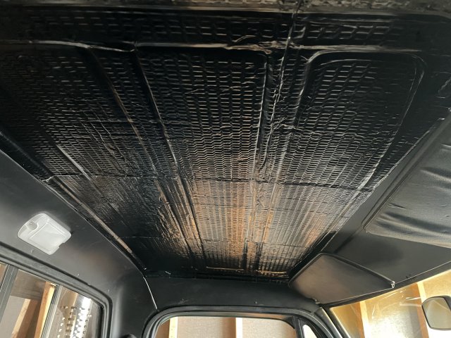

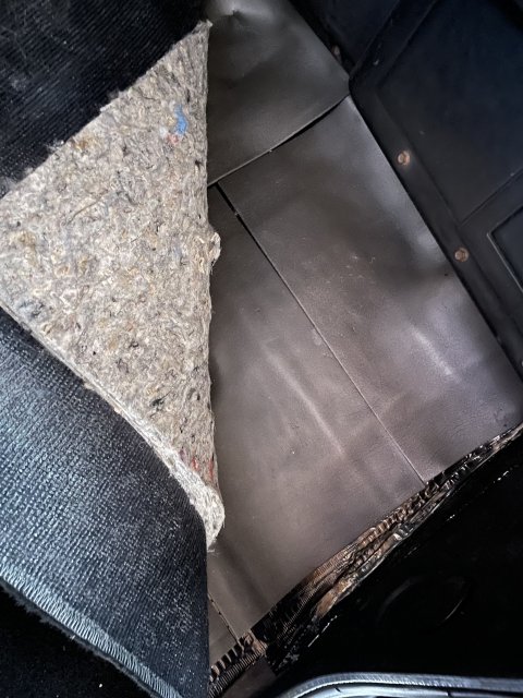

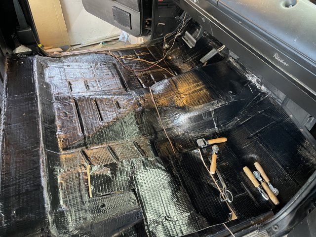

Now that I’m driving it on the hi-way, I wanted it a bit quieter so I added some Noico sound deadener on the floor, back of cab and even on roof. I did double up on back wall and trans tunnel. Then I put some closed cell foam on floor pans. I also replaced the fiberglass firewall insulation with some stuff I had out of my old Volvo 240 that was rubber backed foam.

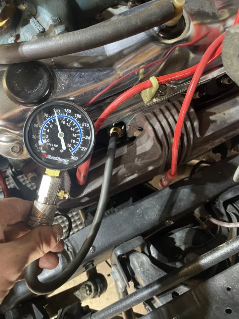

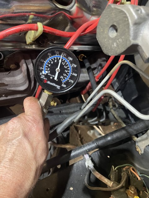

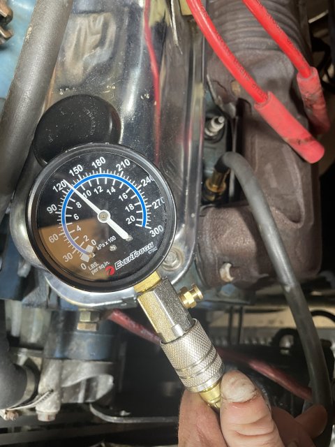

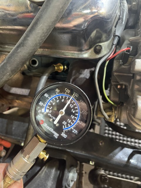

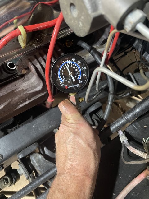

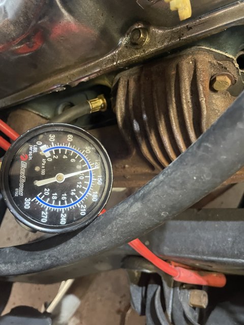

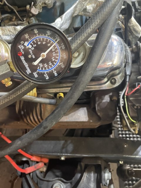

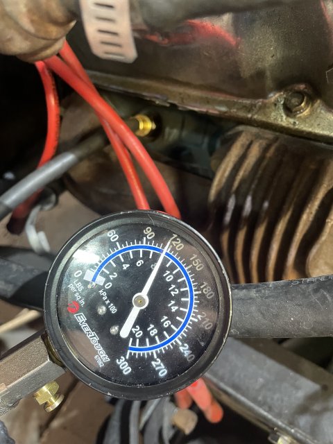

Posting my recent compression tests. Running 120 or so on most with a couple at about 150. I’d like better but whatever…it is what it is.
