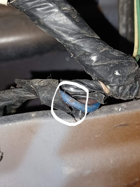

2 cups to get moving then I went to work on my truck. I had to replace the ignition lock cylinder Tuesday night, it's not available with new keys and preassembled so I had to take it apart put the tumblers in a line then assemble the new cylinder with matching new tumblers. I got that built and installed, but when I got home I noticed the door locks and the drivers window didn't work😧 I thought what happened.....
I checked my work on the cylinder this morning and I didn't see anything I screwed up, so I started testing the window switch and lock switch. I found that I could operate the passenger side but not the drivers side by jumping wires. I pulled the drivers door panel to check the wiring and then found this.....
One of the window wires was rubbed through and touching the metal edge. Taped it up, reconnected the switch, door locks and drivers window are working again.
Not sure what was going on in the switch, but with that wire grounded it was causing havoc
I kept blowing fuses a few years ago in my A100. Turns out that part of the loom for the lights and wipers was close to the wiper traverse arm under the cowl....well, after a few miles, that loom was rubbed through and eventually cut down to copper on one light feed.
Found the rub, and opened the loom, taped up (I'm going to redo it one day soon) and away we go.
It is good practice when making custom looms to make sure there are no rub or contact points with potential to move or vibrate.
