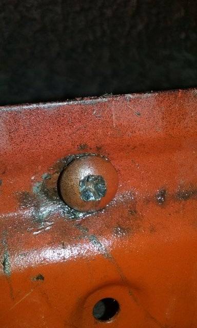

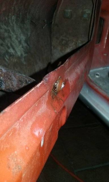

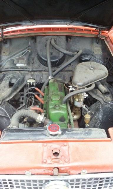

Thanx my brother! Gosh, I hope you're awake, been battling with a striped 'Phillips' head on my wife's Nash Metropolitan (I kept calling it a Cosmopolitan). Who cares! I guess I do? Please be awake! You too brother Bear!
This "Clown Car" is 'Jerry rigged' more then my truck!

I can't get this piece of shit off! (Striped Phillips).
I'm awake but working, and no phone with me except brake time. That screw is screwed! Looks like you might be able to get a pliers or vise-grip on it and spin it out. Otherwise, an easy out bit from the parts store. Throw it in a drill and it grabs onto what's left of the screw, bolt, you get the idea. It sucks running into this sort of thing, even worse after midnight if you don't have the tools.

I am "Screwed!". Lol!!!... Hey brother, thank you for taking the time to respond while at work. Shit, to be honest with you, I haven't heard or seen a 3rd shift in a minute! The 80's maybe?
