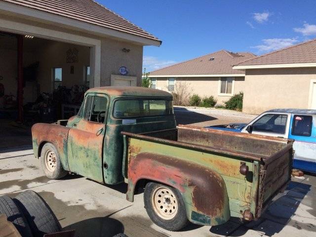

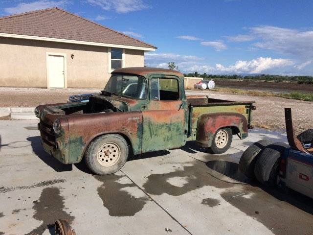

I got you a pic outside.
Thanks for going out of your way for the pictures . You see I'm a visual type of guy . If I where there helping you , this is were I'd be stepping back , lighting a smoke and saying , Hmmm as I was looking down the sides . lol ... I think it look's pretty good at that height . But maybe it's the angle of the picture but it looks like the back of the bed is about a 1/2 to 3/4" lower then the front . Is it just me ?
Thanks for reassuring my eyeballs, Bear. I was just too leary of starting something by saying anything since I've never met any of you folks.

Don't worry, I likely couldn't have kept my mouth shut (or fingers still) too much longer - couldn't take a chance that it is crooked and didn't get caught until it was finished, it's a lot easier to fix now. That's the kind of stuff that always seems to happen to me and it sucks big time. It was good to find I wasn't the only one thinking it looked a little wonky.
lol , Ok guy's . You know that bed is only set on there to check for the height and not permanent yet . What the heck did I start ? lol
I agree the pic made it look off a little. It doesn't really look off in person. I've been working on the tubs. What a lot of work those things are. I'm getting there. Too busy farming to spend much time on the truck for a bit. I'll post more when I get back to work.

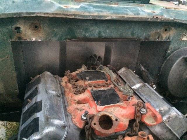

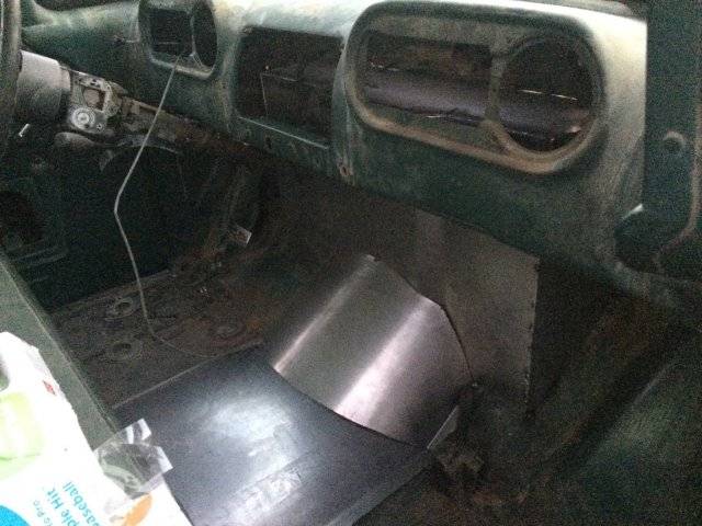

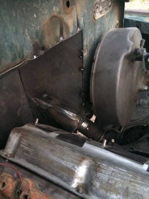

Back to work on the 56. I had a local guy build the firewall for me. My son pushed me to get help. So I'm pretty happy with the results. I can now finish the new raised floor in the bed. Then take the truck apart for blasting and powder coating the frame and suspension.
Glad to see your back to work on it . As far as having to ask for help , Don't feel bad , we all need help at one time or another . Whether it be as simple as an extra pair of hands or something bigger like fabbing up a fire wall . ;) The important thing is to keep going forward on it and you'll be out terrorizing the streets in no time ! :cool:
