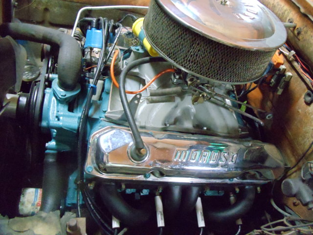

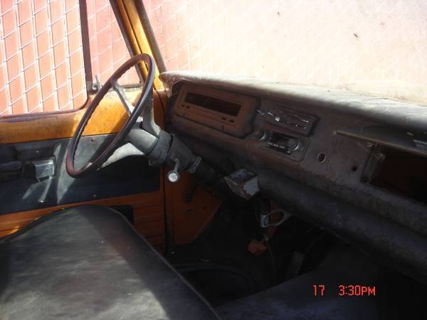

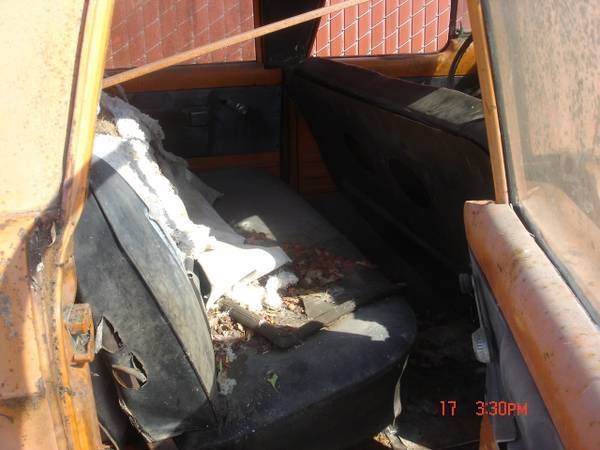

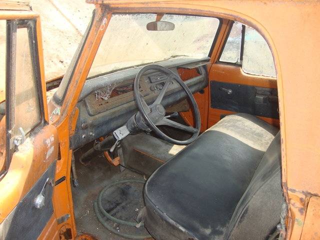

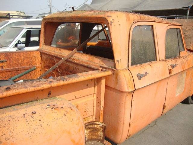

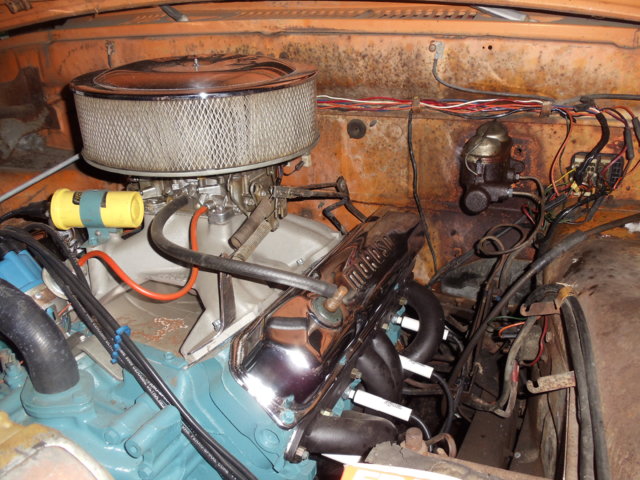

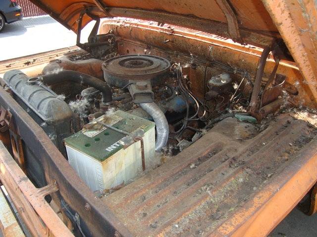

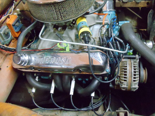

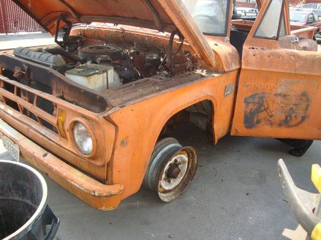

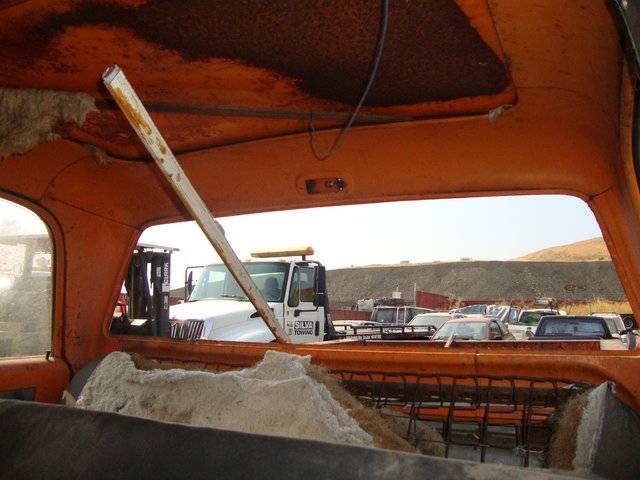

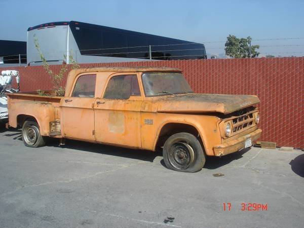

thanks all , its a fun junk build . have so much stuff i'm tripping over it and walking on it as well . so started moving it to a more story area , not in my shop . and started using some of that stuff for this build . most of it was cast off parts from others and just pieces n parts from leftovers . and stuff i've been collecting for years . i'll be getting back on it soon . but had to get this crewcab going , so i'm stuffing a 440 auto with headers weiand hi rise intake electronic ign volt reg 2 1/2 manual bent to flowmasters . so no pics . dropped the camera , it needs a repair now , lol . but a pic of what i started with . and one pic after a bath n rollers mounted .theres a shot of orangy and now oranger , lol .

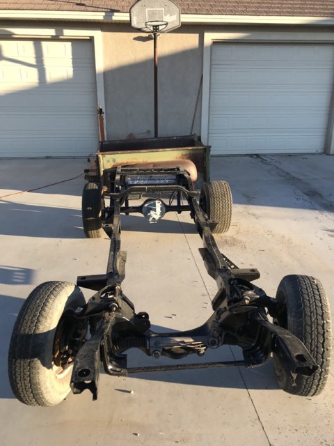

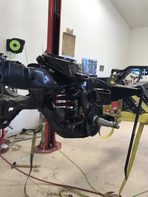

Thought I’d put up an update. Frame and chassis parts powder coated. It rolls again! Moving on to engine assembly soon. Work and play in the way still.
Yes I am. Still a long way to go. I went to Hot August Nights and was humbled by all the work that people put into their vehicles. But I’m going to keep chipping away at it. I’ll send a better pic of the chassis this week.

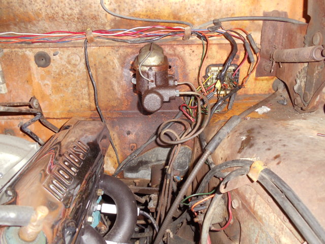

need some more pics of the harness back in place . still got to replace the steering column . hey butched it all up at the turnsignals , i've need seen such as this , i thought their turn signal trimming was bad enough , never thought i'd see that . pics to come .

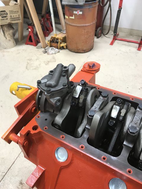

Short block done. I have a problem choosing an oil pump. I bought an adapter from Hot Heads that allows using a 340 oil pump on the Desoto. Lots of negative feedback on the web with this setup. There are a couple other choices. Working through those choices.
Desoto Hemi’s have a unique pump. Hot Heads makes an adapter to use a 340 HV pump. Uses a plate on the main cap and changes the main shaft in the 340 pump from a hex socket to a blade and notch coupler like the original Desoto.
There are reports with pictures of the material in the replaced pump main shaft failing leading to Catastrophic engine failure.

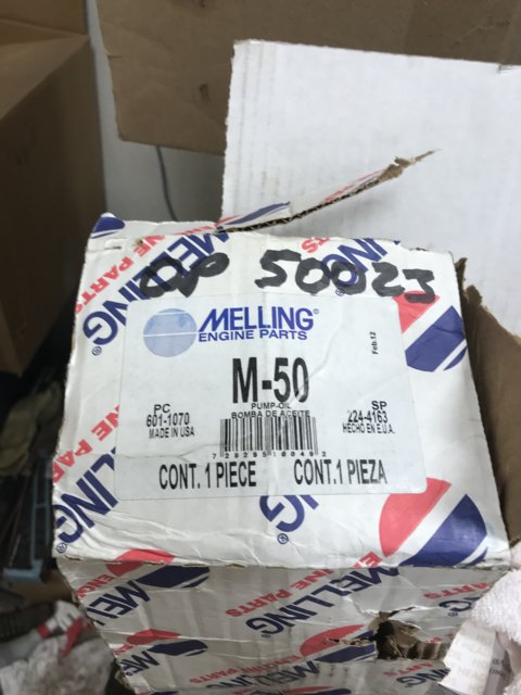

Then there is the M50 Melling oil pump that is a replacement for early hemis. Questions about this pump’s shaft length being .1” short and what that would do for longevity. I would have to make my own pick up. Not the end of the world.
Lastly I have a low mileage original pump. I could check it over and replace the soft parts. It is a direct bolt on, has the original floating pick up, and might offer the safest route.
Due to some crossed signals with my machine shop I wound up owning the two “new” pump choices.
not sure what hotheads is selling now , i bud here in calif made a kit up for h/h . but now there going else were . his stuff works . let me know if you wish to contact him .

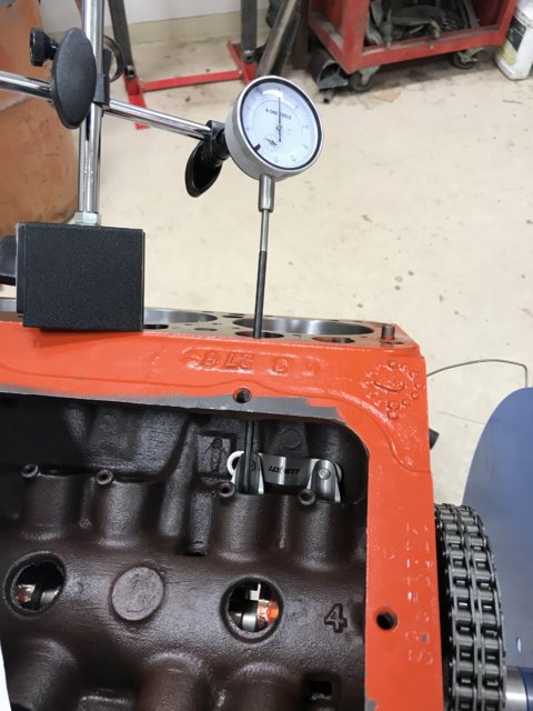

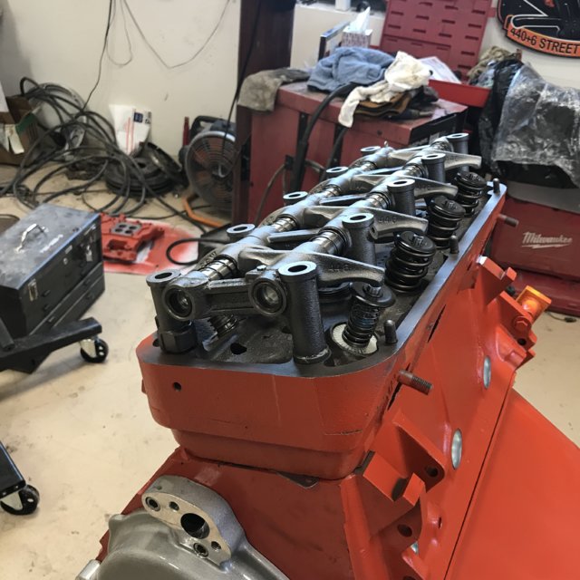

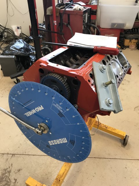

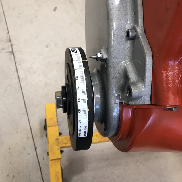

I moved forward with getting the cam degrees in. I had a new billet roller ground by Donnie Johansen. 232’@.050 and .435 lift. Donnie had included a cam sheet but it didn’t include a cam centerline. I finally figured it all out. It was a learning experience and I have a bunch of new tools. I bought a Big degree wheel, a 6” extension for my dial indicator to reach the lifter, and a crank socket.
Next was checking piston to valve clearance. No problem I have .3”. After that I measured the pushrod length and ordered the new adjustable pushrods.
