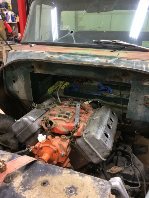

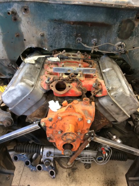

I picked up a 56 dodge pick up a couple of years ago. Took me a while to figure out my build. Decided to use a Dakota frame and a 341 Desoto Hemi with a A-518. My dad had a hot rod 56 with a 330 Desoto when I was a kid. I wanted to create a tribute to my dad's old truck.

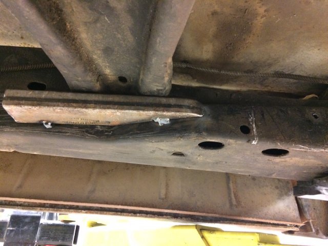

I've got the motor in the frame and the cab set on. I had to set the motor back 7" or so for steering and exhaust clearance. The rear trans mount I reused but I had to add tubing to the inside of the frame for the crossmember to slide back on. Front motor mount brackets came from Hot Heads. But the frame to insulator portion is going to be a fab job to clear the rack on the drivers side. passenger side be a little easier.
I'm a little concerned about how much work will go into making a trans tunnel and firewall.

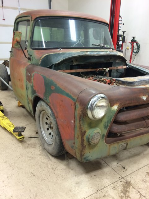

I had some very good help last night. My son and son-in-law came over last night. We got the cab and front group mocked up in place. Now it's time to build cab mounts. I'll be reusing the Dakota biscuits. We had to really get after the firewall. I'm happy with the trucks ride height. It's the look I wanted. Back at it tonight.

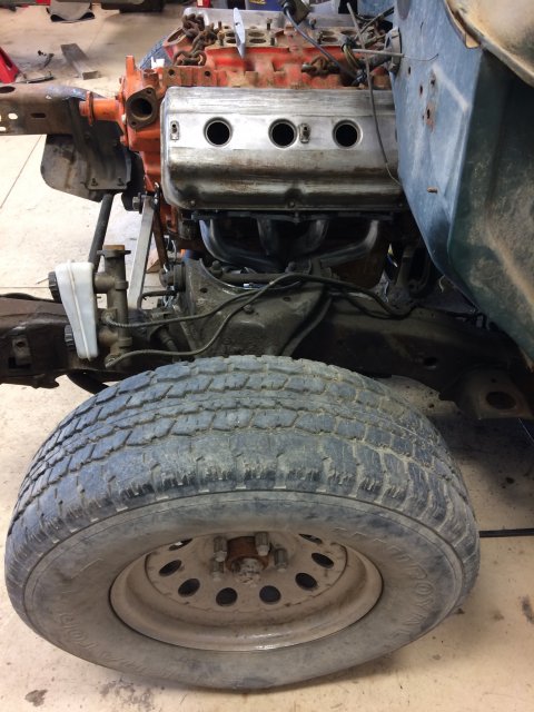

Yes it's great to get help, especially when we were muscling the cab around. I would like to get suggestions on the steering column, shaft, u-joints etc. Aftermarket would be ok but junkyard works for me too. I would like to use a column shift but not sure I have enough valve cover clearance for the shift arm. Been trying to you tube steering shaft ideas? Haven't found anything that gives detailed do's and don'ts. The rack is tough to get to because of exhaust clearance issues. So I think I will have two sets of joints to get there. Any thoughts or better yet pics and explanations of successful double joint shafts?

Just a quick question . Instead of cutting the fire wall and moving the engine down and back . Couldn't you have moved the engine up and forward and either gotten another oil pan or modified the one you have to clear the rack ? Just curios , because I can't see what you see , me not being there in person to see what clears and what doesn't .
I was wondering that myself. I know the ploy blocks, some of the early hemis and LA block will excepet the same oil pan. An LA truck pan would put the sump in the rear. 318 pans are different than 360 pans due to main bearing sizes.

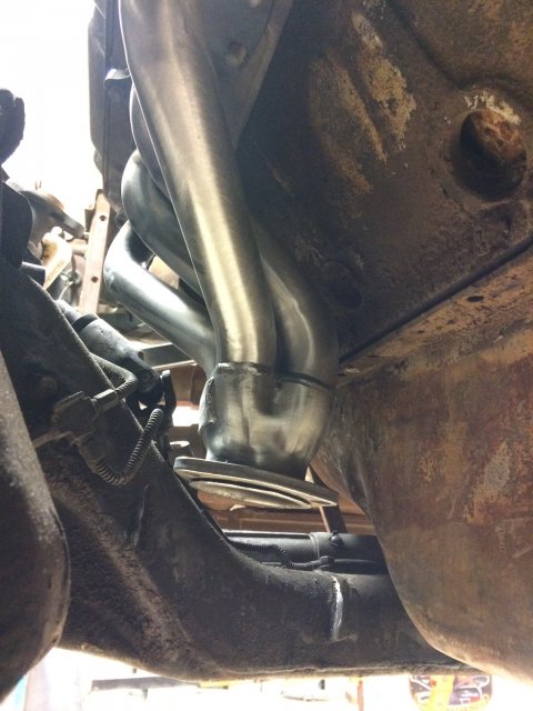

When I started fitting the engine and trans I tried having the engine in the "stock" 1992 Dakota location using the rear trans mount as a reference. The 318 magnum motor has pads on the middle of the block for the motor mounts. The Dakota moves the motor 2" to the passenger Side for steering clearance.
The Desoto hemi has motor mounts in the typical LA location towards the front. When I tried the stock location I had major oil pan interference. The exhaust wasn't even close. Steering wouldn't clear exhaust. I did not want to cut the front frame crossmember other than minor scalloping for clearance.

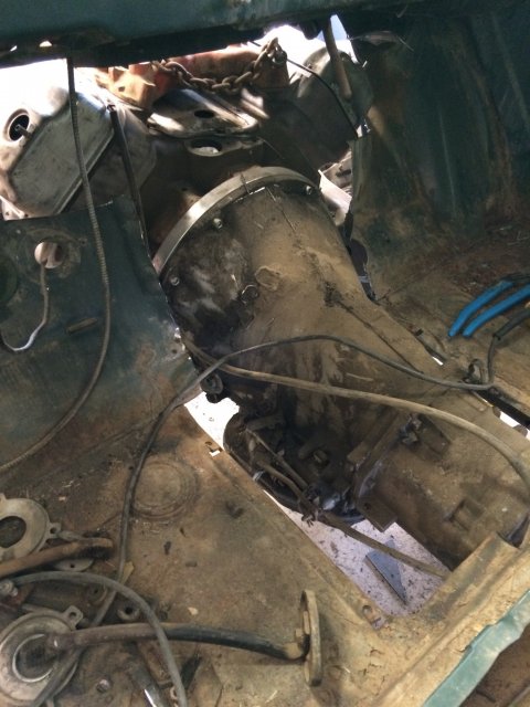

I was hoping with minor firewall cuts I could find enough clearance. I thought at first I could cut a couple inches out of the front of the oil pan sump and I'd be good. Problem was steering and exhaust clearance demanded moving the motor back further. I tried several positions moving back an inch at a time. When I finally got steering and exhaust clearance the oil pan was no problem. But I had to really cut into the firewall. I think I'll be ok inside the cab. It doesn't seem like it really intrudes too bad into the driver or passenger space?
I'll send more pics later showing rack clearance etc. I have a pic of exhaust and steering, and trans crossmember modification.
Believe me , I'm not a arguing or criticizing your methods . I've done a lot of motor swaps as well as body swaps . So understand the term "you'd have to be there" . All that said , I just would have thought that it would be better in the long run to modify or custom make a set of headers as well as the oil pan , to make it fit closer to the stock location . Same with the transmission cross member .
Well I can't argue with you. You might be correct on which way to go. This is my first body swap. Although I raced dirt cars for 18 years and built my own cars. The down side of having the motor back is a cramped cab. So I'm thinking I'll finish the cab and fender mounts. Tack them in. Then mock up the steering, seating, and firewall to determine if the driving position is comfortable.
If I need to move the motor forward, custom headers are mandatory to clear the suspension crossmember. The steering shaft is problematic even with custom headers?there is point as you move back the left motor mount would have to be very creative. The rack input shaft and motor mount are trying to exist in the same place. A motor plate would fix that but I'm not crazy about having one? Like I said earlier, I spent 10 hours last Saturday mocking up engine and trans positions moving back an inch or a little more at a time. One problem would be solved and others were created as I moved back. Right now I'm in the best place I've found.
