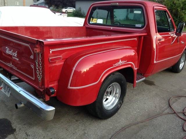

I kept it spring over with new perches and used Chevy drop shackles from summit racing I think I posted one pic under introduction it's a 78 canyon red warlock with a 440 and yes I think we do have pretty similar set ups lol I need to get better about posting stuff
Yeah , Now I remember your truck . :) You should post up some more pictures of it . If I remember right , It was a dam nice look'in truck ! :cool: And a big block too boot ! :wideyed:
It's not too bad mostly original paint it's getting due to be redone just haven't brought myself to do it yet plus I'm getting ready to tear my power wagon down so I can give it a fresh paint job
View attachment 7333 It's not too bad mostly original paint it's getting due to be redone just haven't brought myself to do it yet plus I'm getting ready to tear my power wagon down so I can give it a fresh paint job
Yep , That's the Warlock I remember ! If I remember right It was a pretty quick truck too boot ! You should start a thread on it and tell us about it and how you got it this far . I'm sure there's a few things that you've done to it that people would be interested in hearing on how you did it . That's how or why I started my build thread . A lot of people were asking me question's on how or why I did something and I had already had my truck up and running . So I started the thread . Of course mine is an on going build . But now people cane see it as it evolves for them selves . Your Power Wagon would also make a good build thread as well even if it is just body and paint .
