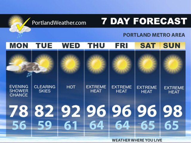

      We have some warm weather coming, at least very low humidity, Bob has the pool all set up, and I am ready for the hot weather DhqBmpIUwAESdxc.jpg

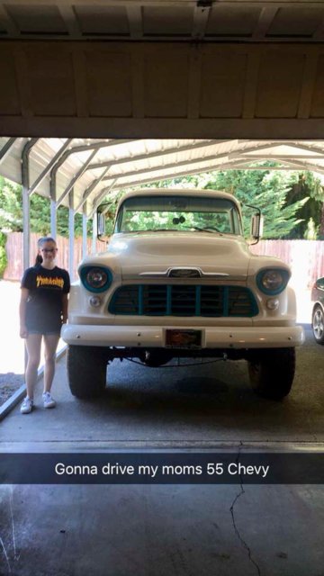

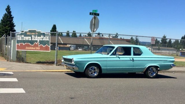

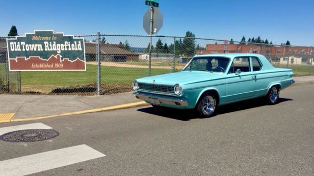

                    Yesterday Bob let our grand daughter drive the 65 Dart, our daughter was a little mad but soon got over it, then our daughter took it for a couple of hours cruising the back roads to Ridgefield Wa. then she took my old 55 4X4 truck out 36897099_10156693976152268_4014723888276570112_n.jpg 37032687_10156693976187268_4647337043007897600_n.jpg 37015876_10156693976162268_6010396728878956544_n.jpg

                      I see height is a strong trait!
