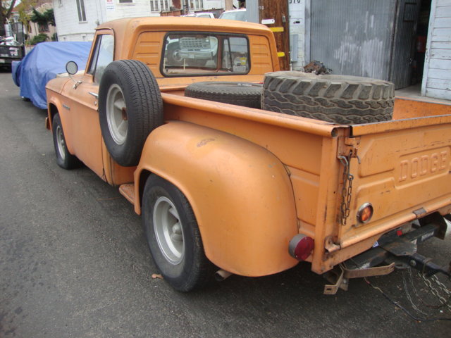

I think the truck is pretty much original, but what the hell do I know??? I saw this truck just sitting and rotting in a parking lot near where I live, and I just could not stand it anymore. I am a member of the b-body forum as I have a 1969 4 door Dodge Coronet. The guys over there suggested I come over here. Here is a link to an update thread I started over there including 4 videos:
Update on the rescue of the 1966 Dodge D100 Step Side V8 4 speed pickup
First, is this configuration common? I have not been able to find a place to tell me production numbers for 1966. What size of wheels should this truck have on it? Right now it appears to have 15"x7 with 5x4 bolt pattern running P235x75 R15 tires. I was not a Mopar truck guy till now, so I am sure I will be back for more help. Is there a website that sells restoration parts for these trucks? I got a lot of stuff for my Coronet from Classic Industries.
