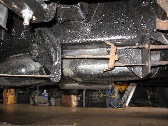

My Warlock . I think it's a little easier to see .

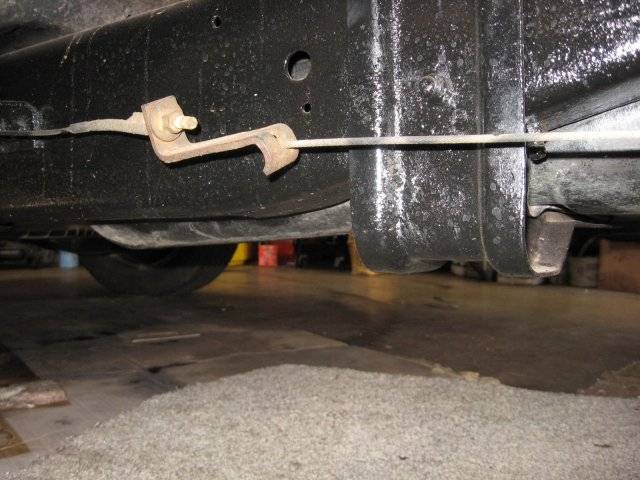

Thanks, mine is a little different and doesn't have the arm but I believe you've showed me what I'm missing and I know I saw it somewhere. Time to start searching!

What's the arm for? Mine looks just like your first pics minus the arm.

Hope it helped , There all pretty much the same design . Just little deference's from gen . Your's doesn't have an arm ? Hmmm ?

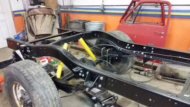

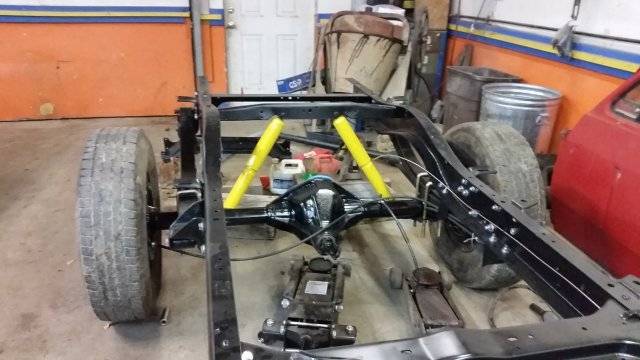

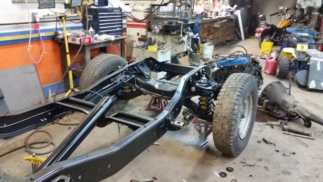

Nope.. no arm. Well the last 2 pieces needed to sit it on it's wheels will be in today so I can finally put a fork in the chassis. This weekend I'll start on the cab and rounding up more parts for blasting. Joy, joy, this is going to be fun removing all the surface rust!!

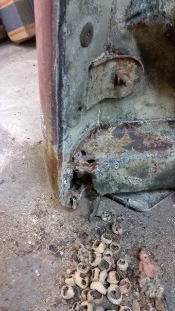

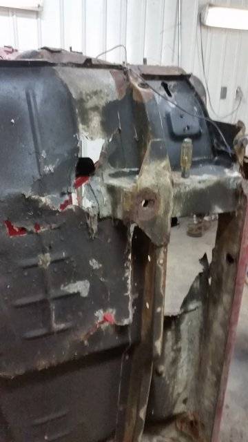

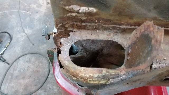

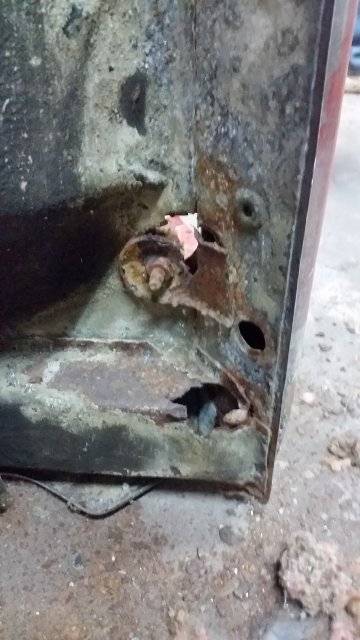

Finally it's a roller again!!! Brakes (exept master cylinder) suspension are done. Here's a couple pics of the needed rust repairs on the cab, quite a bit of rot underneath but shouldn't take much to fix.

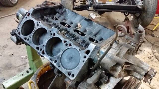

Got most of the motor torn apart today, I'm liking the looks of things. From the looks it looks like it already has flat top pistons and no ridge on the cylinders so I may be able to squeak by with a hone job and new rings? I'll check to see how far in the holes the pistons are and the head cc's to figure up where the compression is before going any further in case I want to bump it up. Heads also look really clean inside so I'm crossing my fingers that this will be a cheap rebuild. I've got the equipment to grind the valves and seats plus the hones so I should be good.
Once this is all the way apart it will go to the machine shop for a full bath and magnaflux.

Man ! This build is coming along quick ! You must be spending every spare minute working this truck . I wouldn't worry to much about the few rust and rot issues . Judging from what I've seen so far of your welding skill's , they won't be that difficult for you to fix .
