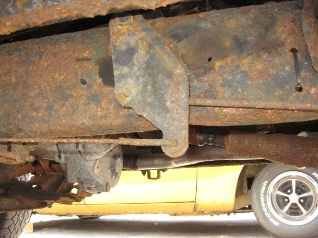

Good job so far ! If I get a chance this week , I'll slide under one of my trucks and get a picture of the E brake set up for you .If you think that will help ?
I'm sure it would help, I'll stop by the salvage yard and see if they have one but if not I'll just make one. The only thing I think I'm missing should just be a small stamped piece of metal with 3 holes in it.

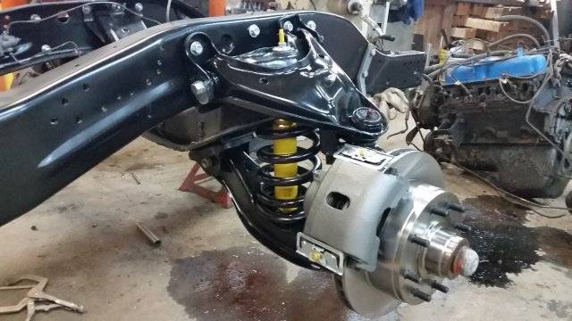

Wow! Tha whole chassis, suspension and brakes look's like it just rolled out from 'Factory!'.
Thanks but I don't think they ever painted them haha! I do like the way it's looking except the pitting in spots of the frame but what are you gonna do, weld and grind forever, fill the frame with putty or just except the fact that it's just a frame that will not be seen again and forge on?

I still think you did the right thing by painting it, even if it never gets seen by most people. It's going to eat away at me when I do my truck, if I don't do what you did. Maybe I'll have a huge shop by then!

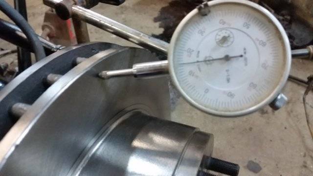

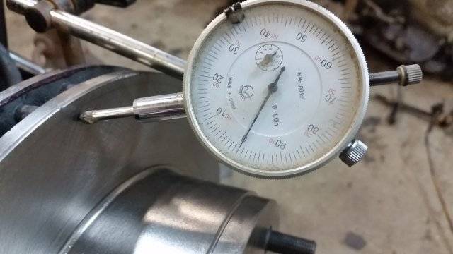

Other than wrong parts here's the other bad news, after installing the brakes it didn't sound right so I threw an indicator on the wonderful Chines rotors and walla .015" out of true! Off they come and back for a skim cut to true up what those cheap @$$*@!&s Can't seam to get right!

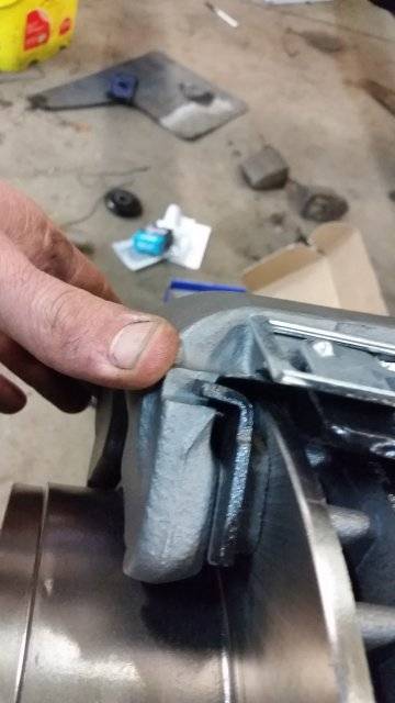

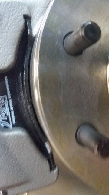

Now another aggravation! The brake pads rub, can't say if this is from an oversized rotor, an over machined re-man caliper or just improperly bent tabs on the pads???? I do know that bending the tabs a bit more is how I'm going to fix it though.

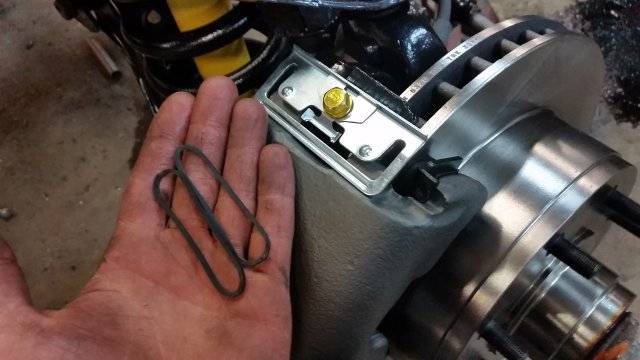

Now for the question, where do rubber bands fit into brakes????

I think the rubber bands are for dampening vibration, but I can't say for sure as I never have used any.

My take on the rubber bands is, how long is a rubber band going to stay in tact on a caliper?????? Why even install them wherever they go?
Look'in good ! Bending the tabs down "should" do the trick . I normally use either two hammers or a hammer and a punch . As far as the rubber bands . I haven't seen those in "years" ! If I remember right they go around the hold down on top of your caliper . Like I said I haven't seen those in years , way back when I was first twisting a wrench . I used to use them all the time but haven't in quite some time . So I wouldn't worry about them . It'll be fine . As for your rotors being out of round . I'm not surprised . When I swapped my rear to 11" I got everything new and I had two majorly out of round drums , two bad wheel cylinders and the self adjuster cable was the wrong length . I had brake problems from the rear for a week trying to figure everything out and get it fixed right .

By the way , here's some pictures of the e-brake cable set up that you needed . The rusty truck is my 84 and the cleaner painted shots are under my Warlock . There all pretty much the same just different length's for different trucks . But hopefully you get an idea what you need .
