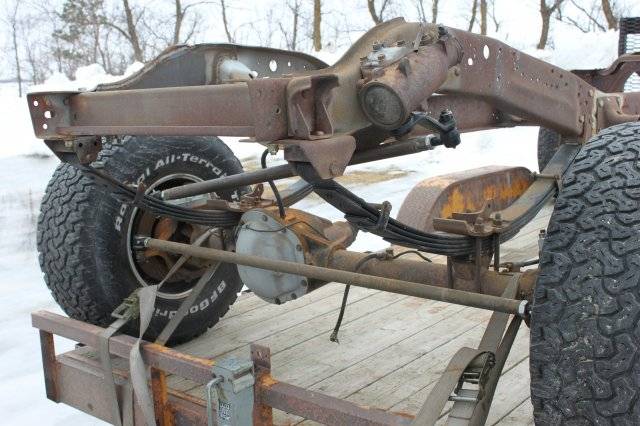

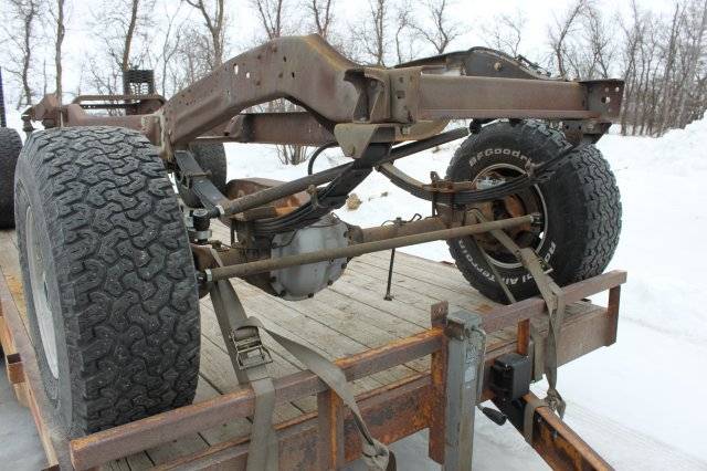

From what I've read, the chevy springs being longer have a much better ride. They're about 11" longer than the dodge spring. The tell tale will be when I actually finish the truck and get to drive it. lol
Yeah , That's what I understand too . I was considering going the route with my Ramcharger as well before I decided to retire it . I guess it'll have to wait for my next four by four build now . :(
Sorry been kinda awal lately. Like to say I got some more done but nope. Never knocked off much of the " to do's ". Was just one of those years. Just a bunch of combined factors. I'm hoping I can get the frame finished up n painted before the end of the year.
your truck will look really good. like the mod with the 63" chevy springs. wish i can do the same on mine which is 4" lifted and get rid of the blocks. could you tell more about the ride?

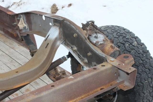

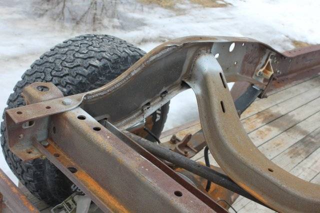

Well, it's not much but I did manage to get a little bit accomplished lately. Got my crossover steering installed and frame stiffener plates welded in.
Hey , Any progress is good progress . Obviously you know that's a week link where the box bolts to on the frame of these trucks . I've had to weld up that area where the box bolts to the frame on a couple of trucks in the past . Keep up the good work Indy and I'm glad to see you getting something done on it .
Was there any glaring issues with your frame? I'm hoping mine is good enough to build off of and not have to take the body off.
No, the frame was pretty good over all. Surface rust was a little heavy in a couple spots but cleaned up good with a blasting. I would just check around the steering box for cracks and also make sure there isn't a bunch of crud built up behind the fuel tank. That'll make the frame thin out if not cleaned up. The frame on the parts truck I took apart was rotted right through there. Completely full when I pulled the fuel tank out of it.
