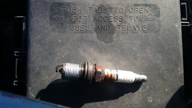

Update-
I did what Mr. AJ suggested with taking the plug out and swapping it with another, here is what the plug looked like when it was taken out after it was cleaned.....
While the plug was out my stepdad noticed that it was at about .50 so he tightened it a bit to .40. When that was done we swapped it with plug 3 and cleared the code. He told me he thought the wires looked good. I just got back from a little ride with it to the center of town and no light came on.....yet. I would think the light would of come on already but I will take it for a longer ride soon to see what really happens. I right now am thinking it is the plug but I will keep everyone posted when I take it out next

Next time post a picture of the electrode end before you clean it. A cleaned plug shows us will not much.
