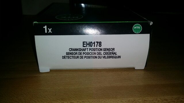

IT FINALLY HAPPENED! I took the big green beast out today, and I was going to a friends house 2 towns over from where I live. I was in his town and I decided to stop at Dunkin Donuts, and boy was that a mistake. It was running great until I got in his town. I pull into Dunkin Donuts, I am waiting in line with the car in drive NOT neutal and all of a sudden it stalls. Here's the kicker, normally it starts right back up after it stalls and continues running. THIS TIME it does not want to restart......perfect. So what I did was pushed it out of the way and let it sit for a half hour with the hood open. I start it up and it was fine after that. THAT said I had to tell my friend sorry I am not coming with the car acting up, and I did indeed make it home and luckily did not have to have it towed. So that prompted and motivated me to order a crank sensor. Here is what I ordered.....
1998 DODGE DURANGO 5.2L V8 Crankshaft Position Sensor | RockAuto
More Information for NTK EH0178

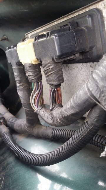

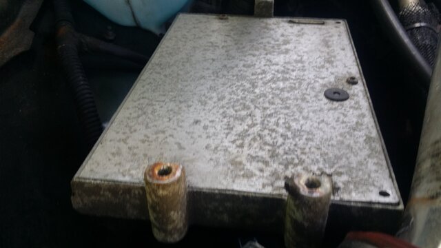

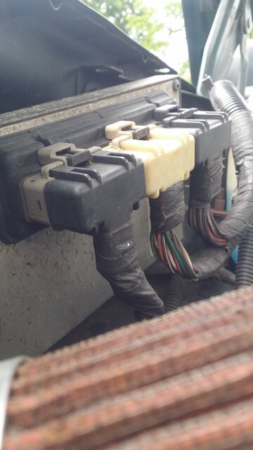

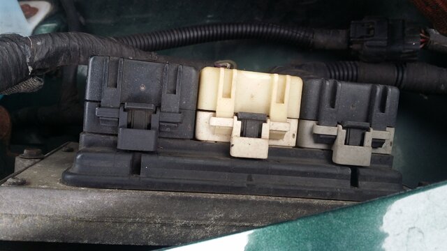

Locate the computer grounds and make sure they are making good contact. I maybe wrong but the computer maybe over heating causing a shut down. We carried a 12V portable fan in the old Dakota just to cool the computer down in the summer time. Unless it got real hot out it would cut restart times to 15 minutes. Yes it was annoying but the old truck just was not worth the cost of a new computer.
Hi All,
So I took @7mopar's advice and located the computer today, and also cleaned it. Like everything on the truck the connections were a bit rusty which could of been my problem. We cleaned those and sprayed some spray on the connection holes to where they connect to so it helps stop it from rusting again, and we also reset the pcm too by unhooking the negative battery cable and letting it sit while we cleaned the connections. Took it for a 15-20 minute ride today and ran great with no issues. The crank sensor is still on the way, it shipped today and so as of now we are planning on putting that in

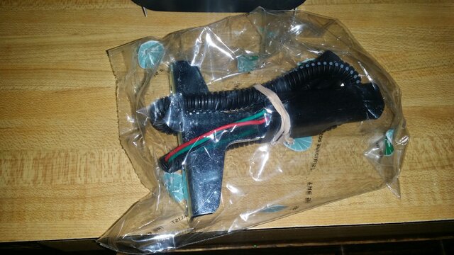

I got the crank sensor from RockAuto in the mail today. It will most likely be put in tomorrow. I looked up a video on how to replace it and it looks kind of like a real B.....fill in the rest to do. Has anyone else replaced one before?
