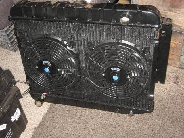

And here's the beast of a radiator I squeezed in . Between that and the two 12" fans . Luci's been much happier .
I'd probably have my crap done if you lived nearby! I get distracted easily when I'm working alone, the girlfriend's not the best project manager, but she is the best criticizer!
I'd have no problem helping you out with any of your rides . I really do get into building them . It's funny , I was just thinking of you yesterday Mob . I made a new friend .
You just made me think of what I'm going to need to do with my truck when I drop the 440 in. All I have to worry about is an alternator, as I'll be putting duel electric fans on the aluminum radiator I'll be going with.
Who knows , you know me . Eventually I might change my mind and go with an aluminum one myself . But for now this one is working just fine . It added about a gallon and a half of coolant over what I had before . You should be fine , just as long as you pick out the right fans , have a good battery and a good alt. . The two 12's I use now draw very little and I have no issues . Now the two I had originally ? They drew a "bunch" . At idle , I could see the alt gauge discharge every time I had them on .
I'm going aluminum cause I don't 1) want to spend a lot of money, and I can get an aluminum one cheaply 2) care about original looking, at least on my rides. Champion Radiator makes a truck one, but I think it's for a small block, and I want to havetto much capacity for cooling.
As for draw, I don't have a gauge in the Polara that works, but my electric fan, used as a helper for the flex fan, blows a ton of air. Came out of a late 90's Bonneville and was free to use, just wired it up to a switch, and bam! Keeps it cool when I am in traffic around town.
Probably going tou se a Champion Radiator for a car and go with car water pump, then, if I can't find any fans cheap, I'll get a Dorman OE replacement fan setup for a Furd Focus. $100 at most part stores. Not sure if I'll use a controller or simple switch. I have a 4 core aluminum Champion for the Dart with fans and controller, but the guy I got it from couldn't get his Coronet to cool right, and screwed up the mounting flanges for the fans. I'll have my friends dad fix that for me though.
Believe it not , normally I don't have cooling issues . Not even in my high horse Charger I had or even my wife's big block Dart . But then again I knew that the cooling system wasn't going to hold up when I put the Warlock together . IF I wasn't in such of a dam hurry last year to get out on the road , I "should have" done it right the first time . It's my own fault . Champion is one of the better Radiators out there . If I do go aluminum in the future , more then likely It'll be one of there's . I'll go either a three or a four row as well as an aluminum housing . As a bonus , It'll look good with the tunnel ram on top and two big fours . ;)
