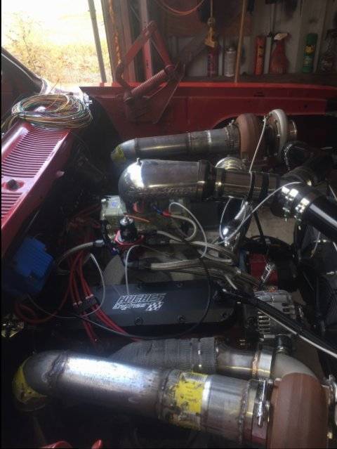

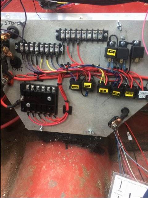

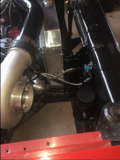

Here is a couple from today. Power board just about done. Engine compartment quite full but pretty much done. Tried starting today but having starter issue with a brand new power master.
NICE!!!! What size is that small block? The 360 Express? Yes/no? NICE work on all that turbo piping and made it all fit, (those ARE big engine compartments so you had a little real estate to do it in.....
It's actually a 360 magnum stroked to 408. The original express motor is on a stand in the garage. The compartment is big but you run out of room quick. A lot of planning went into it. I'm not a pro and this is not a show truck. I will be driving it everyday during the summer. So if you ever see it in person don't be disappointed in its exterior appearance. I spent my money on safety and go fast parts. As the say chrome don't get you home.

I see the stacks are still there, turbo exhaust routed to them? How nasty is the 408?

Yes the stacks are hooked up. As far as the motor it is a magnum block steel crank I beam rods Keith black pistons. Heads are Hughes performance race prepped. Cam is from comp ordered for my for turbo set up and head flow. M1 intake and a 850cfm CSU carb. Turbos measure 76mm at the compressor wheel. Tranny is a 727 all new Sprague bands clutches manual valve body and a 3800 stall Dynamic converter.
