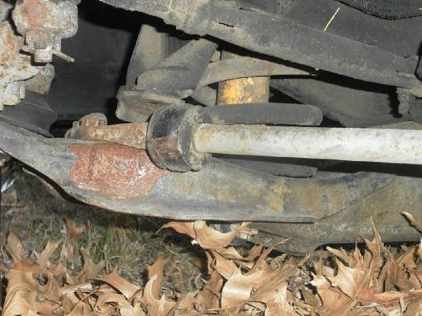

Thanks 7! I try to help those who don't know & when a guy on another forum was asking about the brace in a thread I walked outside & laid it on my spray table & snapped it
That one pic has helped countless others over the years

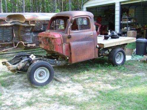

The 2-3 inch drop was the plan as I am doing an axle flip with the Dana 70. Thanks.

You can use 78-98? Van LCA's & drill your arms to fit the spindle & get the same results for drop & less $$$ spent on parts here's a pic of one on my RC

Ok. Thanks. I guess I should get some pics of this up somewhere. It's a cool project. I think you'll like it.

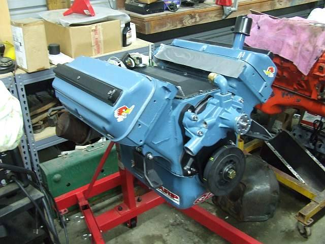

Now that's what I'm talking about! Maybe some Mopar will rub off on that Big Block Chevy sitting beside it
I like the Corvette water pump!
Wait till you see the induction system. Different doesn't begin to describe it.
I saw a setup at a swap meet that looked like a TunePort runner section turned backward with sidedraft webers for that Hemi
Naw, I have the old truck intake. It's a high rise dual 1 barrel. I adapted 2 GM large base 350 CFM 2GCs to it. It's pretty cool. I should have it together in a few days.
