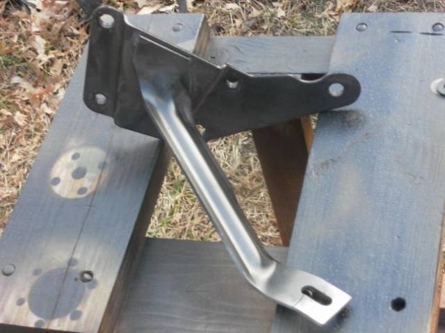

Just from experience with 1/2 ton frames of that era and all the added suspension wt. you are planing to add. You might what to consider finding the stiffener from frame to steering gear box that was added to later 1/2 ton trucks. Would be a pitting if you bent that frame after all your hard work. If it bends it will never stay put until you put in a stiffener anyway. Been there and done that.
SAM_3666.jpgYou mean like this factory brace

I am also not seeing how that brace can fit on my truck. Does anyone have an installed picture? Thanks.
It bolts on as pictured with the brace bolting to the front crossmember that the strut rods are attached to
