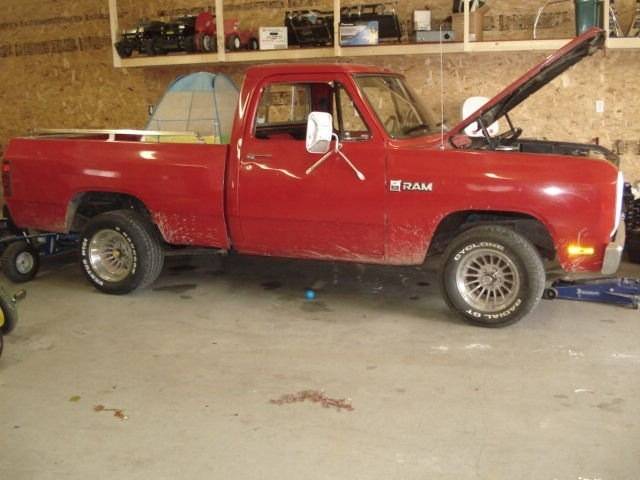

i would like to get a better stance on my red 81 d150. not sure if a 2-4 drop or like a 4-6 drop. what do you think? with the rear wheels being 15x10 they are about flush with the outer bedside. so can't tuck them in the wheel wells.

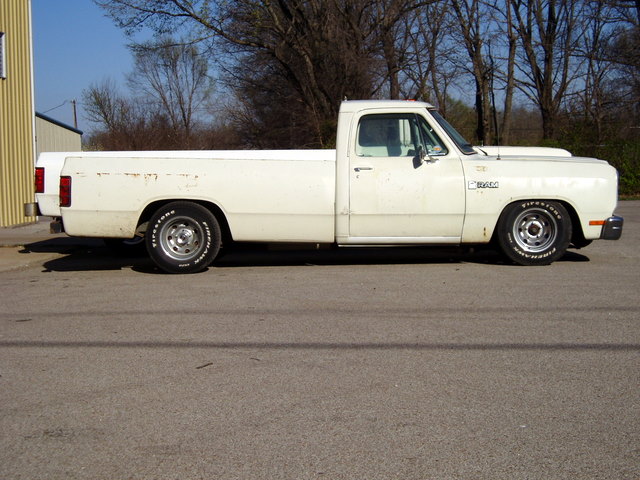

74360Duster, I've got 10" wheels on my '86 long bed, and I've got it dropped pretty hard. At least 5" if not more, and although it's close, the tires still don't rub. If it were too close for comfort, you could do what we always did with our drag cars back in the day, and just turn the fender lip up so its not turned in towards the tire. You'd be surprised how much extra room that will give you.

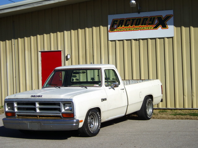

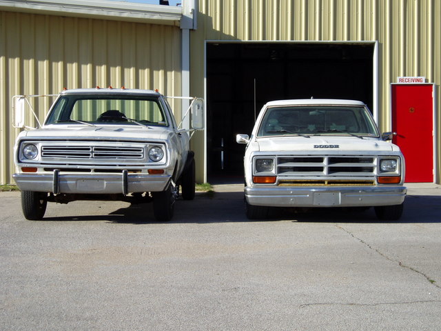

A few shots of my '87 long bed. This was before we moved the spring hangers up on the frame, so the back end is still a bit high. This is not a bagged truck, just custom control arms and shorter coils. In these photos it has Bell Tech spring hangers in the rear, and new, but de-arched, leaf springs with shorter shocks.
It's shown in front of my old carbon fiber composites shop in Tulsa, Ok, before we moved the company to Kentucky. It'll eventually have 17's on it, and I'm going to make my own carbon fiber bumpers for this and my '87 short bed that are narrower, and incorporate driving/fog light locations, as well as an air dam. I'm also going to round the front wheel wells, and build, essentially, everything forward of the cowl in carbon fiber. Hood, fenders, radiator support, bumper & brackets, grill, inner fender wells, etc. If I get really nuts, I might do the doors too...
