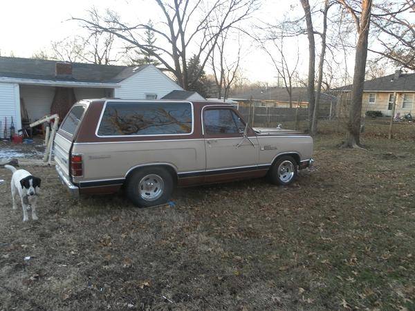

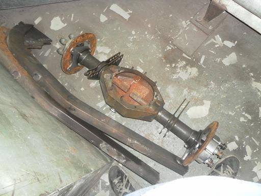

    You can use 1 Ton LCA's & change the balljoint or use Dodge van LCA's & drill the strut rod holes the rear you can do a number of ways. Here's my RC with van LCA's & a rear axle flip

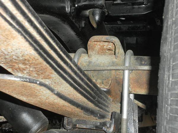

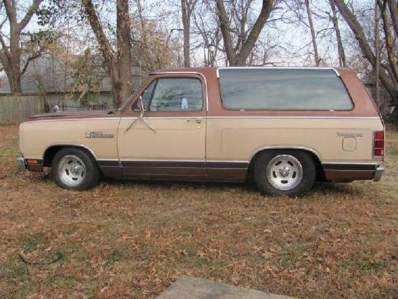

    You can lower it using a combo of different things. A popular way to do the front is using the LCA's along with a modified early Dakota drop spindle from Bell Tech. The rear you can do a bunch of ways flipping the front spring hanger & using a drop shackle for a 73-87 Chevy truck. Flipping the axle the way I did either using weld on perches or using a axle flip kit for a 73 up Chevy truck. How far do you want to go down? Here's the pics of my front & rear.

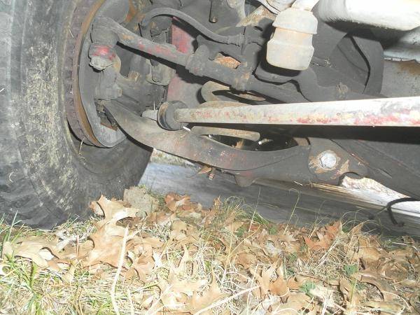

    I don't see what's detrimental the springs. The weight is still supported from the bottom & the size of the axle perch isn't that different. I move the hangers on the frame too to tune ride height or go all the way down with. I move front & rears. How did you move the hangers up use a lowering shackle plus do a flip with C notching the frame? The flip is good for 5" the shackles for at least 1 1/2" the moving the front hanger is good for 1/2 the distance moved. There's 4" of travel in the pic above with just the flip. The van LCA's are good for 2-3" depending on how good your springs are. The 1Ton or 4000# front axle is good for 1 1/2-2 1/2" pictured

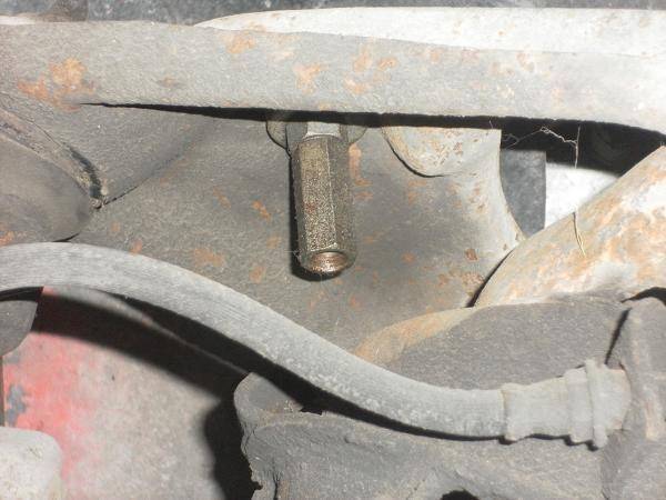

    Here's how I do my down stops to keep the spring in the pocket. This is something that hardly anyone does

    The 1Ton LCA's allow you to use the factory sway bar. Use them with a lowering spring from a 94 up & a Dakota drop spindle & you can go lower than my RC & burn corners.

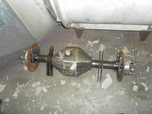

    They make offset bushings for the uppers. I've built uppers too & also moved the mount outward on the frame. The Dak Spindles work well. Balljoint angle does get real crazy either. My next one will drop 6" at least in the front & 10" in the rear with this
