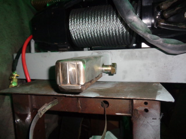

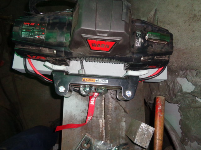

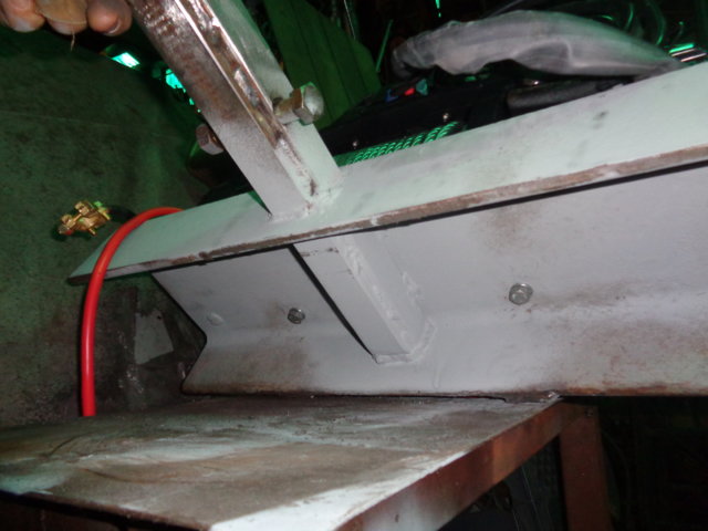

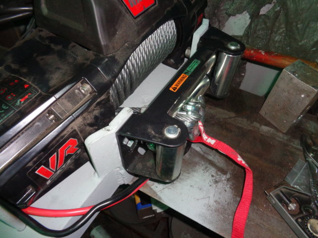

hey guys n gals , i just got done building a tool for my yard full of trucks . i've been selling them off one'z two'z at a time . but my efforts a hard n long pulls . so i built a witch on a stinger for a receiver type hitch . its f.......n heavy duty , 10k lbs 3/8 wire rope on a 8 '' 1/4 thick 1/2 web channel and 1 1/2 x 1/2 bar stock for the stringer and roller mounts . its all mig welded around and three plug welds under the winch spool to the stringer and one plug weld through the end flange of the channel as well . just another junk build . what do you think ?
Looks pretty heavy duty. I only have a 2000 lb for pulling rolling stock around and the garden tractor out when it gets stuck.

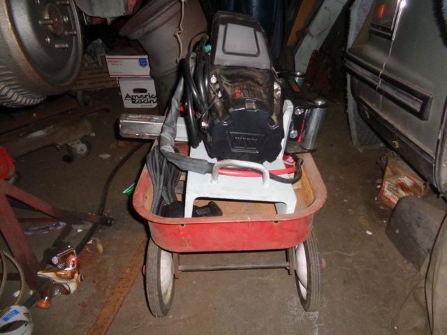

i need something that will drag a f600 or dump truck out of the way or just one that been sitting for a decade in one spot . this will travel around from one vehicle to another . it just needs a cart to haul it , lol .
A cart and floor jack to put it in place

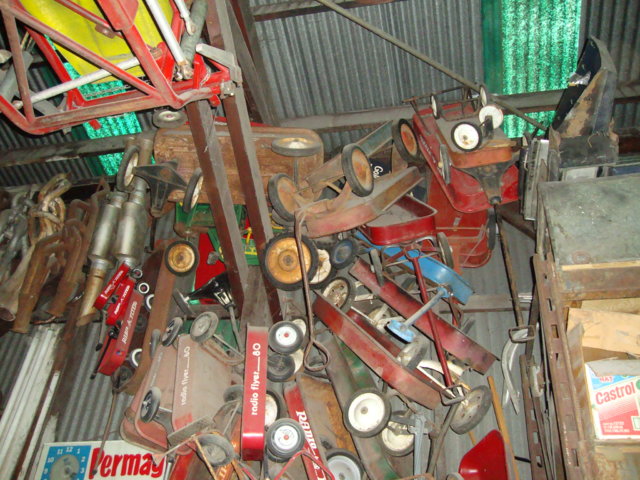

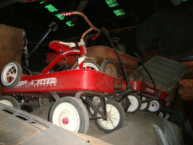

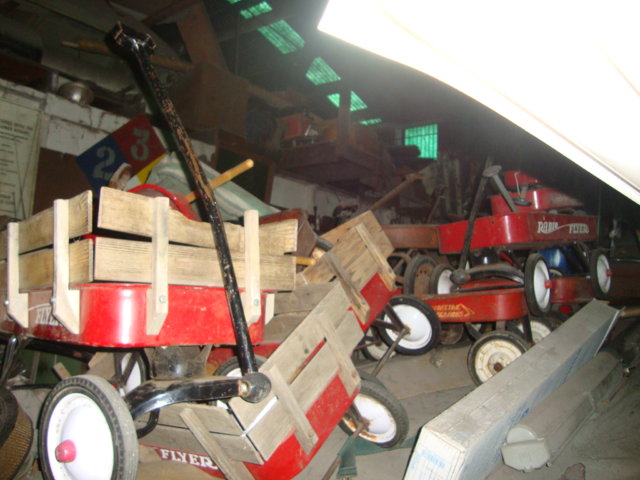

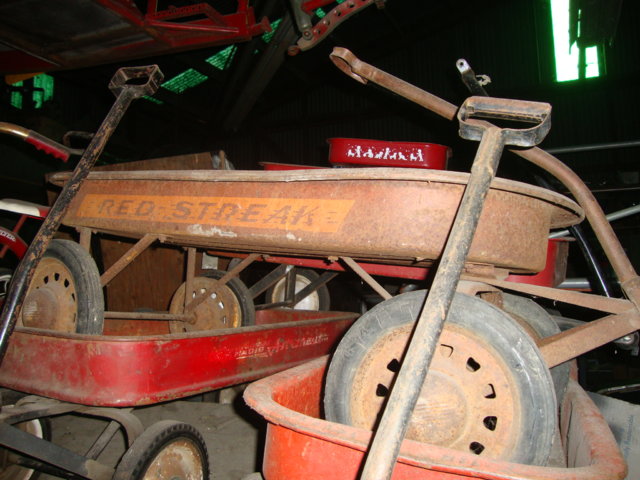

yes its heavy , maybe a wagon , i've got a few . but once located it will stay there . and it can be relocated easier then a whole vehicle could . i'll shot some pics in use soon .

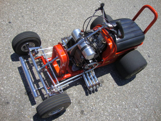

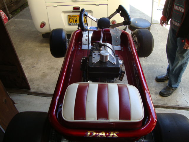

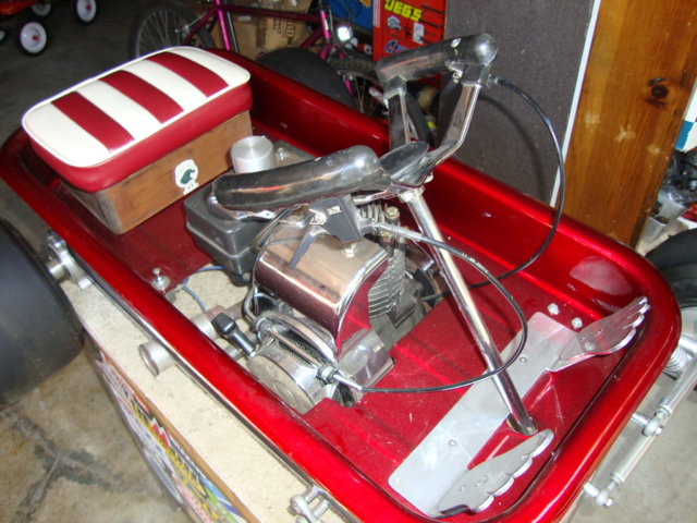

yes , we've built these so far , my candy orange one gets lots of fans wanting pics , my buds candy red one won a few car shows . just pitt racers .
Got one sitting here but I don't think I could get away with doing anything like that to it.
just some go kart stuff a lawn mover engine , a few bucks , wal la , lol . mine was a 60 day wonder . from front axle to paint , and a week of test to break it and redesign before the candy job . note the foot rests changed from motor cycle pegs to the zoomy look , there fold up just like the peds did , mine also has torsion bar suspension on the front . my buds red one is a hard tall , just looks like coil overs .

Looks like a good mobile place to store it when not in use. Can you get it into the wagon by yourself or does it require some assistance?
