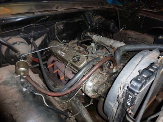

Going back to work on my 1979 Step side

Hi all I installed the motor back in the 79 last weekend getting ready to put the 4.11's and fuel cell in this weekend a special thanks to a member here on FTO for providing me with a manual steering gear that we installed 2 weeks ago i will take more pix and post in a few days And thank you F. T. O. for being here

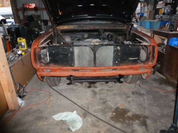

Q" What is the best shade tree way to lower the front it's Big Block (extra weight) I think i can move the spring pad's and lower the rear it's RWD The front sounds like it could get expensive
Thanks BC
Is it coil spring in front. If so maybe find shorter springs in the junkyard
Yes it is coil i was told that i will need different a arms to lower it I have made a little progress had new bearings and seals pressed on my axle's Just about ready to finish body and paint and re do interior need a new cable for my ratchet shifter then i think it will be ready at the stock altitude

Seems a short spring would work if it had a stiffer spring rate. Id pull them and lower the body with a floor jack where i wanted it and see if i could adjust yhe camber? till i had a decent alignment. You might could get a few inches. Then you could see how tall you need the spring compressed.
Ya i will look into that thank you

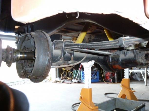

Got my axle's back 411 ls installed 3 inch lug studs clip on exhaust built starting on shifter and drive line then finish engine install and i will be ready for seat's , paint ,wheels and tires almost ready to go a 1/8 mile :}
If you use 3/4 ton 2wd lower control arms, they have a pocket in them. Reuse your existing springs and this drops your front aprox. 2". There is some modifying with the ball joint because of the size difference. There are some articles out there on this swap. Haven't done this swap personally because i raise my trucks, not lower. lol Just thought it might be a cheaper alternative.
Thank you i will probably lower it next build Drag racing season will be over if i don't get it going soon . I WILL BE LOOKING INTO THIS NEXT WINTER Thanks again.
I had a 72 D100 and lowered the front by cutting the front springs. Check Summit Racing to see if they have a lowering spring for your truck.

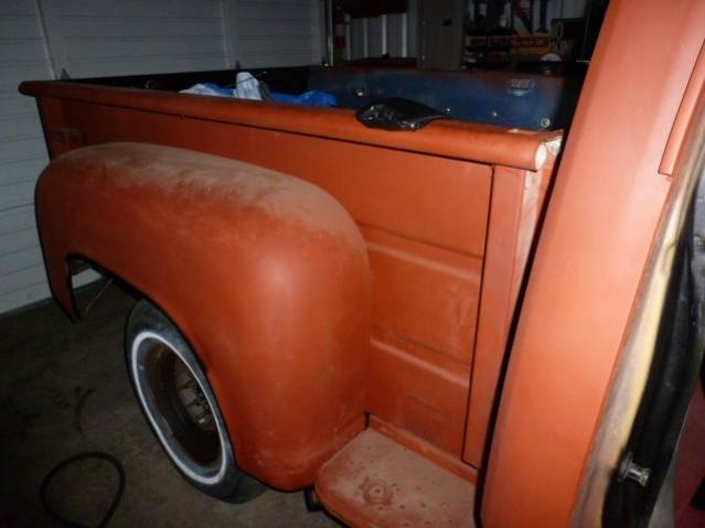

Well..... The step side has been getting treated like a step child lately! I did buy a Carter T Q on E Bay for it that was to arrive no later than 10/11/12 that i have not received yet. It is able to move in and out of the shop on it's own now. It has a Carter afb looking carb with a picture of a horse on the front and the accelerator pump don't work so i have to remove the camouflage (air cleaner) and prime it when i move it. Its about ready for paint and seat's and has been for a while now Darn Drivers are spoiled brats i want this.. i need that,,
