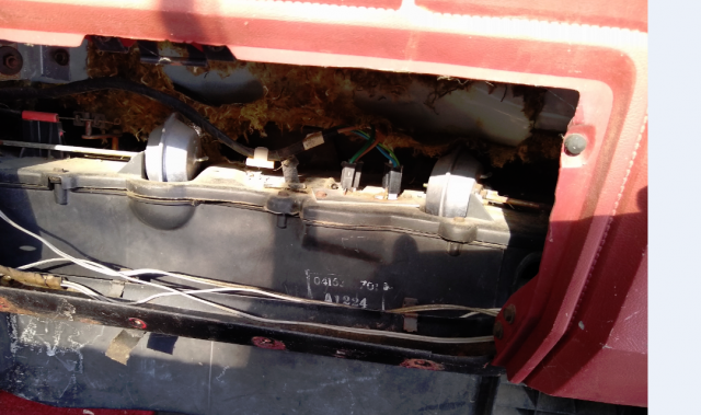

Just went and looked at an 84 w/air, it's in the box (right behind the glove box) as I remembered on my 83. The 87 doesn't have air so not a valid comparo, but I'm pretty sure the 93 I had was also in the box.

If that is in fact an 82 it should be in the box. The resister for an 82 a/c unit is non-existent. Or at least I have not found one. Do you have the a/c dash controls? If this is not an 82 what year is it? Will be critical to have the right year to get the correct wiring diagram.

I'm pretty sure the A/C unit came from an 89.
My box doesn't have a spot for it there?

The 93 dakota resister was located in the engine compartment. About the same location.That is why I questioned the year. It has been years since working on a 93 full size.

Did you get the a/c control from the same truck?
Yes although it had a terminal that looked like it had gotten really hot so Polara500 sent me one in much better condition which was an identical match. I'll did a little deaper into but if it was moved later on there must be a reason. Seeing how there seems to be signs of heat damage maybe the move to the cowl was a safety thing, nothing to burn in the cowl?

On the Dakota I have found the cowl location to be corrosive. Maybe fine if it is never driven in the rain and always parked in side. Think we were buying one a year. the would just rust away.
