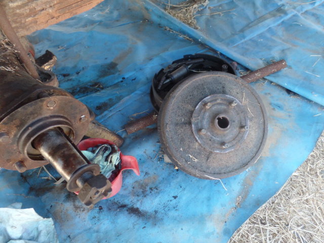

If it would help, I can post a photo of the drum. but in some earlier posts there is photo of the backing plate with all brake parts, springs installed. The drum fits over the tapered axle, and held tight with square key in slot in axle. Typical axle drum puller is used to remove drum from axle.

Wow, a day late. DCM Classics has put four of them in the mail today. They cut them out of stainless steel, and will now stock in catalog. simple laser cut, $5.00 each @.0125 thickness. Appreciate your effort Paul. BTW, someone asked for photo of the drum and parts so I took one today. should have this thing together by end of the week.
