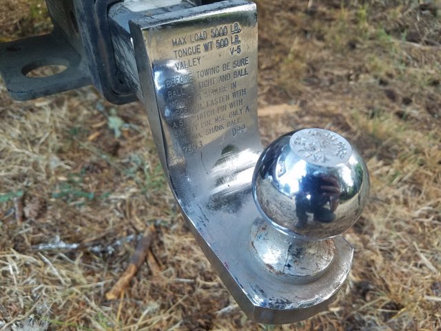

Yeah my receiver has a 1-7/8" ball, but it can be swapped for any ball with a 1" dia. shank. Receiver limits: 5000lbs trailer weight, 500lbs tongue weight

This is my hitch, this pic was with the 1-7/8" ball which I've already swapped to a 2" ball. Punched in the numbers on uhaul's site and they "approved" it (although stating that it still may be subject to inspection). Do they inspect much? What are their "criteria"? In a couple days my trans oil cooler and trans filter arrive in the mail, on top of a good cooler I figured new fluid after a couple years was in order.
See a reciever and ball. Reted at 5000. Should be ok. The hitch itself if a category 3 and rated at 5000 with a 500 lb. tounge wt it should be fine. Will also need at least a 4 wire plug and wired correctly.
Yeah the wiring is the only thing I just noticed that isn't quite ready. It has a 6-way socket but the wires are gacked. Going to town tomorrow to get a 4-way conversion set.

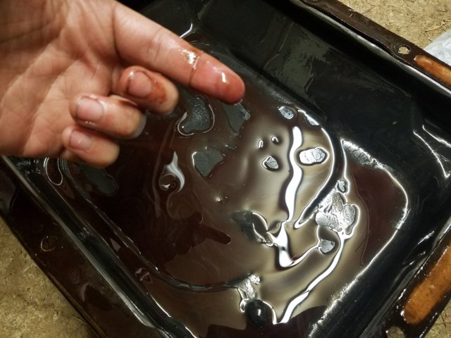

Gave the Dakota a change of trans fluid. Just a simple pan drop and filter change. It's been a few years since it was last changed, but no burnt smell to it and honestly by the looks of the fluid in the bottom of the pan it's still good. Oh well, I already got the pan dropped so in goes some ATF+4. No metal shavings and barely any gunk in the pan, so that's a good sign.

Before that I dropped the trans pan and changed the fluid + filter, but tbh the old fluid was still red and no metal shavings + barely any gunk in the pan
That's a good sign I guess, the trans is good to go.

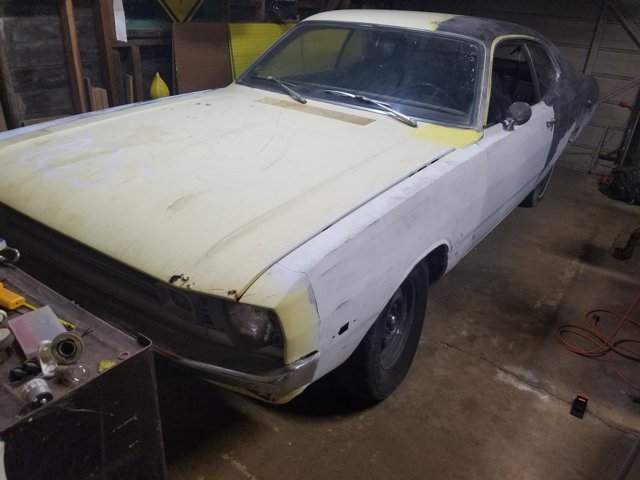

We go check out the car, here it is in his garage
Checked it out, all appeared in order, nothing that wasn't shown in the pics. We go and come back with the dolly and cash in hand, and work on loading it on the dolly. He reminds me it runs, cranks it up and it fires immediately, so we drive it on up and strap it in. I couldn't find anything underneath to wire up the driveshaft to, so I decide little option but to pull it all. Prepared with drain pan for a waterfall, just a little trickle, so I just plugged the hole and put the shaft in the pickup and off we went.

*Here it is in my garage
