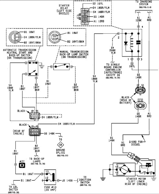

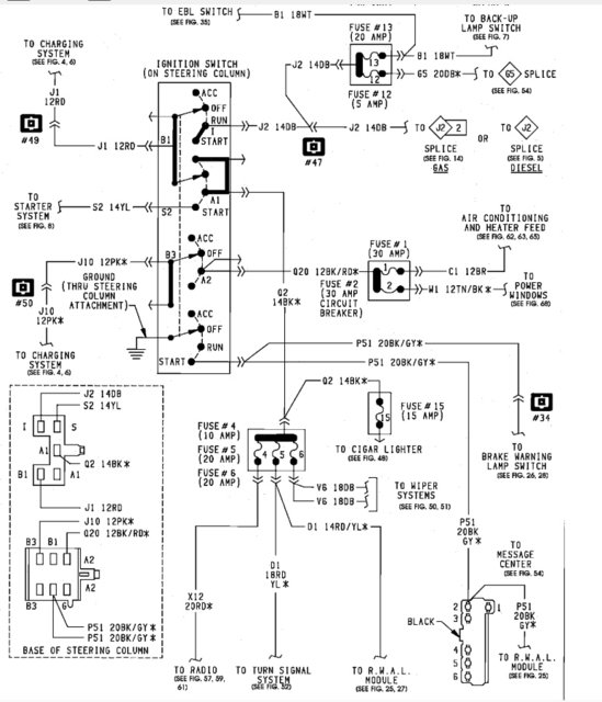

Have 999 trans so no O/D which is fine , just a around town truck for work, but does anyone have the fuse block and ignition switch wiring diagram? Jumped some wires and started right up with no noises and ran smooth so off to a good start.
And looking for cable speedo and cable, mine is electric only.
What year truck? The only thing you need Is a 100-120 foot cable and of course a mechanical speedo.
Just realized It's a 90 d-150 well hear you go
Thanks, that will help a lot. Wiring is coming along, just very slow.
