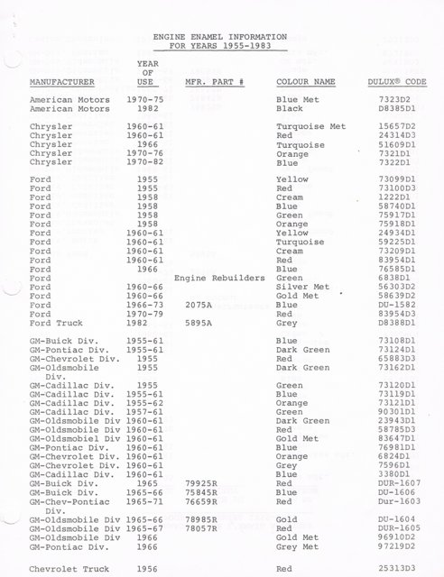

this was posted over in fcbo 59 fury , not sure , but it looks correct .

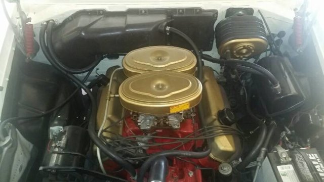

However. I'm thinking now, I'll just go with the Red.. most common, and most expected, i guess. Its not the original engine anyway, and the one in the Fury looks good. Thanks

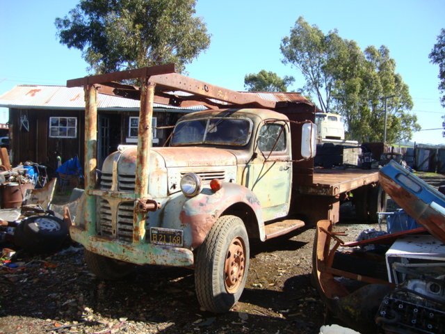

did you see brian's 413 flthd 6 in his big hauler , its a high nickle block and it shines like a nickle coin , has a big N on the side of the block . its in this truck .

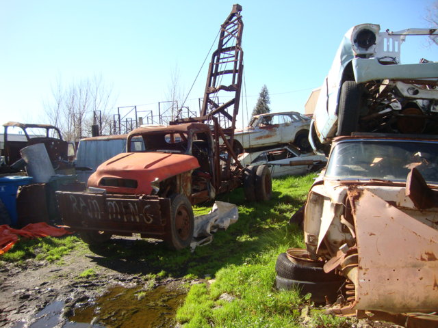

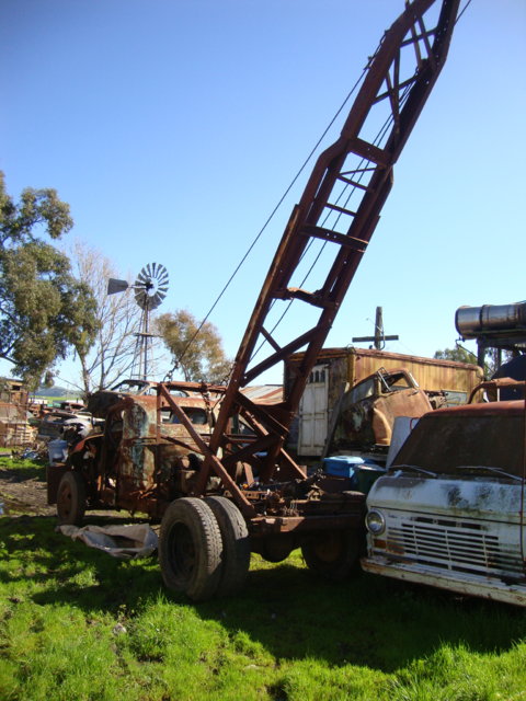

he has a bone yard and haul scrap cars to the mill with that truck . so the over head rails are there to put a car on . funny story behind the truck . he was a garbage man as a young man , drove that truck as a garbage wagon . he went out on his own being a metal scraper . got a call from the garbage co to pick up some scrap . and in a row of these old trucks sits this one he used to drive , it breaking his heart to cut these trucks up . so he says if it starts i'm buying it , well the story had a happy ending . it fired right up he said . so he used it to haul off the rest of the scraped out trucks . then scraped off the garbage truck compacker bed off it . and here it stands today still in running n driven order . heres a couple pics of his yard dog 40ish gmc .
He used that big crane to lift off my 1960 Cab for the w200 truck I'm doing. Only problem was, he did not have all four cab bolts removed and when he pulled up the strap/harness, the left front corner remained fastened. bent the door frame a bit before he realized the problem as to why it would come loose. He has a lot of Dodge stuff there = better get it while you can because the code people are trying to put him out of business.
