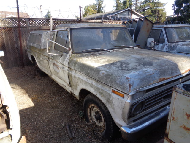

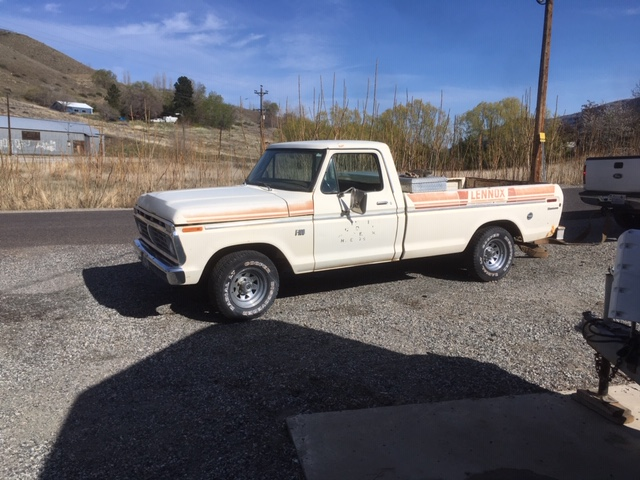

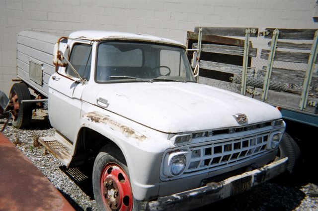

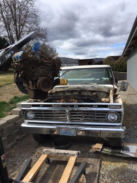

Ok, thought i would start a thread since I am starting a project. Not meant for much other than showing off and tracking progress. This is my truck I started driving at 14. Engine has been blown for almost 20 years. The truck was my Grandpa's, my Dad's, mine, my brother used it when I was away and I hope to give it life again for me and my girls. Let me know what you think as I move along this endless road of truck resto.

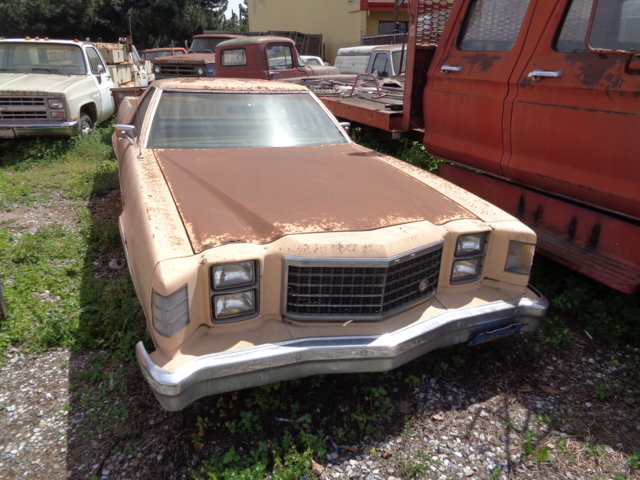

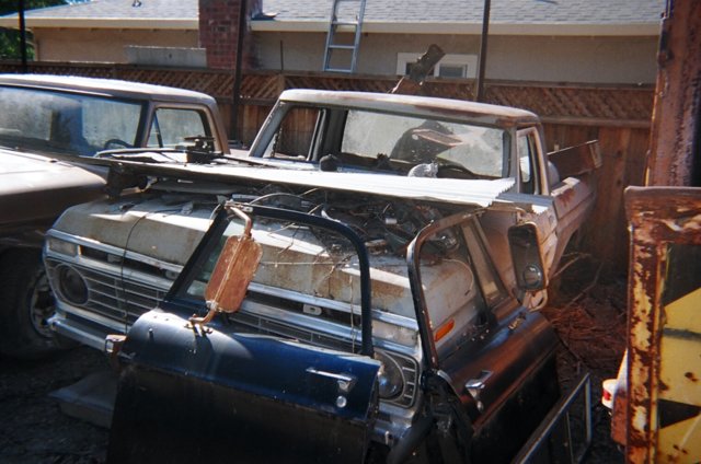

thats great and soon their be learning to drive in it too . great family pickup . keep it going . i've got a few of those hanging out from my dad's old dealership , i just got placed in my lap , so if you need maybe i've got one . trying top sell them whole but time will see how that goes . now my stuff are real work pickups n trucks . as you can see big ones and little ones older ones as well

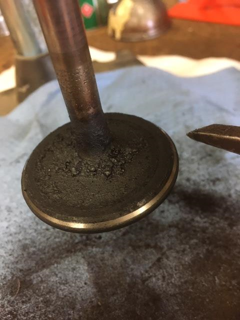

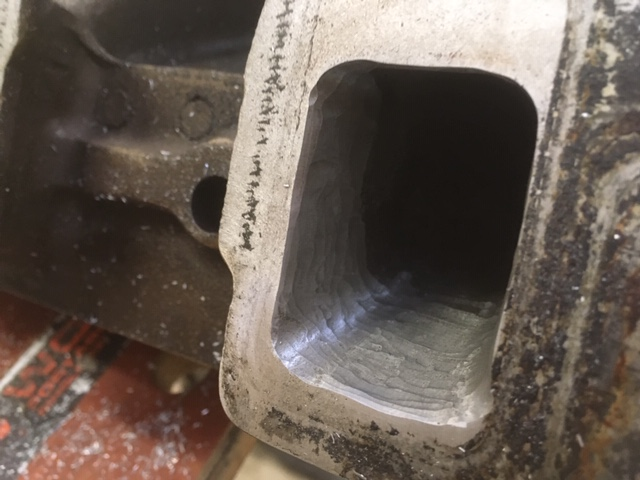

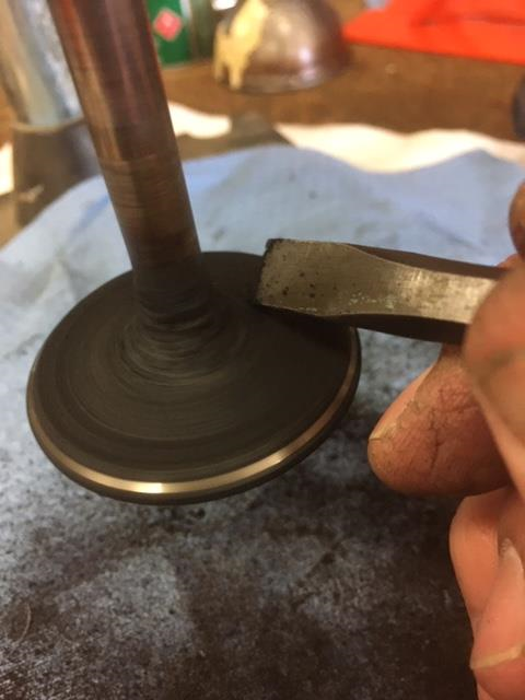

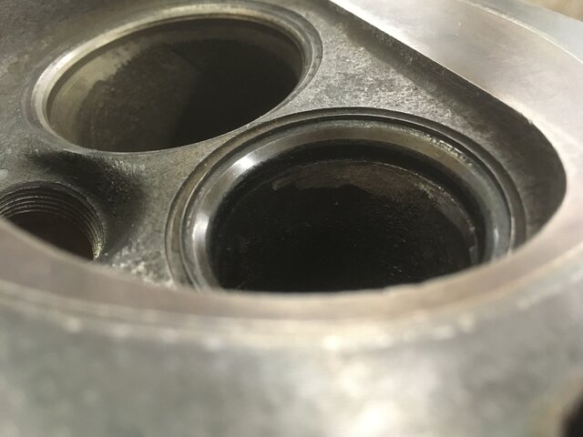

Noticed some rough spots in bowl and an edge under the valve seals, wacked them off too int the grinder frenzy. Funny how much casting slag is blocking the water jacket holes. Wacked them open too

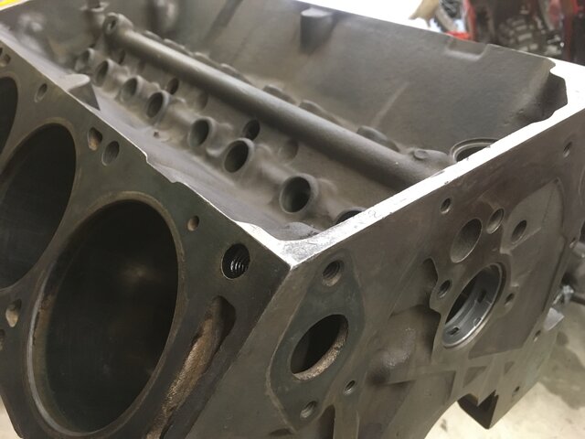

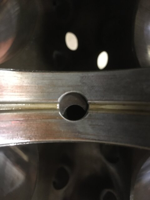

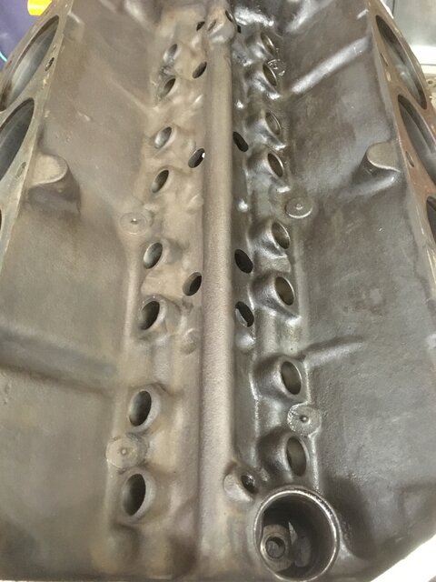

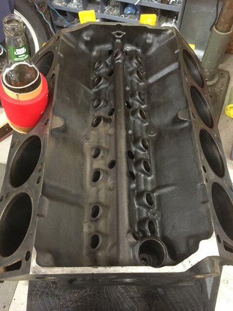

Got the block cleaned last weekend. Took forever but looks good. Used a couple wire brushes razors and ol toothbrushes. Made excellent use of old two stroke gas that was no good for solvent too. So far 0 $

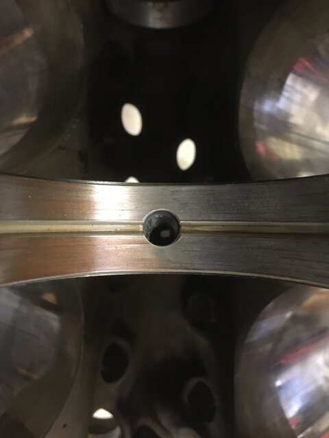

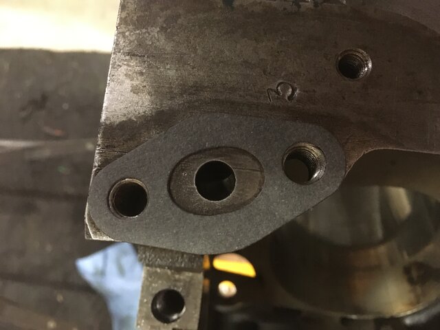

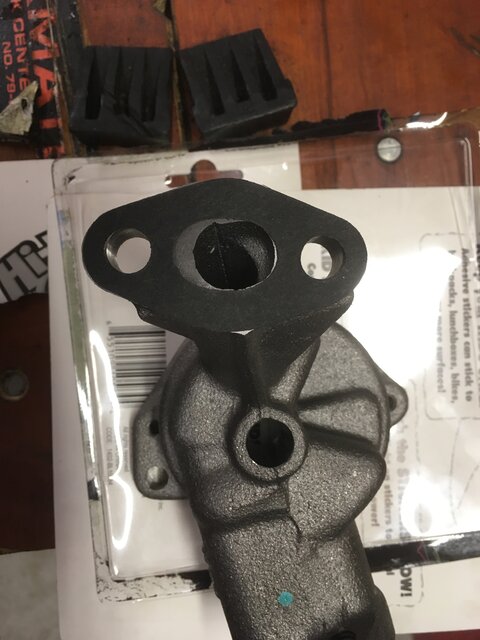

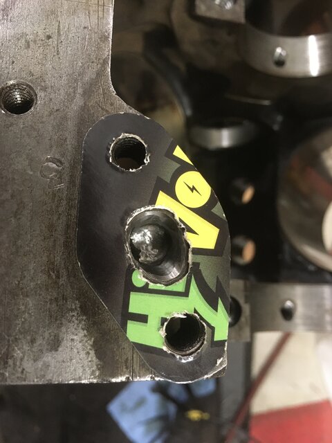

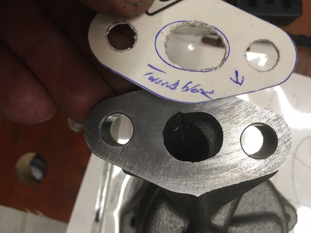

Did you clean the pump hole up some too?
Not yet, I think I’ll round over the hump about 1/4” from outlet of pump. Cast is a lil thin there but I got enough to round the edge. I didn’t really want to open hole on pump to match gasket just to neck down again after it gets in block. Thinking no flat or sharp edges for oil to be pushed into.

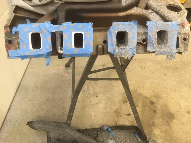

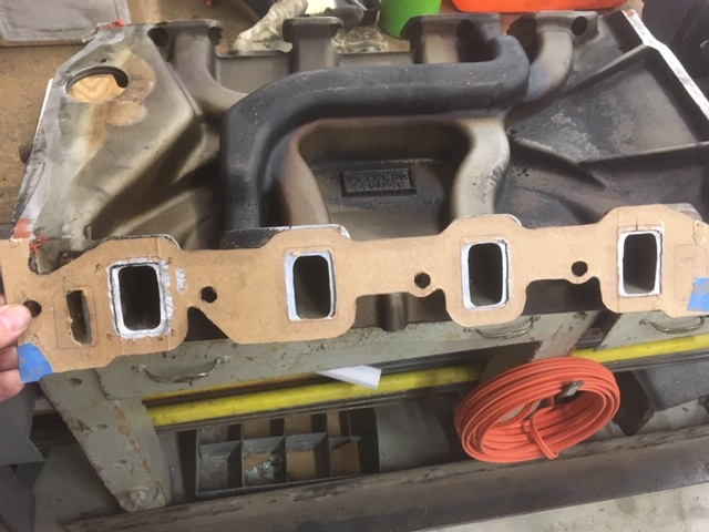

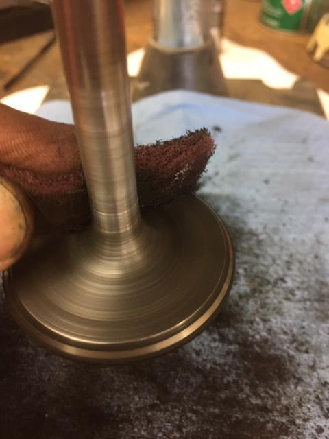

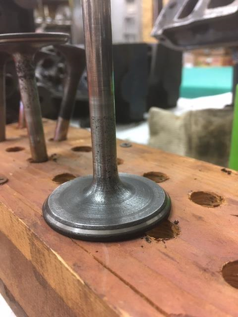

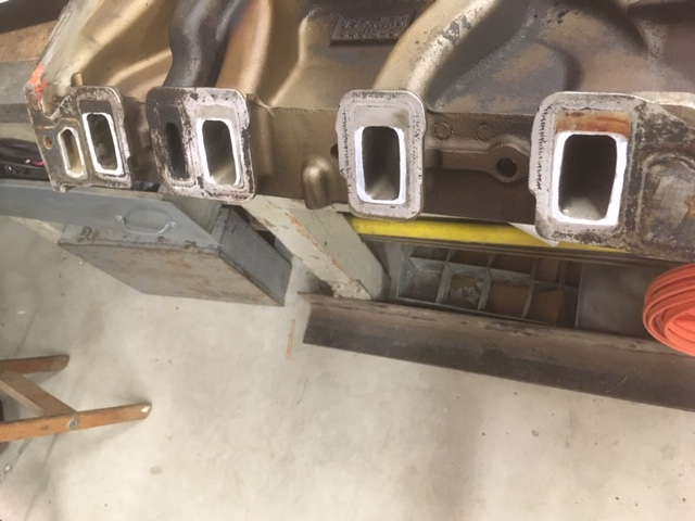

haven't had a chance for any updates but I'm almost done rebuilding the heads and prepping the performer intake I scavenged off a parts 360. Here are a few pics:
