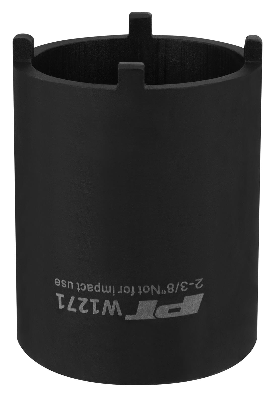

Any pic's of what your seeing? The axle joints are pretty straight forward to change, the seals are inside the axle tubes at the carrier bearings. If your going to tackle the axle u-joints, that would be the time to change the seals because the axle shafts need to be out to remove the carrier. There is a special socket to remove the wheel bearing nuts, there is also a socket that threads onto the spindle to attach a slide hammer to for spindle removal. It can be done without it.
Axle nut socket is like this one

Get the right size nut wrench as they come in different sizes.
