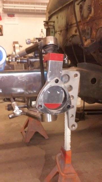

Good news, my buddy finished my new spindles, so now I can button up the front suspension. I finished the notches tonight, so I get the rear welded in, gonna be a busy weekend.

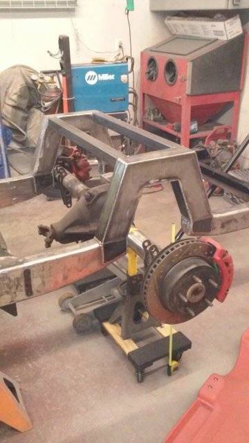

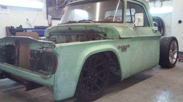

As it turns out Dodge bodies are not exactly level with the chassis. I had been working on a level chassis, but today I dropped it on the ground and the rear was a little low, like 4 inches. Not a big deal at this point since the suspension is not welded in yet. Although I could have gotten away with a smaller notch, it's easy enough to cut them down. The most important thing is the proper stance.
That looks pretty sick already. Should be impressive as a completed truck! Are you actually going to step down into the truck?
lol , I looked at that picture and just started giggling evilly . Mob hit it on the head , that truck is going to look , just plain sick . I'm liking it !

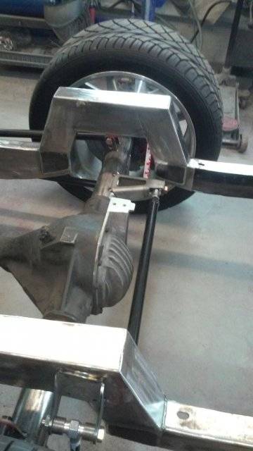

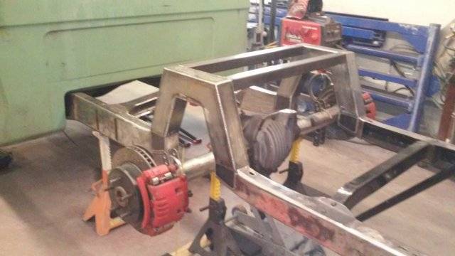

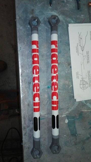

My new shocks came in, they might ride a little stiff...

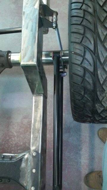

I decided to go ahead and cut the notches down...

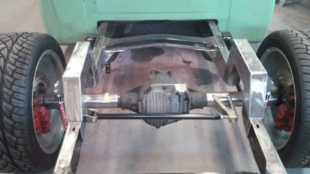

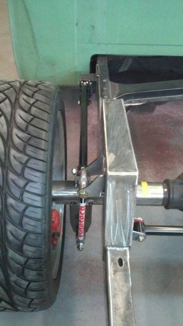

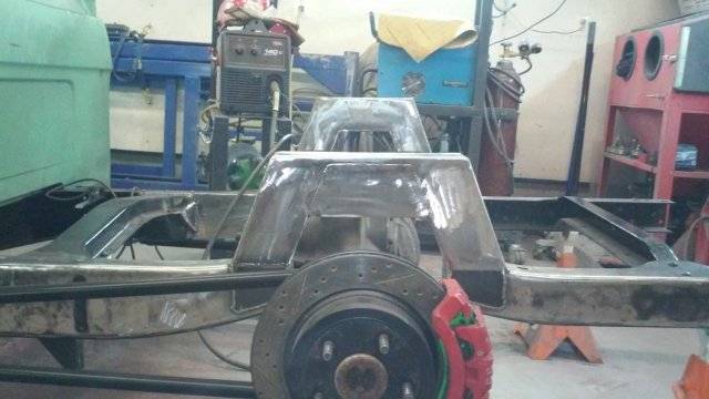

Got the rear completely tacked in. Can't weld it in solid until I determine the correct pinion angle.
Wow ! That's loo'in good ! Are you going to box in any more of the frame right behind the C notch ?
Don't think so, that's where the gas tank is gonna go.

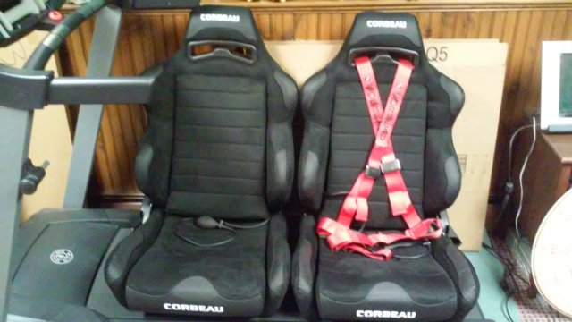

I'm sorry to tell you , but the UPS guy made a mistake . He was supposed to drop them off at my house not yours . lol ..... Nice pick for the seats . :)
He said he was going to your house next.....
