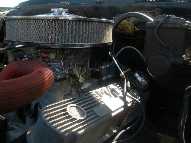

      went with lokar cable and bracket and i am happy with this setup. Easy fix.

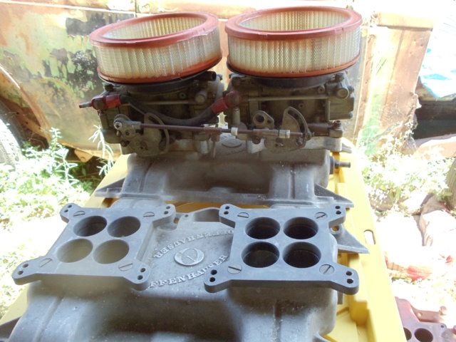

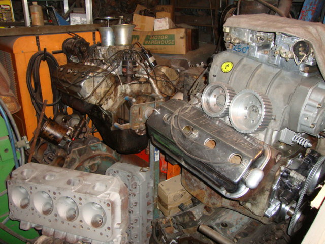

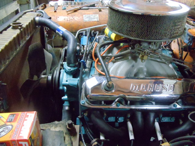

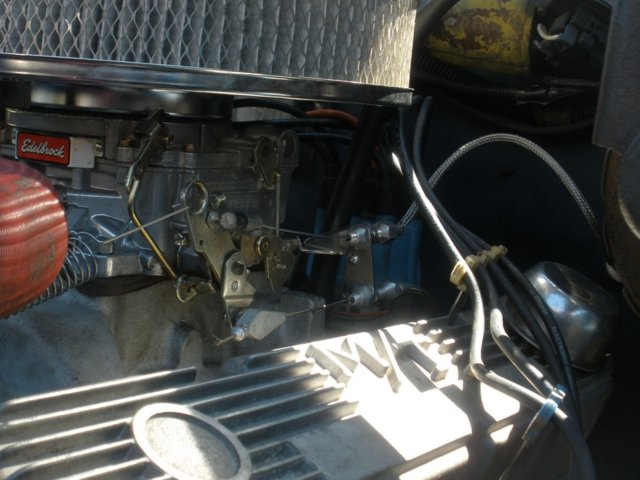

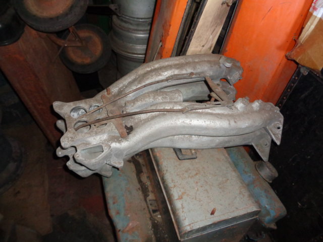

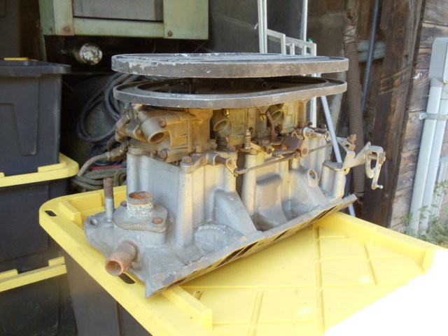

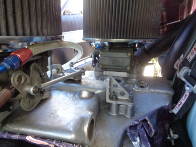

        build your own stuff , lokar is for gm crap . done that stuff , i have just modified stock stuff , enough if rework need some welding . aftermarket has replacement issues and was designed for custom showy not drivers . i've been hot rodding cars for 40 years now . and the stock stuff modifies fine and lasts . DSC09263.JPG DSC01384.JPG DSC04021.JPG

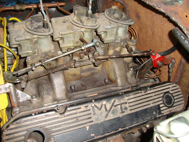

                    i wish i had taken a pic of more of the modified throttle brackets i've built from stock stuff . think about it , your not reinventing the wheel here , just raising the carb , maybe a little forward of the old set up . no duel carbs , no sideways carbs , no blower , no tunnel ram , no crossed carbs , no 6pk . so keep it simple , don't make yourself nuts . DSC09495.JPG DSC00161.JPG DSC00963.JPG DSC00939.JPG DSC01695.JPG DSC00978.JPG
