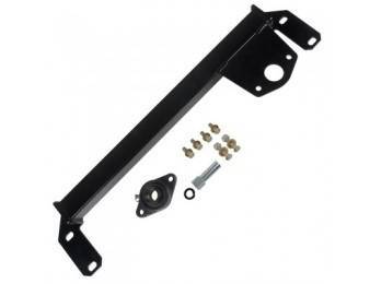

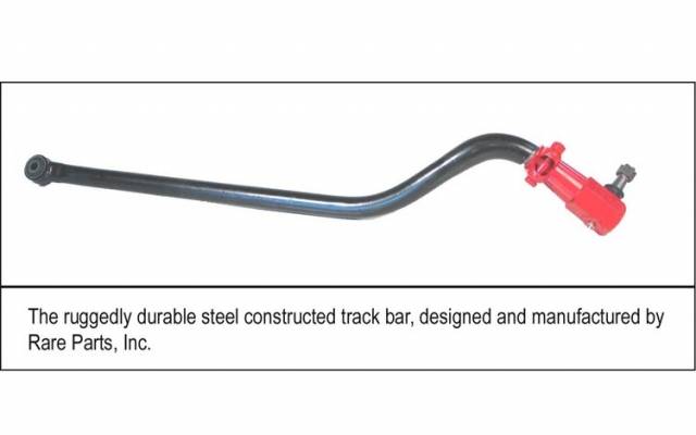

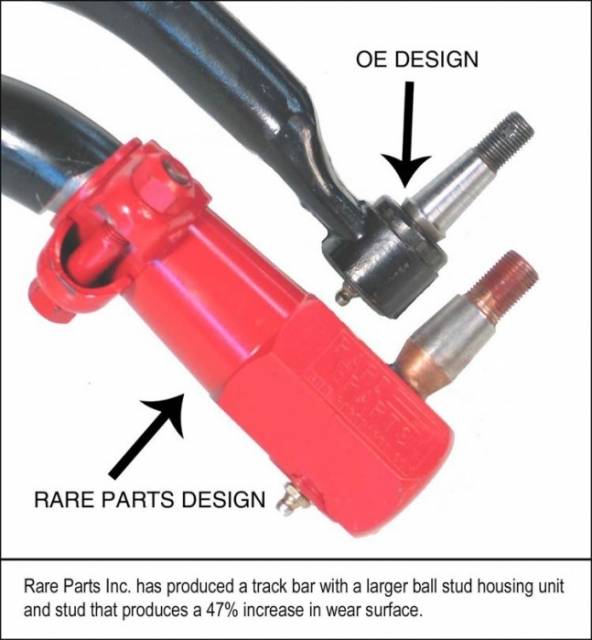

Two more tips for the 2nd Gen 4wd guys. As some of you already know these trucks can develop the "death wobble" and loose steering as the steering components wear over time. My Black Dodge even had this problem being such a low mile truck when I got it. While restoring my Ram everything in the front end was rebuilt or replaced with new quality parts. At that time I performed two upgrades that are well with the extra money and will go a long way in preventing the death wobble! First off I replaced the weak factory track bar with a HD adjustable one pictured below. Then I added a front steering gear brace to help relieve some of the stress it carries. This will greatly extend the life of your steering gear box thus preventing the truck from wandering around while driving down the road.
Obviously there are several manufactures out here making these components. Choose the best one that works for you and shop around for the best deals. I ended up buying my HD track bar new on eBay saving almost $100 over what some of the off-road websites had them listed at. Hear is a link to PSC Motorsports... this is who I purchased my steering brace from http://www.pscmotorsports.com/vehic...-dodge-2500-3500-4x4-steering-gear-brace.html
HD Track Bar
Steering Gear Brace
Very good advice "Black Dodge" ! The Steering gear brace as well as a heavier duty stabilizer is on my two-do list for this year for my Sport . Luckily I haven't had any issue "yet" with this one and I've already gone threw this front end . But I did have an issue with my 95 when I had it . I was on the highway cruising along and then suddenly the steering wheel pretty much shook out of my hands . I pulled over , got out and looked at the front end because I thought the tires were falling off or something . That's what it felt like ! Got going again and everything seemed fine until I hit a dip in the road and here we go again . I limped the truck home and jacked it up and everything was tight . I'm like , what the Bleep ! I even took the stabilizer off and it "seemed" to be fine ? I remember thinking , What could be wrong with this thing , Everything in this front end is only maybe three months old ? Everything "but" The stabilizer . Even though it felt like it was fine , I ran down to the parts store and picked up a new heavy duty one . I figured it couldn't hurt at this point . I installed it and took a blast down the highway . No death wobble , YES ! Two day later , I'm out on the highway again and guess what ? I hit a bump and that darn truck pretty much shook it's self right off the road . Got home again , Cleaned out my pants and checked out the truck again . The new bushings that came with the new stabilizer had deteriorated . In two day's ! I took a picture of it before I tore it apart again and went back and swapped it for yet another one . I also contacted the manufacturer and told them what had happened . They couldn't explain it . They even had me send them the picture of what had happened . They were supposed to contact the auto parts store for the return and have it shipped straight to the person I talked to . I never did find out why this had happened . The death wobble can be a scary feeling , For sure !

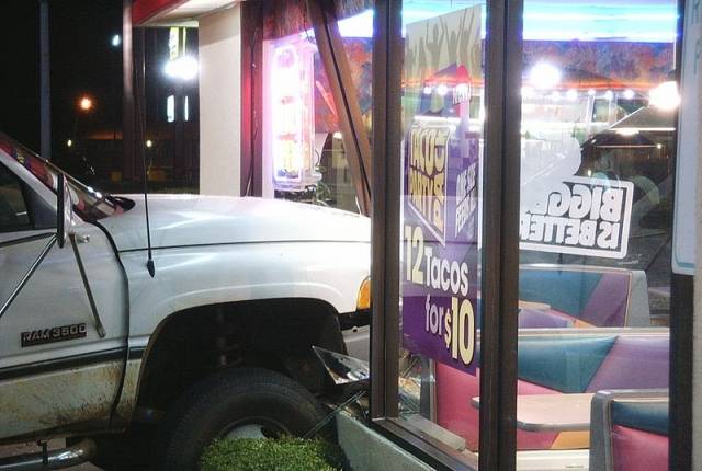

You know I was trying to find some pictures for you this morning of some assembly line shots and I found that truck you just posted . But I didn't see that one ! Maan ! Talk about having a bad day !
Thanks for looking bear! I think it would be cool to see the 2nd Gens being built at the factory! Yea defiantly a bad day for that guy and his Ram!
Looks like this 1 ton owner was really craving Taco Bell! Like they say... If you can't Dodge it Ram it!!!

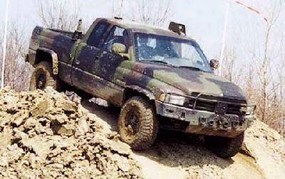

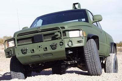

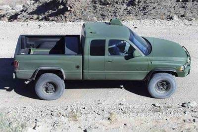

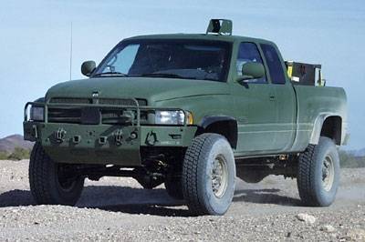

Looks like the military was considering 2nd Gen Rams at one time...
From DodgeRam.org
http://dodgeram.org/rides/combat_ram/military_ram.html
The National Automotive Center (part of the US Army Tank Automotive and Armaments Command) has unveiled the first two "demonstration vehicles" of their Commercially Based Tactical Truck program (COMBATT). These vehicles premiered at the 2000 SAE congress in Detroit. The NAC is testing the viability of beefing up commercial pickup trucks for general cargo and troop carrier use.
The first COMBATT demonstration vehicles are two maximum-performance, off-road pickup trucks. The vehicles used are a modified Ford F350 and a Dodge RAM 2500/3500. Enhancements to bring the trucks up to the new COMBATT standard are:
• Firestone adjustable air-helper springs
• Bilstein variable damping shock absorbers
• extended suspension travel
•Goodyear 37" 12.50R17 MT/R tires
•Hutchenson run flat inserts
• Dana Central Tire Inflation System (CTIS)
• four-wheel ABS and yaw stability management system
• Dana Hydra-Lok differentials
• variable stiffness antiroll bars
•adaptive cruise control
• body and chassis protection
• chassis torsional rigidity
•A 12/24v electrical system
• a black box recorder
• Lockheed Martin Night Vision System with a flat-panel display
• Eaton Vorad Collision Warning System
• a complete suite of electronics for navigation/communication as well as for diagnostics
•A computer/flat panel display to coordinate and control the systems
•an electronically controlled high-horsepower diesel engine.
Tests are being conducted to determine payload, on- and off-road control, braking, ride, cooling, resiliency, grades up to 60-percent, and 40-percent side slopes. Further testing on the vehicles will take place at the Army's Aberdeen Proving Grounds. A decision on whether or not these vehicles will be produced is expected by the end of 2001.
Now that military Ram looks and sounds like one tough RAM ! That fits Dodge's new slogan " Guts , Glory , Ram !" !
