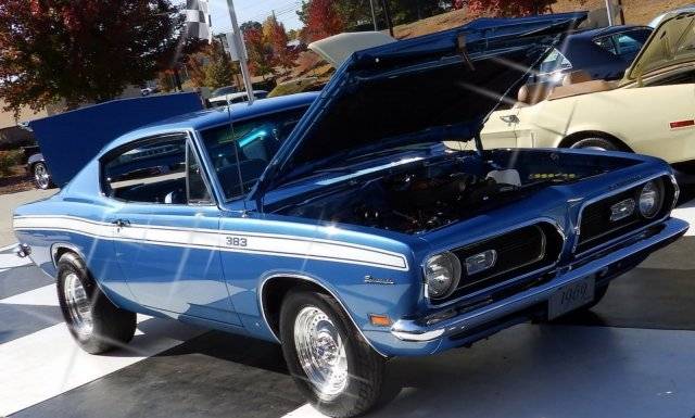

Just got off a 3 year restoration on the 69 383 Barracuda and this is next on the Block.

I figure if I pull the Barracuda to the longer ride shows with the Power Wagon and enter both in the show it will somehow make it less like they were trailered!

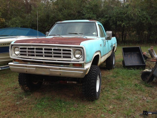

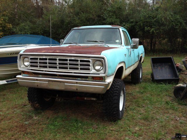

Just like the Barracuda I will return it to what it was! I still have the original rims and with the original 3.91 gears she should pull the 24' trailer and Barracuda with no issues with those small tires and wheels!
Testing the edit feature!!!
The truck had 35's on it to cut the gear ratio! This is good for the hunting use it has been through for the last 15 years but restoration requires return to original!! It should still look fine but more in line with it's new purpose!

Question, did you do anything to get the 35's to fit, lift kit or whatever? I want to know what I can throw under my 72, I only have 33's for it now.

Yes 6" lift in springs only. Had some issues with front DS angle afterwards. Ground some clearance in the front yokes then shimmed the Transfer case a tad to decrease the front angle slightly!

That's a nice looking Barracuda! I don't blame you for wanting to drive that at all!
I was planning on doing a 6" Skyjacker Soft Ride upgrade to my 72. I just have to swap in the 440, do the interior, paint, rollbar...

6" skyjacker is what I did. You likely have the same D44 front axle. My right side spring is clamped both sides. Later models had studs on the inboard side. The new steering arm was a PITA cause you have to remove the short studs and replace and they were well crusted in there. The front springs had angled shims but did not rotate the axle enough for a good drive shaft angle. Longer brake lines are needed as well. It's been 12 years since I did it but can give you some measurement or what not if you need it.
