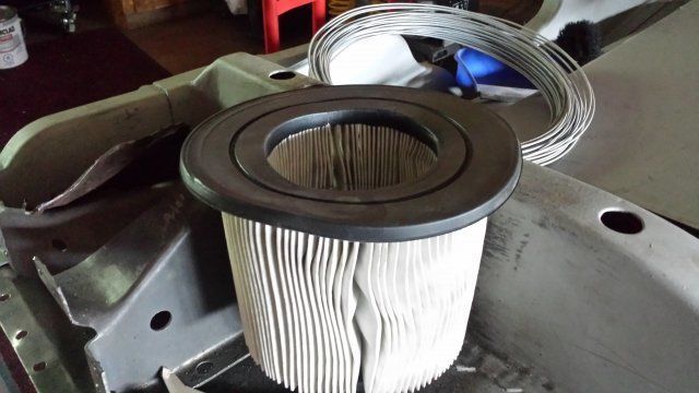

I have a 2008 F150 4.2L v6 and so far I have replaced the fuel pump module, Air filter, fuel filter and added a number of fuel additives to try to cure this on & off again hesitation.
I have cleaned the Throttle body and the MAF as well.
Some days it runs great and others it hesitates under light load.
It had a crappy aftermarket air filter so I thought this did the trick when it ran like a scared rabbit for 3 days.
Also the fuel filter had a high content of H2O when I blew it out as it seemed to be plugged.
