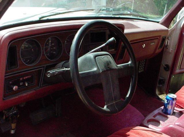

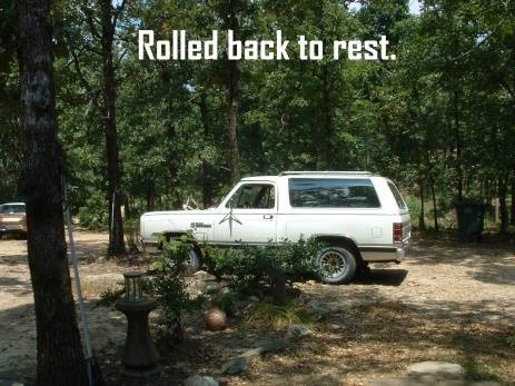

This truck has been in the family for well over 15 years and my cousin had a hip replacment and had to park it about 7 years ago because it lost two cylinders, turned out to be a flattened cam shaft I seen after I had it towed to my home (my diagnosis)
He changed the timing chain and gears and removed them for another 318 he has.
But for $750.00 I was happy to own it and build me a motor for it.

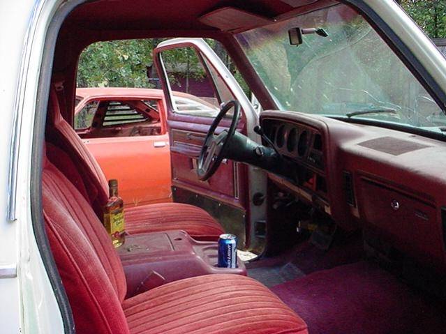

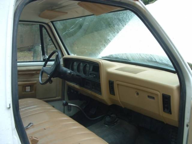

This is a rust free 85 318 a/c cruse control tilt wheel in great shape.
I will be looking for a timing chain cover and radiator/shroud for it soon.
I will be keeping it white and doing a Harey Davison call outs on it for cruising and using it as a chase truck for a local Bikers club to use in fund raisers and vacation and camping time I enjoy.
Doc said no to motorcycle's so this will be the next best thing.

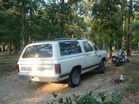

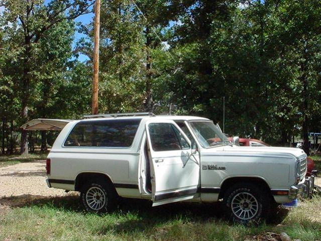

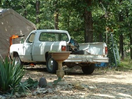

We found a great donor truck :biggrin1:, When I say we I men my younger son Creed.
It is a 86 3/4 ton with good a/c and radiator and shroud and many very new parts on the 318. It drives and sounds smooth and no smoke on it :high5: drove it 45 miles home and Creed drove it to work all this week and he and I can't believe how well it drives, well as yall know I needed everything from the timing gears forward and this truck has it all :biggrin1: Timing cover, pulley's, new alt, new water pump, cold A/C, fuel pump, belts, shroud and radiator. and we all know it's good to have a great running 318 in perfect running order.
Creed came buy after work and got the 318 in my ramcharger ready to pull, exhaust manifold off, starter and inspection cover, fly wheel bolts, motor mount nut's off. Just an update for everyone here. :high5:

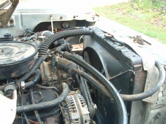

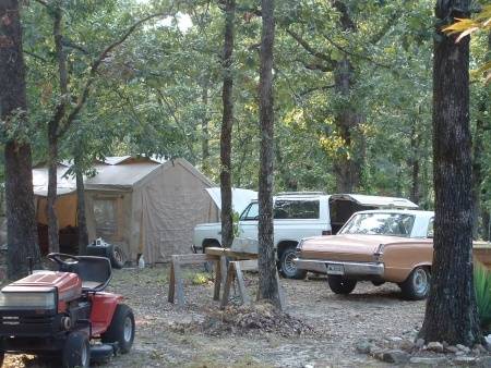

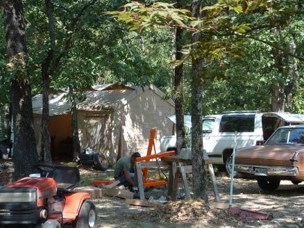

Well Saturday Morning Creed showed up and we made the move on getting the donor engine out and in the ramcharger
As you can see this is a shade tree mechanic work area at it's best..

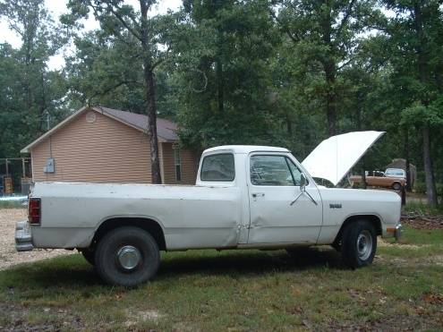

About 5:30 pm Sunday we took the ramcharger for a test drive , Not knowing if the trans has held up ok after a long stored life of just setting (well over 4 years) when I bout it from my cousin about This time last year.
Well the Ramcharger drove perfectly and the trans sounds and shifted out perfect too :first:
You can only imagine the look on our faces as we drove it off the hill and down the road wondering if the trans was still good, It was and what a great feeling.
We had to go buy a trans cooler because the donor truck was a standard and now we will be changing fluids and a complete tune up, plugs, wires, filters, and install this hood on it's first ramcharger It has been on 3 of my trucks and one of Creeds in the last 13 years since I built it with the help of a friend and his plasma cutter and wire welder.
You can only imagine our happiness and it felt good to do some wrenching with my sons again, we have dun many and this is just another memory made to enjoy for years to come.
