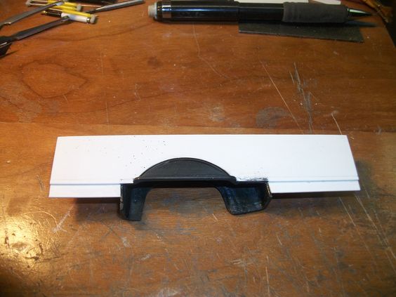

    So then I had this idea on modeling this trailer, and to that, I seeked out extra Dodge Little Red Express Truck Step-Side beds to do this!

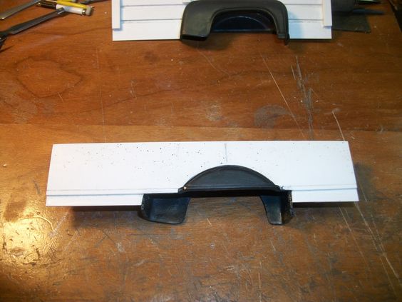

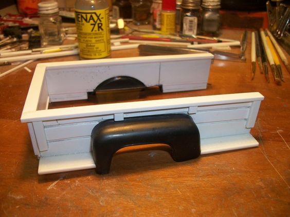

    I took and split the bed down as close as I could with a band-saw..... Removing the "center" of the bed floor/decking.
    I then took and cut the sides completely off around the fenders, and then got out the 1/25th scale ruler to begin making the sides, to fit the fenders once they were all cleaned up.
    The sides? OMG guys those were difficult! The flat sides were OK but the part of getting the contours of a factory Dodge Step-Side bed to fit the fenders and all the curves and contours was a real task! Took a night on each side to get them done! -I even made larger "stake pockets" just like the uncle did (I THINK he used 3x5 steel tubing), an odd size, that he just so happened to have a little of it, what it was for I have no idea but it welded to the out-sides of the bed sides nicely!!!!
    [​IMG]
    [​IMG]
    There ya see both the sides that I made.... I tell ya, this was a FUN 3 days task before your very eyes! (I thought it be an evening or so!) But you guys know How I get with details! :D
    Then the inside? WELL that was a good design of my own, I used the inside of the factory fenders that would have been the trucks inside Bed sides.... I used them to glue the new 10 foot sides too..... Letting the inner-fenders attached to the outer-fenders!!!! (I just had to fit what I was to build around these! -Idea worked out really good!

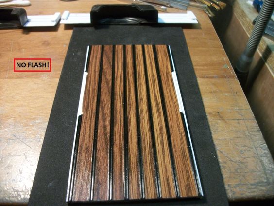

      SO theres a SECRET to this build coming!
      -The way I did the trailer deck boards! LOL BUT theres a bit of a story behind even that aspect of this build, -Like I was asked to do on the real trailer! See, to give you guys an idea of my background, I went to school for Building Trades Maintenance, and that including woodworking to an extent, I've got a Great Uncle on my Mom's side, that was a finish carpenter tho, so I was pre-knowledge'd of woodworking! So, that being side by the time I got into my Teens I had a lot of woodworking tools saws, you name Circular, table, band, jig, scroll you name it all powered! And then the hand tools I won't even go into listing those. then the Uncle that this trailer belonged too, was also a Carpenter, and he had all sorts of other tools and knew I knew how to use them, planers, jointers, you name it, (Tools I didn't have!)
      BUT because he was doing most of the welding, and fabricating, he asked if I'd not only paint the trailer steel frame, but do the wood work it needed an because I knew what I was doing and all that, why yes I did it. I had the use of the garage any time I wanted, and whatever tools I ever wanted needed whatever at my finger tips so. not just during the rebuild of the trailer, but ANY TIME I WANTED..... Just how it was in my family if you knew what you were doing and didn't ruin anything.. I have some of this Uncles tools that he gave me just before he passed away! SO with that, fuels this this build..... (I'm seeking out the parts for the Van he had too!)
      So then with the real trailer being what it was, He & I (My Uncle) went to the Amish, to see what they had for "Rough Cut" lumber.... Dark Oak, was what we found! They had Red & White Oak, but they had this dark colored stuff for half the price and as it is, Oak is Hard Wood so. thats all we were looking for! Something hard to take a beating.... and at to that, that rough cut stuff was a full 2.25 inch thick! 8D -Let me tell ya, did that stuff make his Rockwell Planer GROWL!! BUT it planed out nicely, at getting 2 flat sides smooth to 2 inches thick, and joined the edges to make roughly 2 by 6 planks.... The side were 2 by 8's.....
      Then a weeks worth of weatherizing it came. A floor sealer went on first, several coats of it, brushed on, and sanded between coats, then we laid some old Boat Urethane to it.... in all the planks we used 2 gallons of Boat Urethane sprayed, with an air-less sprayer..... -To give you an idea of what your about to see.....

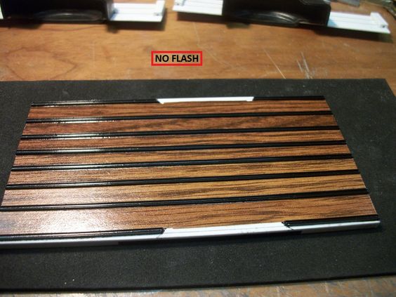

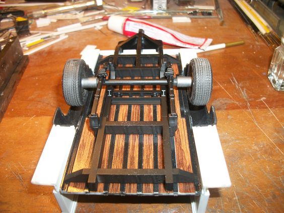

      So that secret? WELL it goes a little like this:
      [​IMG]
      [​IMG]
      [​IMG]
      The above pics? Are of the TOP of the Deck, whats inside the trailer! This is the "floor"....
      [​IMG]
      [​IMG]
      [​IMG]
      [​IMG]
      The above pics here, is the BOTTOM of the deck, this is where all the dirt, road dirt and water would hit from the tires!
      VERY impressed with how this turned out..... I WAS, going to "dullcote" the top of this, and now, it looks to damn good to go and take off that shine, its not to much as a "gloss" would have given it, BUT just enough as the bed sides and fenders will have a good shine on them!
      Thanks for looking, following along, comments welcome, ENJOY!

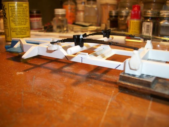

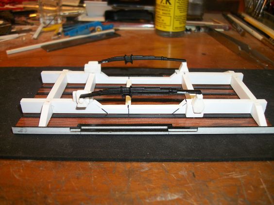

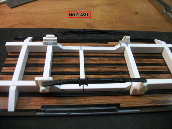

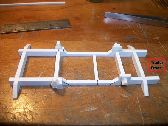

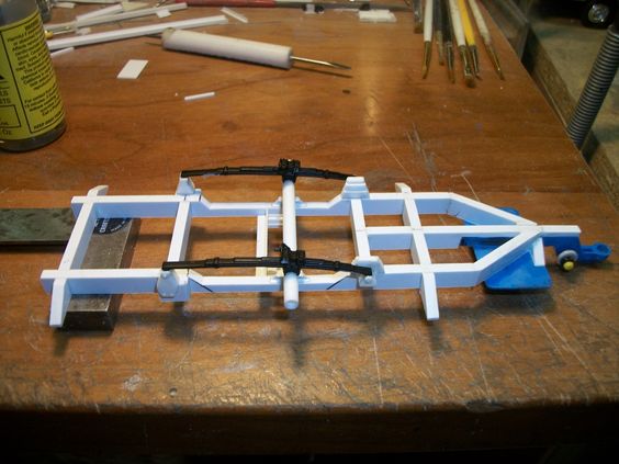

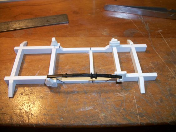

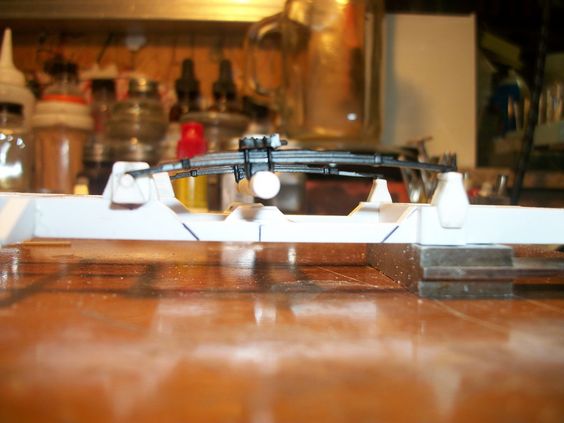

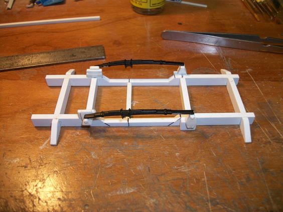

        So to continue on, I got the frame built, without a tongue, and without a rear bumper mount, BUT those are coming!!!! -The Bumper mount however will be done when the bed is in-place on the frame, and the sides of the trailer are on the bed..... All goes together in sub-assemblies!
        The frame:
        [​IMG]
        Seen here, if you follow the frame rails, that run length-wise, in the "wheel-opening" area of the frame, you can see the rails have been machined thinner and have 45 degree angles on each end, just in-front of the suspensions leaf-spring hangers. Frame blocks were added to existing leaf spring hangers I had from a kit bought just for parts! On this frame, to this point, they are thee only "kit-Parts" to this sub-assembly. The rest of that white Styrene is Evergreen Styrene that I had! ALL of the angles and cuts to the Evergreen Styrene rails and cross-members as well as the outer-most "ears" was milled to the angle thats seen, to fit within the beds edge supports for the trailer sides!
        [​IMG]
        Pic showing the "front" of the frame, where the trailers tongue will be mounted once its made! The smallest diameter cross-member, is where the axle will cross, as depicted by the dark black lines on the frail rail sides!
        [​IMG]
        One leaf-spring in-place! Only mocked-up sitting there, as I have a little detail to the frame yet to add!
        [​IMG]
        Now both leaf-springs mocked-up in-place! Frame is looking really good right now! I'm VERY pleased with the outcome thus far!
        Stay Tuned! More to follow right after these brief messages! Thanks for following along!

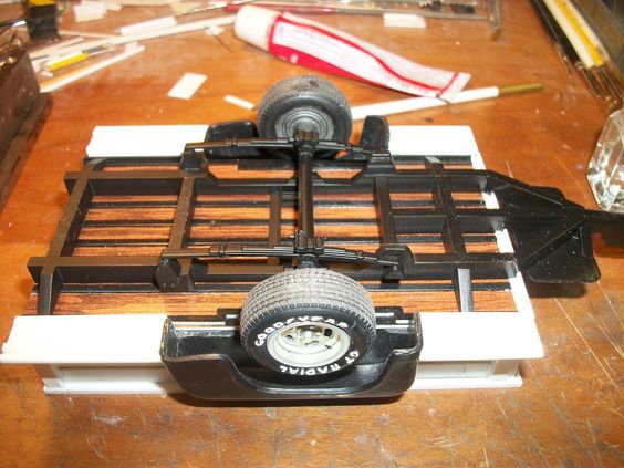

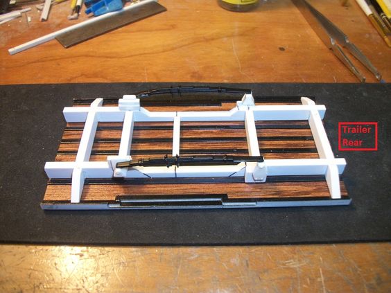

          Then with the frame looking as good as it is, I went right on to see just how good it may looked sitting in-place on the decking!
          [​IMG]
          [​IMG]
          Closest edge of the end of the trailer is the rear portion of the trailer, the shallow in-set of the cross member depicts this! As seen depicted in the following picture:
          [​IMG]
          Then to show close-up of the sides, looking at the suspension where the wheel opening will be, this is the passenger side:
          [​IMG]
          [​IMG]
          [​IMG]
          Then finally:
          [​IMG]
          A semi-Close-up of the area the axle will cross! Seen here is a really thin cross-member. This cross-member isn't for "strength" its merely for adding shock mounts to it from the axle! Which are to be made and will be seen!
          Thats all for now everyone! MORE will follow as I am able to add it in! Its gonna be close, BUT I might make my own dead-line on the "Superstructure" of the trailer being done by Monday, ready for all the extras it will get! I have yet to make all the electrical piping, and boxes for the electric trailer brakes, as well as how the wiring harness will be run to the driver's side of the trailer up to the tongue to be connected to whatever truck or van its connected too at any given time!
          Thanks for looking Comments are always welcome and encouraged! Stay Tuned!

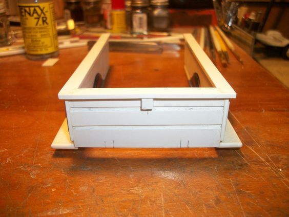

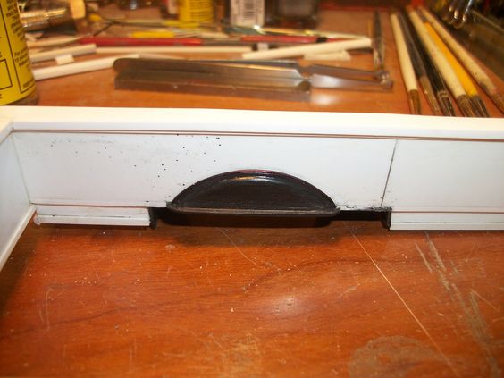

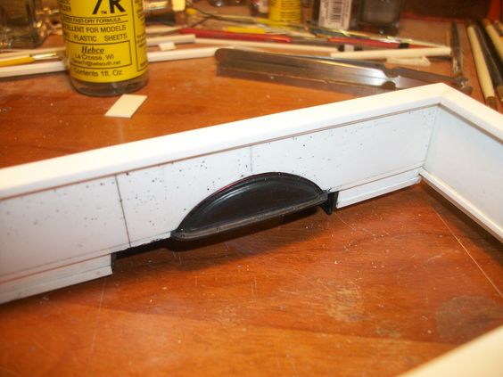

                      So for those following along, I've been right at it on this build! I'm trying to see if I can have this bad boy up on its wheels by Monday! And honestly, I'm so close, but I just don't know if I'm gonna make that dead-line or not but its a GREAT job so far, and is turning out really well! I'm pleased for whats seen currently.
                      I've began assembly of the trailer sides, and bulkhead part of what could be called the "body" of the trailer!
                      So with that, a little more history of this trailer, when my Dad & Uncle were making the sides with fenders, they seen a shot at making running boards too, and with that came a bit of them making a buncha noise inside the garage, slapping sheet metal to be exact! WELL they dug and dug till one of the 2 found some Diamond Plate.... I remember part of this as they took it outside and were cutting it with a Plasma Cutter, along a long section of angle iron for a straight edge.... Then got the mounts made and the diamond plate tack welded to the mounts they made, and then solid seam welded it to the bed sides as well as the fenders! But one thing I remember the Uncle not liking was that really sharp edge the Plasma Cutter left even after being ground with an angle grinder to kid of "break" the edge a bit..... SO, then the 2 of them back onto the Garage, or it may have been in the Uncles shed where he stored things for stuff that was being done in the garage and just didn't want it on the work floor, I'm not sure but they found either it was pipe or some cold roll steel.... I can't remember! BUT they too kit, and welded it to the front edges of the Diamond Plate, and left it hang out long till they ran good weld beads from underneath the running boards. and then when they got all 4 done from underneath, then a lighter weld up top to fully secure it...... I have to give it to my Uncle, ALL the welding done on this trailer as I recall was done by a pretty big Stick-Welder, NOT a Mig "wire-Feed", and he was good at it too! VERY little "grind" clean up was needed! The corners, I ground them to follow the contour pipe or rod they used! (I can't say for sure), but that being pipe and or rod was cut with the plasma cutter on angles so they formed like a picture frame corner on 45 degree cuts so there too was very little grinding to be done and not once did I grind through so. I am not sure if that run-rail was solid or not!
                      So then, on the model, I got right to it! I got a Fire Truck in trade for parts for a completely other build, but it was all most complete so I used what I seen I had in that kit for this build! -A LOT of usable parts in the Fire Truck kit!
                      I got right to assembling the sides to the bulkhead, making sure that they were spaced to fit the floor perfectly!!!! That in itself was a task alone!
                      [​IMG]
                      You can see that the bulkhead had one single stake-pocket in the center, and you can see the markings on the bottom edge for the frame rails to come through after that edge is botched out for such!
                      Thanks for looking MORE to follow these short messages! Comments Welcome ENJOY!

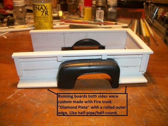

                        Then, I got right into cutting apart that fire truck Diamond Plate for the running boards:
                        Not to bad I say! You can't see it easily, but those running bards are in fact made of scale Diamond Plate, with a rolled edge "Rub Rail"....
                        Then, comes the top of each side and the top of the bulkhead! This I HAD to "fudge" a little bit, one, I didn't have the same type plastic sized C channel the uncle had of the real thing SO, I used what I had, and its a little "thick, BUT, the Uncle I remember him mentioning about making the top of the sides a tad wider then normal, He wanted the "hook" edge on the outside to have for hooking Bungie straps to if needed, and or load straps. PLUS on the inside, he wanted a little more then a trucks bed side thickness, as the trailer was in fact wider then a truck (The model also reflects this!) but in the front by the bulkhead, he wanted to be able to sit a spanning tool box, "Saddle Box"..... -This detail WILL COME later! BUT I wanted to sit the trailer up as close as I could get it for such things.... The parts thats fudged is the thickness of that top.... There was not as much "over-hang" inside the bed as I have! (I had to make up some of the difference, and not create a bunch more work..... Which I didn't do to bad! -I can live with it! As once all the detail is in and around that trailer, this will be come more and more less noticeable as I add details to it!
                        As you can see, looks wide now, but will come to size and won't stick out as big and jump out at ya as you see it now! -I also "capped" the ends, where the C channel over laps the sides but not the very end, so I made a lip for this (I can not remember if the Uncle did this or not), so..... IF not I can live with it, if he did, well then I'm right on the money!
                        Above you can see theres an "extra" lip inside the bed rails at the top.... Thats to fill in the gap from the C channel I had! -Also I used some length of wire, to wrap the tops of each black fender at the joint where it meets the white styrene as it doesn't fit as snug as I would have liked it, BUT it was lose and that wire will act like a weld bead, when its all painted!

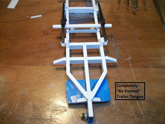

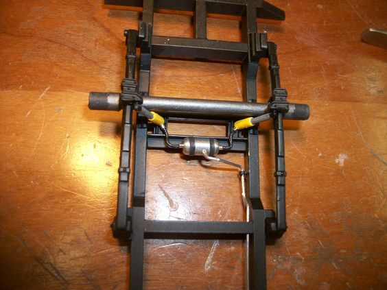

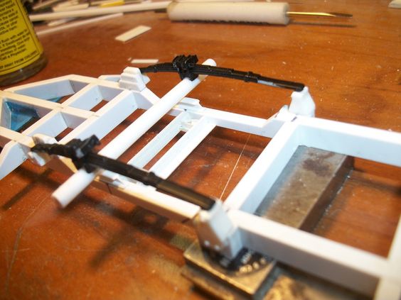

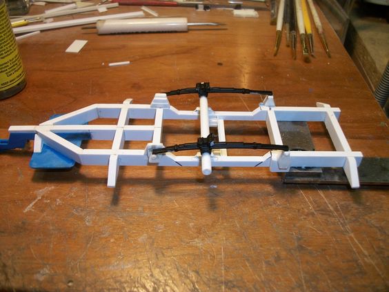

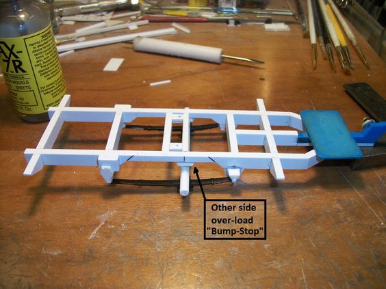

                          So I had an old trailer thats followed me around for quite a while! Its from 1993, that I got in a mess of models way back when I was building years ago, that my Step-Son wound up with for a time.... WELL this trailer he had, that I had built long ago, was in despair..... SO, I robbed what was left of it for parts, and the stuff I wasn't ever going to use, I traded off. The tongue however was one such parts I kept!
                          [​IMG]
                          [​IMG]
                          Seen here is that part! I took the part as-it-was, and left it soak in the purple pond (Purple Power Cleaner) for awhile to get off any and all the paint I could! Low & behold, I never knew it was BLUE!!!! When I got it in parts, if I remember correctly, it was painted silver, and I left it that way on the trailer I had built using it. NOW however that coat of paint had to go! (It'll be painted gloss black when I'm through with it here!) SO, anyway, the original parts of it that were to the frame, I had sliced off, and done one side at a time, to get the angles right, to the frame I custom made for my trailer seen here.... I sat most of it up the same way, altho, this time around I totally scratch built the frame this time, the old trailer's frame was built using parts of an old truck bed, that too I still have! (May use that on a long bed, or an extended cab truck at some point!) SO, with all that said, I went on to save the "plate" to hold a tool box my Uncle had in the front of the bulkhead on the tongue.... As well as the cup-hitch! I will be making a NEW "Dolly" were the pin is seen, just on the other side of where you see it here!
                          [​IMG]
                          [​IMG]
                          Showing the trailer frame right-side-up, and the blue plastic of whats left of the kit-part tongue! -Notice the "Dolly" is on the wrong side! Also on the real trailer when the Uncle had re-done the frame and replaced parts of it, (The tongue being one of such parts on the real trailer) It was pretty much rusted away strong still BUT he didn't want to trust it that way, and put on a new one! The straight part of the ball-Hitch cup and neck was left, (I'm NOT 100% sure the whole drop amount is right, BUT the uncles had this! Sadly, I won't be changing it once done, BUT will have to make the Van its coupled to reflect the level height of the trailer! Easy enough! BUT when my Uncle went and replaced the ball-receiver end, he ran the straight part down to the 2nd cross-member into the trailer frame, for strength! -I did it in section, he did this all one piece! This was done for a few reasons despite brut strength, but he not only used this trailer for carpentry as I said, he also hauled in scrap with it too, where it could get really heavy! Even for Carpentry use, hauling that trailer full of 3 quarter inch plywood, stacked all the way level to the top of the trailer sides, I BET got pretty dang heavy too! I can't image that same load with the plywood being replaced with 5/8th thich 10 foot sheet rock! YIKES! SO, with knowing this when he was making/rebuilding the real trailer as I was wire wheeling off the frame rails, and getting them ready for primer and paint I asked about that. Because it was in fact difficult to get in there with a 6 inch angle grinder with a steel cupped wire wheel.....
                          [​IMG]
                          [​IMG]
                          I also added "Bump Stops"..... -If the trailer did in fact become over-loaded, the axle would sit right on these and ride without hurting anything! I do however need to add 2 over-load springs and stops for them as well! They're to come! (IF I have what I need to make them, they were only on the back-side of the axle, about half way between the axle and the "normal" leaf spring mount!
                          • Like Like x 1

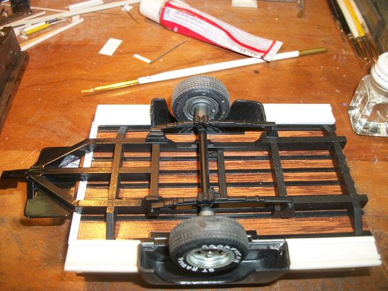

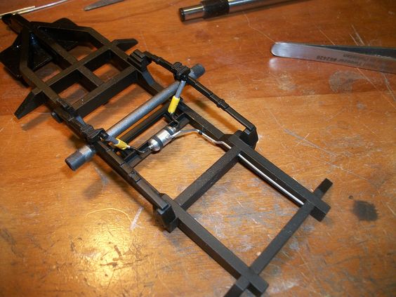

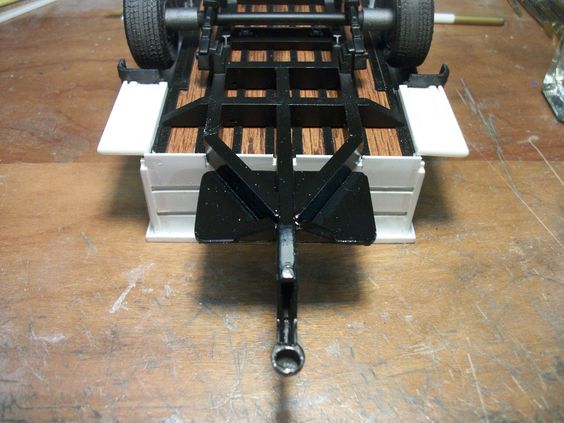

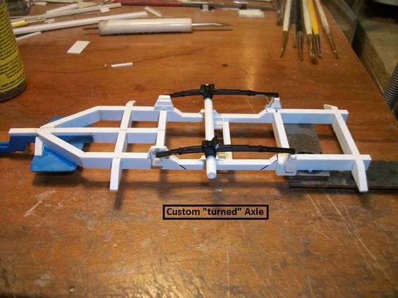

                            A few extra's of the frame, up-side-down to show over all detail so far:
                            Then in the past few postings, I didn't mention the axle, it was custom turned on my Unimat Lathe to fit the trailer, as the one I had one, was to "light" and 2, it needed to be longer..... SO, I made a fresh new part!
                            Its in-place to stay! Will get painted along with the frame, BUT I made go a tad further and do the axle like that found on a House-Trailer, like seen in a Trailer Park. As my Uncle had replaced this with one of those that was slightly modified to fit this Utility Trailer as the House Trailer axles he had were really wide, to wide for this application, BUT I recall, those being cast iron! Cut down and a new cross-axle put into the housing with new spindles and rotors and electric brakes!
                            Up-Close & personal.... This shows that I built the trailer suspension to be "pre-loaded"... as it will have stuff in it and I can only guess the gross weight unloaded of this trailer so. (I really do not know what it was!) So.... I modeled the trailer suspension to reflect being "loaded".....
                            Showing the position of the axle above the Bump Stops.... For what they were for..... When I got to adding the over-load leaf-springs, I'll make them reflecting this too, that they're almost touching the "pads" for them as they slide back and forth as weight is added or removed from the trailer....
                            Thats it for now! As always comments welcome and enjoyed! Thanks for following along.... ENJOY!

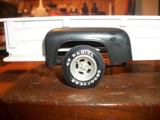

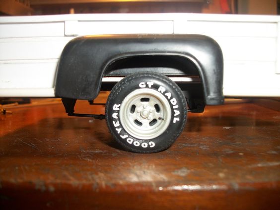

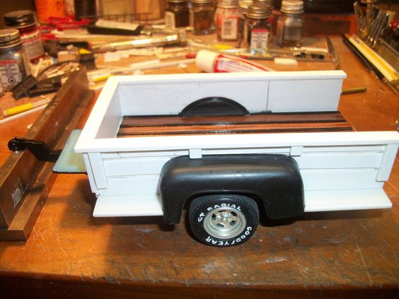

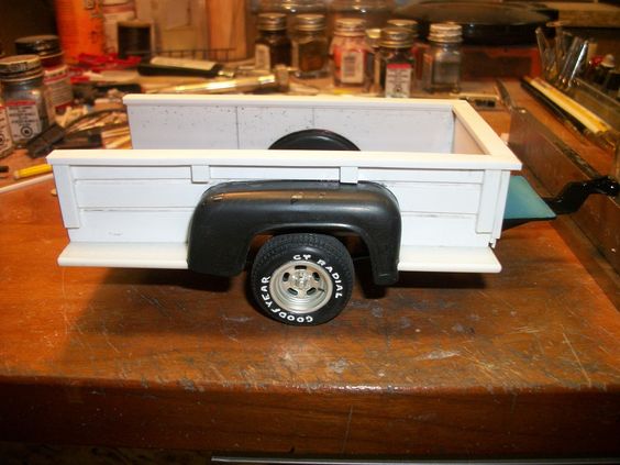

                                Well to give you all an short and sweet update, The trailer is on its wheels, sort-of..... I got the frame painted, and the wheels all made up, and got them in-place as a mock-up.... The bed sides and fenders didn't get painted yet and there is very little detail on it, BUT that all will be added slowly, depending on how fast things happen (I have to admit, the deck, and sides went together rather fast, more so then I expected it to happen! BUT, heres the result so far:
                                On its wheels I say! Looks GREAT too even tho it look even better if the bed sides and all were painted! :D ANYWAY, notice the plate in the front over the tongue? the top side isn't painted, I will be making a "Job Box" type tool box to be mounted here.... Then the wheels were Aluminum slots that my Uncle had, and he used whatever size tires he had spares of that were of matching sizes to fit the rims. SO, I used a pair that came off that original trailer I used/robbed of its parts, so I kept the tires, and wheel backs! I replaced the rims from them and traded the others off, and took an broke up a set from one of my Little Red Express Truck builds not getting the slotted rims. Those rims however aren't exact, to what my Uncle used, but are close! He never really polished them, thats why the chrome was made flat to look like unpolished aluminum. I also added valve stems, and thinned out the back of the rim for the slots to show up a bit better as well as paint the wheel backs flat black to be seen through the slots! -I then took and done the raised white lettering with my white Gel Pen! NOT done "perfectly" as its a trailer, the lettering would have been worn so I wanted that slightly "used" look. I also spun the tires in my lathe to make the tread look "used" as well.... Put some miles on that baby!
                                Up close of the tires and lettering work! Looks really good!
                                • Like Like x 2
                                • 67 Power Wagon
                                  67 Power WagonWell-Known Member
                                  Messages:
                                  743
                                  Likes Received:
                                  182
                                  Joined:
                                  Oct 5, 2015
                                  Location:
                                  Hell,NH

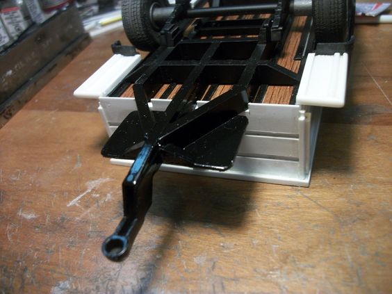

                                  So a little more on this build for today. I got it on its wheels, as you can see, but thats only a mock-up of what it'll look like so then I got it close to my goal. BUT there is a lot of details to go as well, I need to add the electric brakes, and wiring, as well as the air lines to the air shocks my Uncle put on this thing. BUT thats all pretty simple, as then I also need to paint the axle to match the wheel backs! Cast Iron looking color!
                                  The frame however, was painted flat black, and let to dry, and once dry with a piece of paper, I went and gloss coated the tongue right to about the area it would go under the trailer bulkhead! As the frame under the "box" was undercoated, and the tongue was painted with a commercial gloss black on the real trailer. So I did the model to reflect that! I have to "clean" it up a bit yet, but that will be pretty easy!
                                  Got a bit of detail to add, but as-is, it looks GREAT! I'm pleased with how this whole thing turned out and how fast it went together. But, thats what shows in the thought process when you build, a LOT of thought went into it a long time before the project ever became reality!
                                  One thing I'll mention on this if you look closely behind the wheels on the fender edge where the black part meets the wood grain nearest to each wheel on the inside, the deck needs trimmed to fit properly (It fits now, BUT the real one was "trimmed" to fit the bed and fenders, so I will be making that happen when I get a little further on and the deck is in-place to stay! The inner fenders were undercoated that same flat black undercoating, so when I trim that area, it all will be painted flat black
                                  Good shot showing the "wear" on the tire tread!!! -I'll also be adding mud-flaps to the far edge of the fenders. I have yet ot think of how I'm going to make those.... Nothing in parts I have would do, plus I don't think I got any "Mud-Flaps" from a kit so.....
                                  A close-up of the tongue and ball-hitch receiver. -Notice the "dolly" mount that was on the blue receiver is gone!? It was on the wrong side for this trailer! I will be making the "Job Box" tool bax for that plate on the tongue, BUT I have to say, that its going to be a bit bigger then the plate you see.... It almost spanned from one corner of the trailer "box" to the other! Did NOT go out past the box corners tho.... Thats gonna be a fun little detail to make!
                                  A close up showing the cuts out notches in the lower bulkhead plating, where the frame comes through it.... That whole bit, looks and is just like how the real trailer was! I'll be adding a wiring harness for lighting, and I got to add tail lights and brake lights yet and all that fun "finish" type stuff, I just got to see what I have (if anything) for the tail lights, I'm not sure I have anything "close" to what was on the real trailer, I'll be digging tho, to see what I have for options. (I WISHED I had pics of this trailer in real life), and not all from memory, as things can get skewed a bit, like the lights I just mentioned... I remember them being "square" and thats about it.... As I had to tape around them to paint the trailer sides and all so....
                                  Wait you guys following along...... Theres a LOT of details for this to come! I just wanted to have it done as a OOB type thing with a little details on it by today, I got close!!!! I'm not complaining tho, it was a blast going the rate of speed I was with everything I've put into it making it as close as I could to the real trailer.....
                                  Thats it for now! More to come as I get it done! Thanks for following along, Comments are welcome, ENJOY!

                                      Then I left both tail light fixtures sit and dry goo, (I still as of this posting need to paint them!) BUT that allowed me to have a look at the frame and see what all I can do to it that it can have "some" details in it and not just a plain undetailed frame....
                                      Now for whats to be posted next, A little idea as to whats going to be seen. The real trailer, that my Uncle had, was rebuilt from an existing one, so with that, he had added air shocks to the thing..... (I remember my Grandfathers '77 Volare on my Moms side having air shocks too.... SO kinda interesting to have the same sort of thing on the trailer!) SO my Uncle had seen how my Grandfathers car was with them, and he sought out looking for a half ways decent set of them, I can't remember exactly how he added them to the trailer, so. I knew he said he had to run piping, and hoses, and added a small tank to the back-side of the shock mounting brace between the frame rails.... I built the trailer to closely follow what I remember of the frame as I wire wheels the thing and painted it, but I had little to do with the frames parts, such as the air lines and even a lot of the electrical wiring due to the time it was done I was painting the sides and fenders at the other garage I worked for..... Then when the trailer sides and fenders were done, the Uncle simply pull the trailer to the other garage, and park it under the sides and all to be lowered onto the frame and bolted in-place! So really all I got to do as far as frame parts other then getting it ready for paint and then painting it was wire in the lights from the fixtures after I bolted the fixtures to the mounts!
                                      All I can hope for with the following detail is that I got it right! I think it be close tho.....
                                      [​IMG]
                                      The air tank is in-place! Also seen here is the axle, that I turned on the lathe, and then took and sand blasted it with an air brush sized grit sprayer that I have made by Badger.... To make the plastic look like cast iron.....
                                      [​IMG]
                                      Then got the air shocks in-place, after being drilled for the piping to them, added hose and fittings to the shocks from the ends of the supply tank, and then the supply tank got a hard line pipe thats got its fitting and ran out the back.... Made so that, the pipe stops mid way of the last cross member so I can add the piping from there to the rear plate/bumper....
                                      [​IMG]
                                      Better shot showing the details, the hose from the tank to the shocks on the passenger side as well as some of the hard pipe line from the back....
                                      [​IMG]
                                      a REAL good shot of the details!!! I like how this all turned out I just hope its right or even remotely close to being right, as I'm not sure of how all that would have been hooked up..... Notice the supply pipe from the back to the tank is silver? NOT painted? It was some sort of aluminum I think or galvanized pipe my Uncle had and used it for this.... I've not ever heard him say it needed any sort of repairs or care.... Seemed to have worked well and lasted till the trailer was wrecked by a family friend!
                                      So thats it again.. More will be posted as things get done! HOPEFULLY my next update will show the trailer sides & fenders painted ready for assembly!
                                      As always comments welcome and encouraged, Thanks for following along -ENJOY!
