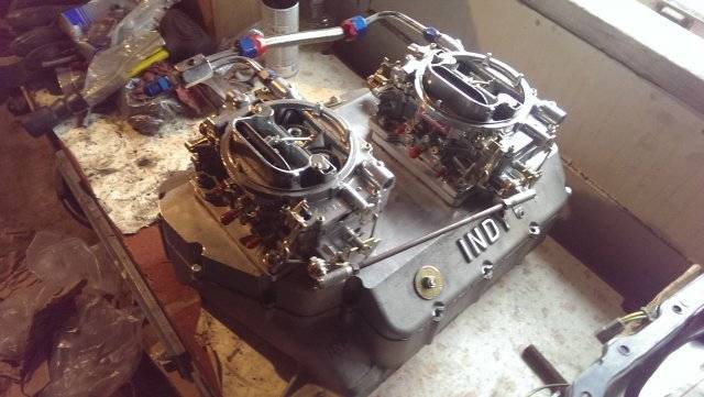

So this showed up today:
I initially received a big box a week ago, all excited like a little kid on Christmas, only to discover to my horror, thatbinwas sent a Chevy 454 cross ram with dual 4 barrels! Tried calling the seller, who I couldn't get a hold of. He ended up calling me Sunday night and called the shipper to pick it up. I checked tracking every few hours til I saw he got it. The the waiting game, would I get it by Saturda? No, but it came today, I feel better, and I can't wait to mock it up on the engine. Who knows when it will actually get put on the car, but who cares, it's awesome to look at all by itself!
6 pack on a Tunnel-Ram.....now that out to make some HP and some torque, whats that goin' on? Big Block Mopar I take it goin' in a Dart, seen the mentioning of 516 heads, so open chamber heads.......... LOVE to see the engine too :p

The intake will be going on a 440, stroked to 500ci, aluminum heads, not sure what cam or compression. It will be a while though.

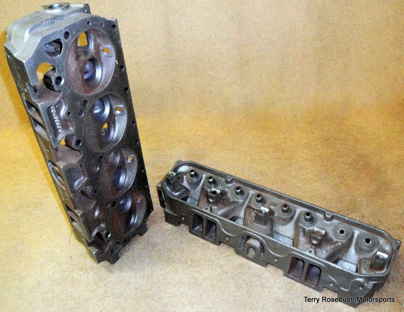

Scott, I thought the 516's are open chamber heads? The 915's I KNOW are closed chamber heads.....
The Mopar OEM "915" heads are closed chambered.... See:
new-915-heads-jpg.51394
The Mopar OEM "516" heads ARE open chambered heads....
See:
Back when I was really into building my 383, I went on a hunt for heads, I wanted to bring the compression up a bit, as its REAL low with those industrial heads, and my Step-Son found a set of big block heads, and I was hoping (at the time they were closed chambered heads and it turns out they're 516's that are open chamber heads)..... To up the compression with a "bolt-on" I need the 915's and those are RARE and sought after for Mopar Big Blocks, BUT I have heard that the 906's flow the best!
IF I had my way to build my 383, I'd LOVE to score a set of the 426 Max-Wedge heads!!!! Those be KILLER on my 383! BIT If I go that route, I'd have to get an intake to fit the B block, AND those special heads (they don't have the same runners the rest do!)
Well shit, I could be wrong. I'm going out to the garage to see what casting number I have. I know I have a set of closed chamber heads, I'll be back in a minute.
And, I was wrong. I have 915 heads out there, along with 2 sets of 452s, a set of 907s?, and a set of 440Source heads.
I haven't looked at the heads for a long time and with all the things I read about engine builds, I got my numbers confused. Thanks for correcting me 67PW!

I might go with these heads when I go with my Indy Max Wege Cross Ram intake. (I've developed an addiction to multiple carbs intakes, especially when they come with carbs and linkage!)
