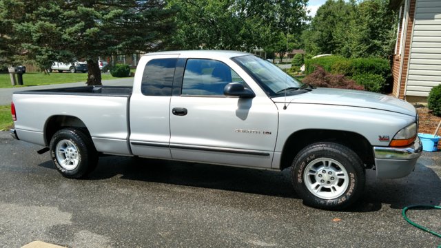

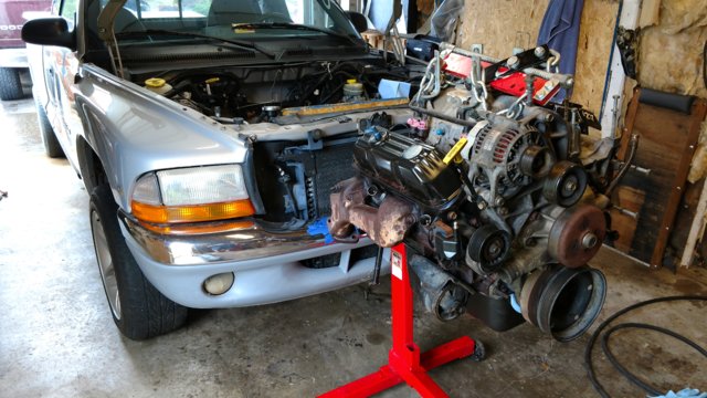

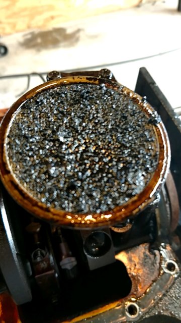

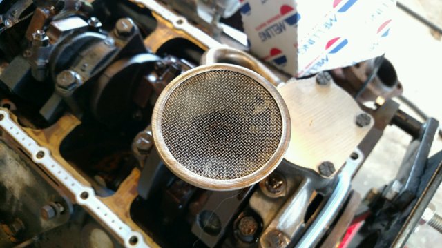

    Landed this 98 a few months back for 500 because the oil pressure dropped to zero after it warmed hp. Body is almost perfect, interior is also. Was going to r&r with a j/y engine but decided to see if I could find the problem when I got it out. As you can see in the pics the strainer doesnt look at all like its supposed to! Cleaned the strainer, new oil pump and gaskets and she runs like a champ! 65psi cold, 35psi hot.

        What was on the strainer? Wonder how that stuff managed to end up just on the strainer. Nice truck just hope that was a long term fix.

        I hate to say it but I think this guy either never did oil changes or used crap oil but he kept the rest of the truck in great shape. Back in my day Quaker State oil would coke up like that, I guess we have wally world oil that may do that in this day and age..?
        I'll have another 3.9 that I know is dead nuts reliable once I yank it from the 93 when it gets its V8 so Im not real worried other than the work involved if it goes belly up. Second, Ive mod'ed a 3.9 to the tune of low 8's in the 1/8th pushing up to 150 shot of n2o though it, Im hear to tell you that they are tough as nails. If you have oil pressure and cylinder pressure it will go forever with decent maintenance.

          back in the day when Chrysler used nylon on the timing gears, the nylon would break off and block the p/u like that.

            had a bud with a engine that was run on reg oil for years . then he started using some new bread syn oil . all the crap in the motor was cut loose and ended up in the bottom of the pan . and plugged up the strainer from the pump , it was to late for that engine when that idiot light came on .
