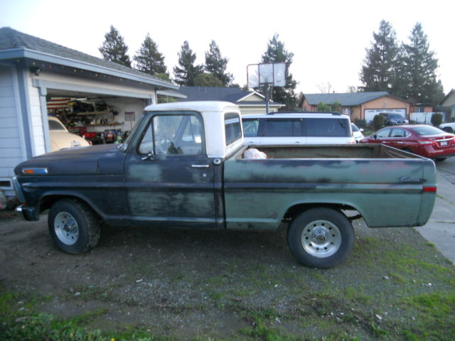

I just traded my 92 Bronco for this little gem. Zero rust, and the body isn't too bad. It has a 351w and a 3 speed.

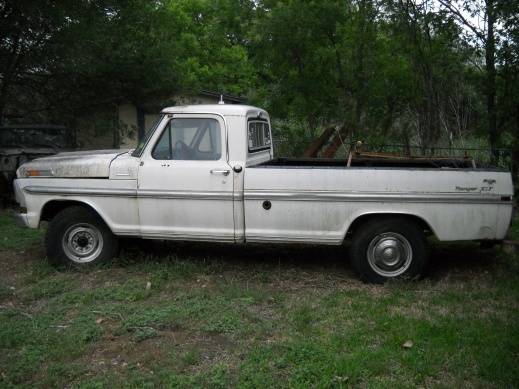

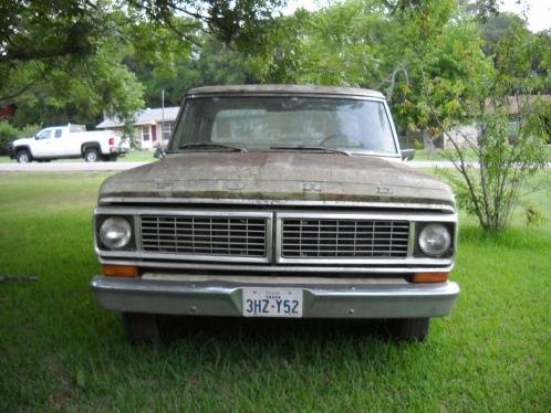

I got a 1970 F250 and 1971 F250,but they have been sitting for years.

For now I'm just fixing all the little stuff. Mostly squeaks, rattles, and other weird noises. I've been driving it everyday for about two weeks now. The Windsor and 3 speed work pretty good with the 3.25's in the rear. My long term plan is to keep it mostly stock and get the body as cherry as I can. Maybe lower it a little and put some wheels on it, but I want to keep it functional as a truck. It has no rust worth talking about and the more I look at it not too many dents either.
Trying to decide what color would look good. Pretty sure it's not going to be the original boxwood green.

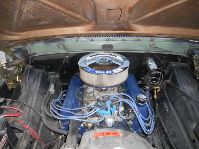

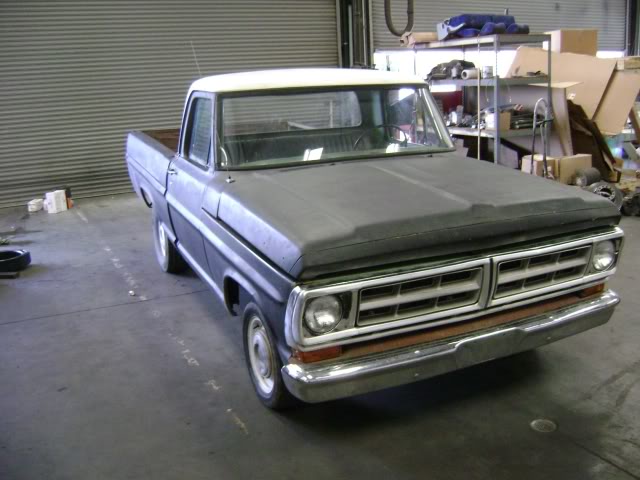

I almost forgot about this place till I saw the post on FBBO. Truck still looks the same, but I put a 460/C6 in it and changed the wheels. I'll try to get pics after work.

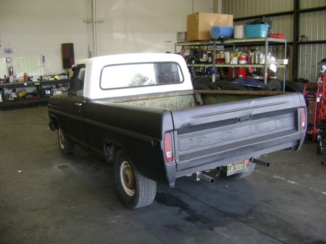

Well I guess it does look a little different. Most of the black primer has washed off.

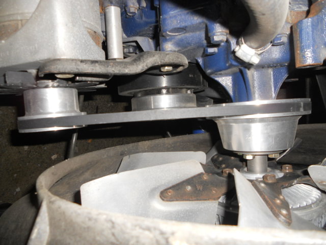

I drive it about half the time and haul stuff with it. It has more torque than the stock chassis can handle buts its fun to drive.

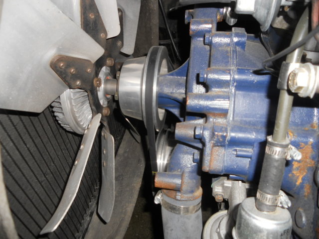

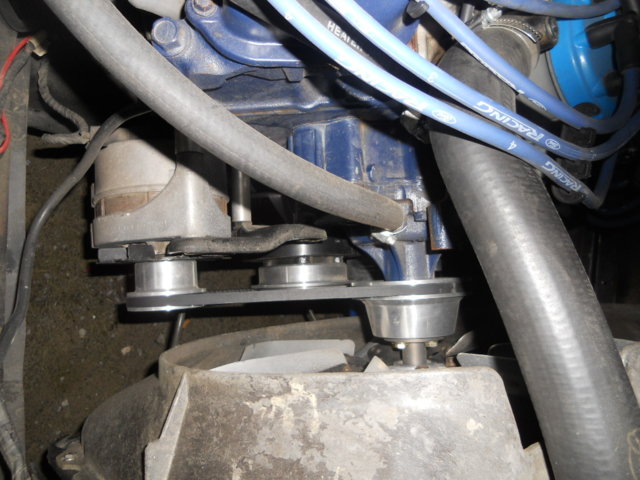

No power steering, one belt. CVF pulleys, HD Ford fan clutch, Chrysler fan. Stock Ford radiator and shroud. Works great.
