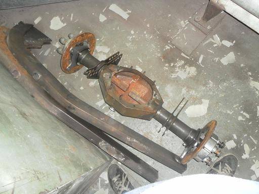

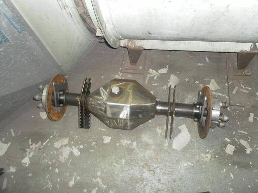

I want to put this in next winter also
Maaaan "RCAddict" ! What are you gunna be runnin for sneaker's ? Maybe something around 16"or17" wide ? That should look wicked !
